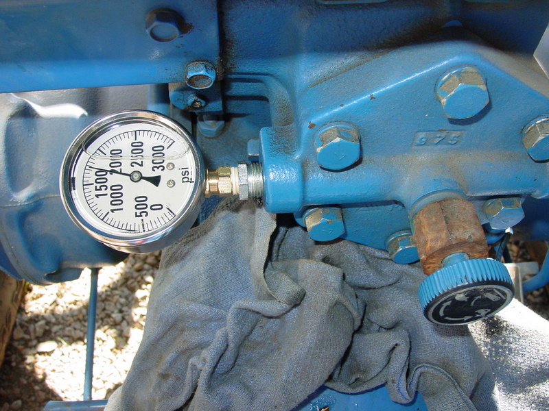

Ok, that's good since your lift piston seal holds. Look at the attached pic,rig up your gauge kike that, start with cold tractor, run it with something on 3 point raised high. Then take a note of pressure with cold engine, as it heats up record the pressure while the 3 point is not manipulated along with the loader bucket off of the ground. Let's just do that to see what you read. it just might be that your hyd pump is old and tired. That's the situation happened to me and then 12 years ago I was able to find overhaul kit and fixed the pump without further damage.
I am not saying your pump is bad yet but trying to sort things out. I am sure you do not have quick connect on the loader to remove the loader hyd circuit. is that correct?

Hyd pump is new, and this is same issue with the old pump, let me ask when you do your adjustments you adjust relief valve psi first then you move the lever to the highest lifting position then you adjust the control valve until the relief valve stops so wouldn't i have o psi then ? With the implement raised i have 500 psi then when you gets hot it is 0 then tries to fluctuate from 0 to 500 psi, yes oil has been changed multiple times and filter cleaned several times also ???

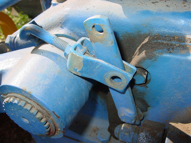

Look at the pics below. Have you ever messes and adjusted the feed back link from lift arm to spool valve?
Your hyd system is open center, meaning you have full flow thru your pump all the time as long as engine is on. You would have flow and pressure to raise your hyd lift sytem. Once you achieve the desired lift then the feed back arm moves the spool to bypass and all unused fluid gets back to differential and to pump section and this thing happens continuously without stop. The pressure adjustment comes before spool valve. The spring tension on the relief can be adjusted up and down and that what sets pump pressure. This has nothing to do with the position of lift arm. Your system pressure should be around 2200 psi or so and I set mine at 2000 as that is enough for me to lift my implement. if the tractor is running and your pressure where I showed the gauge is 500 psi then your relief is not set right. You adjust the pressure by adjusting the spring pressure tight just short of 2200 psi gauge reading, more than that the poppet valve would chatter and dumps the oil back to the diffy.
Is 500 psi with the engine off and implement hanging ? the weight if implement against the oil in the cylinder will cause some static pressure reading with the engine off. Do you have a loader circuit? I am thinking you might be diverting flow somehow constantly back to diffy. is there any after market hyd equipment there ? and so , how is it plumbed?
Bottom line, with engine on, no matter where any control valve position is the pressure reading should be around 2000 psi. See if you can elaborate your questions bit better.

Yes thats what I was saying I have adjusted the link , and when you adjust it should it read 2000 psi , the adjustment is confusing it said after adjusting you turn the link 1 more time then connect it and when I do that I have 500 psi, I have seen these pics before and my adjustment is very similar to the pics.
