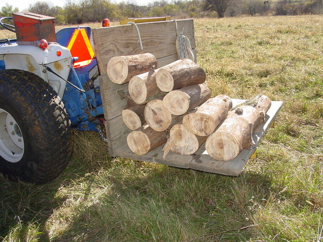

Ford 1700 is one heck of a tractor, perfect in tight spaces. It is my to go tractor except when I need loader work and picking up very heavy stuff. Easy to maintain. Mine was one owner and well kept. I have it for 20 years now and it is the best $3200 I ever spent. I made the boom out of some demoed SCH 40 pipes after one of my projects

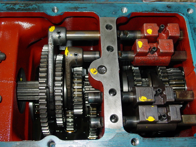

In general, you have forward and reverse in manual shift transmission. Mainly on older vintages gears are not synchronized meaning you have to come to full stop clutch and change. There is no mechanical synchronizers to avoid grinding meshing gears. Some might say they can feel the engine rpm, let go of accelerator pedal and shift on the fly which is doable but not at all recommended. If you have 2 ranges and 4 forward speed then you have 2x4=8 forward speed and reverse speed mainly corresponds with # of ranges. in essence range 1 , gear 1 affords you the slowest but most grunt or torque. Range 2 , gear 4 would afford you speed of 8, basically fastest for road travel but not suitable for bumpy farm land. Tractors are low geared so they have much torque. I like to do it nice and easy so range 2x gear 3 affords me a very comfortable and controllable speed. in HST transmission you can get more grunt with low range and low speed (turtle ) just the same. Below is the pic of non-synchronized transmission. On my Kubota 3rd and 4th gears are synchronized so on the fly I can clutch and up shift and downshift without damaging anything. I regulate my speed mainly just stetting the rpm to what I want , say 1200 and just play with gas pedal for the speed i feel comfortable. if I am brush hogging big field then I go 3x3 and go to town going forward in circles or square without changing my direction (direction hear means forward or reverse only), turning right of left is not direction change. Below is innards of my non synchronized Ford 1700 transmission.
