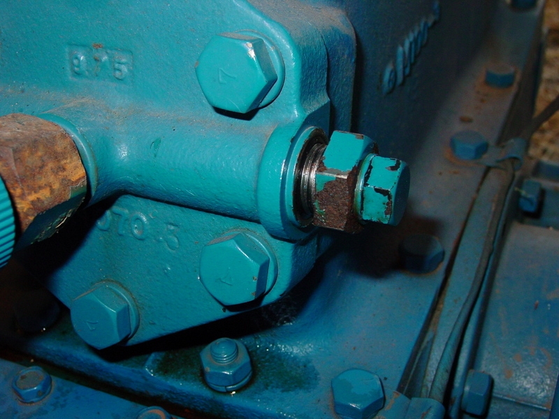

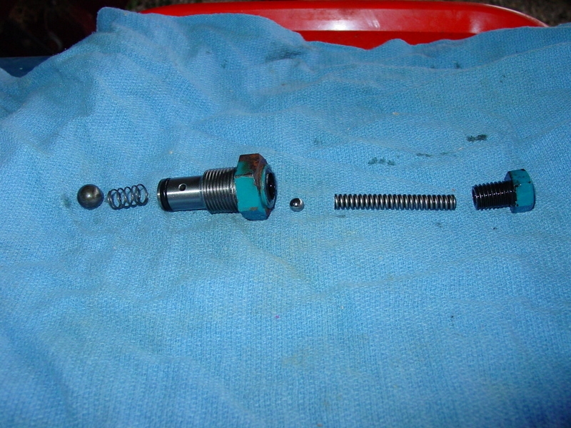

Dave,
there is a spring and ball that acts as a check valve for the 3 point. Look the pics below. Take the plug out and inspect. while open , get a bucket under it ( a helper would be good), run the tractor, move the 3 point lever up and down. I am hoping it has a kidney stone , lol or something there that it could pass. Make sure to put it back in the same order. Put the plug back and try. The issue might be return path at the spool. spool valve is the last thing you want to dork with. Let us know.

I removed the check balls and springs, and fired the tractor up. I operated the lift handle and it spewed oil into a bucket I had waiting. Then I went to get the parts to put them back together, and the smaller spring was missing. Luckily I hadn't stepped on it! No change to lift arms with this change. Someone had been in there before, because they weren't tight.
I wonder if the relief/diverter valve has been messed with, and it possible that it has any affect on the lift arms?
