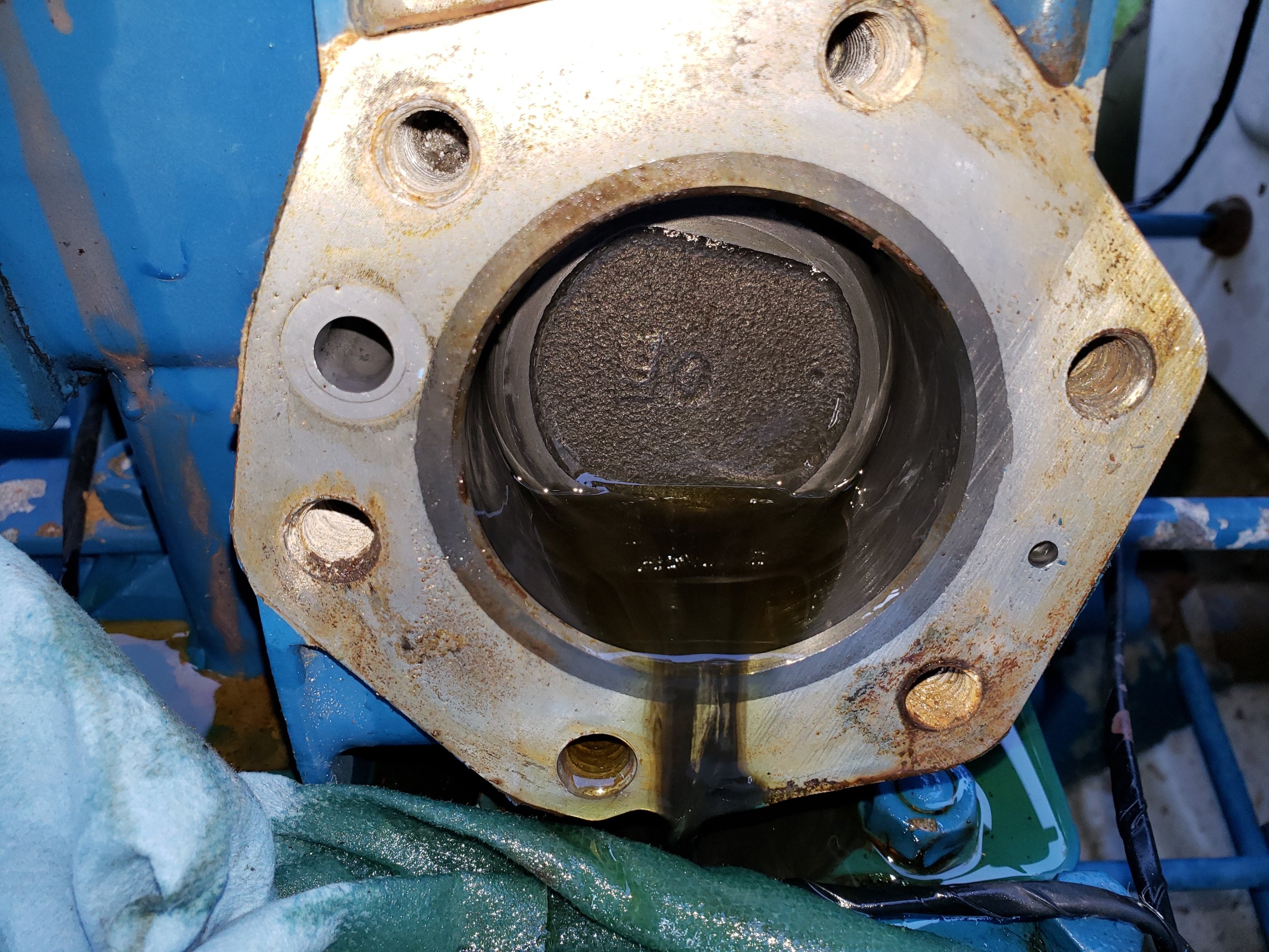

Well, crank tractor up, raise lever and hydraulic fluid sprays out the right side hole. Piston is all the way down in bore, and lift arms are up, STILL! Seems like I might have a mechanical issue!
David from jax

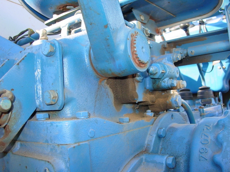

Harry, Welcome to my party! I had previously sprayed Kroll on that cross shaft, and did it again after I got the head off.
I got the grapple on the M7040 and set it on a pipe suspended by a chain on 3pt. Weight wouldn't do anything, so I curled the grapple down and it moved! Backed off, checked piston, it had moved, so I stood on the lift arms and it went the rest of the way down.
Now to put it back together and see what kind of damage I did forcing the piston.
Things may be better now, but at least I know where the problem is!
THANKS EVERYONE!

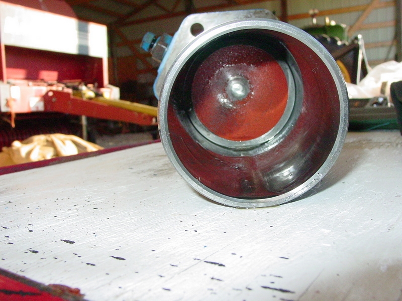

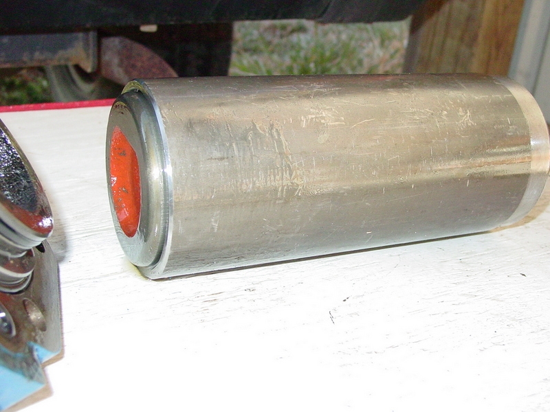

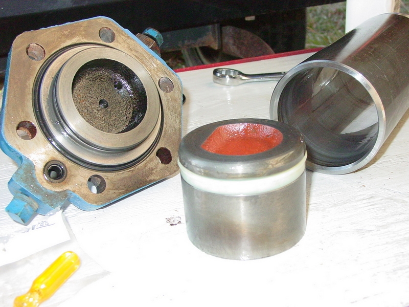

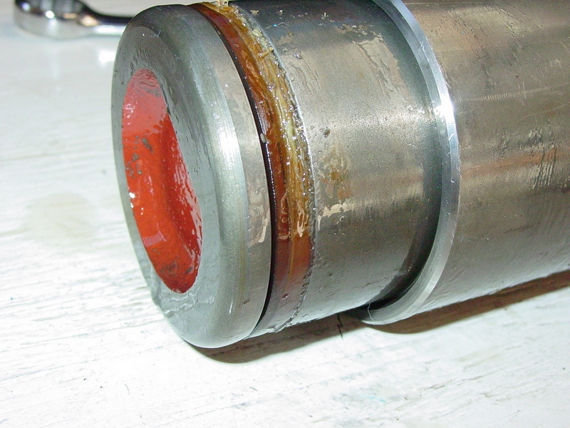

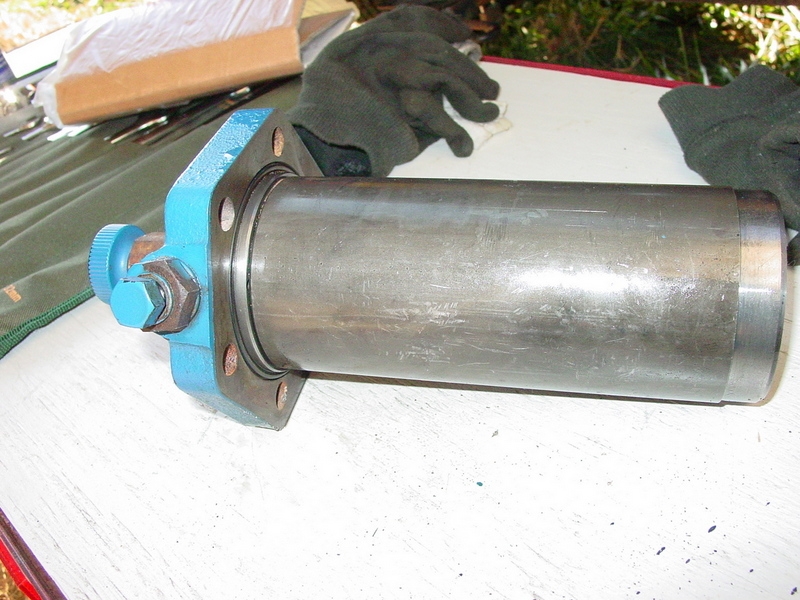

David this is mechanical bind of some sort. In y9ur picture I could not see the removable piston sleeve like the pics below. Were you able to take the piston out? I wonder if the ram rod is bound up against something internally or damaged. Need to see behind the piston. Below is the geometry of all 1000 series I have seen. I might go to NH website to see if you have sleeve or not for the lift piston.
Lift cylinder with cylinder head sleeve. There is an o-ring that seals the cylinder against the head.
Bad seal that was leaking
new seal:
Back of cylinder where ram rod rest against the concave depression in the piston.
