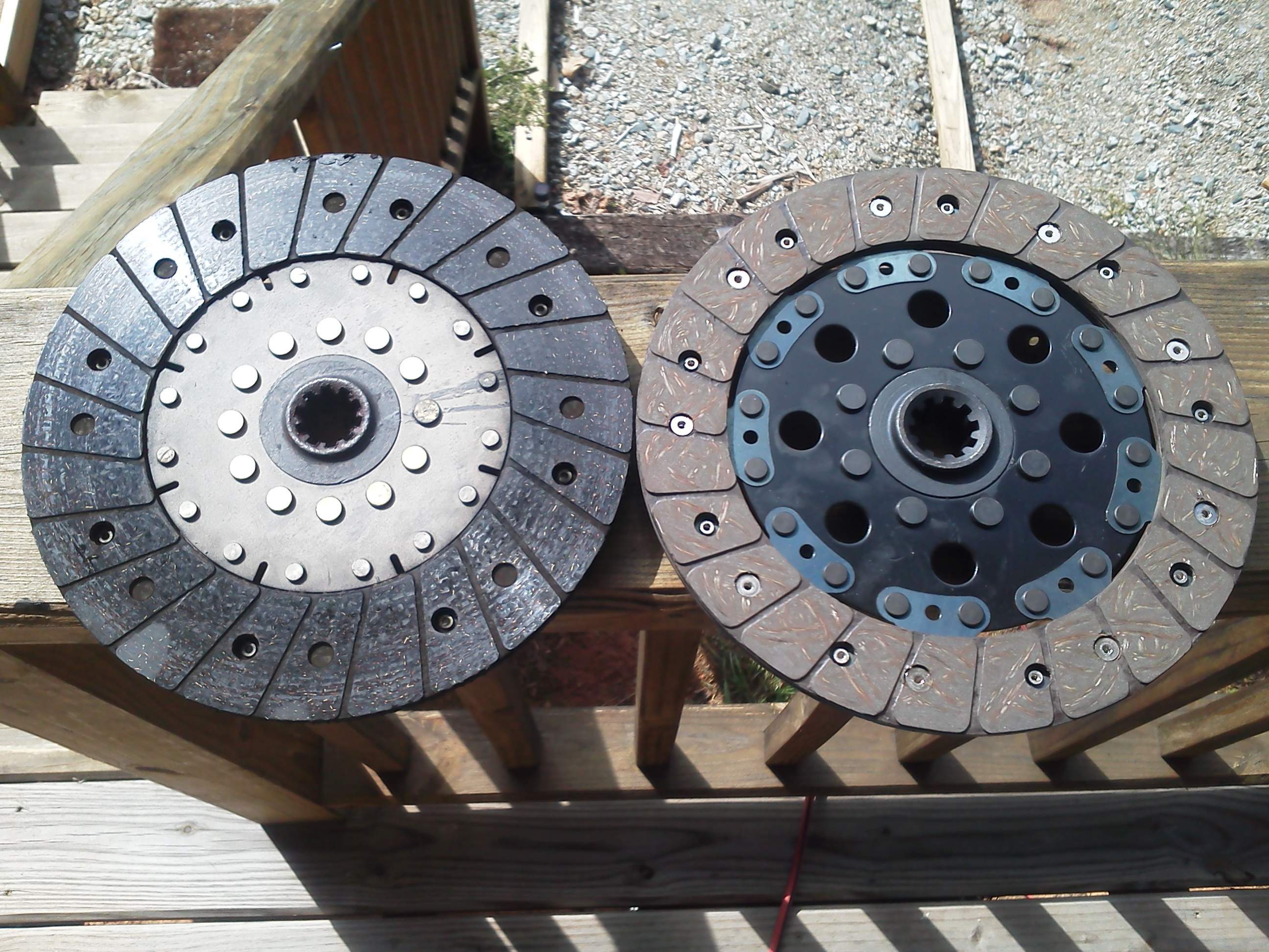

Well, ran into my first big snag. The clutch kit I ordered came with the wrong parts included. Hopefully they can resolve this and get me the right parts. Looks like it'll be another couple weeks before I can get this thing back together.

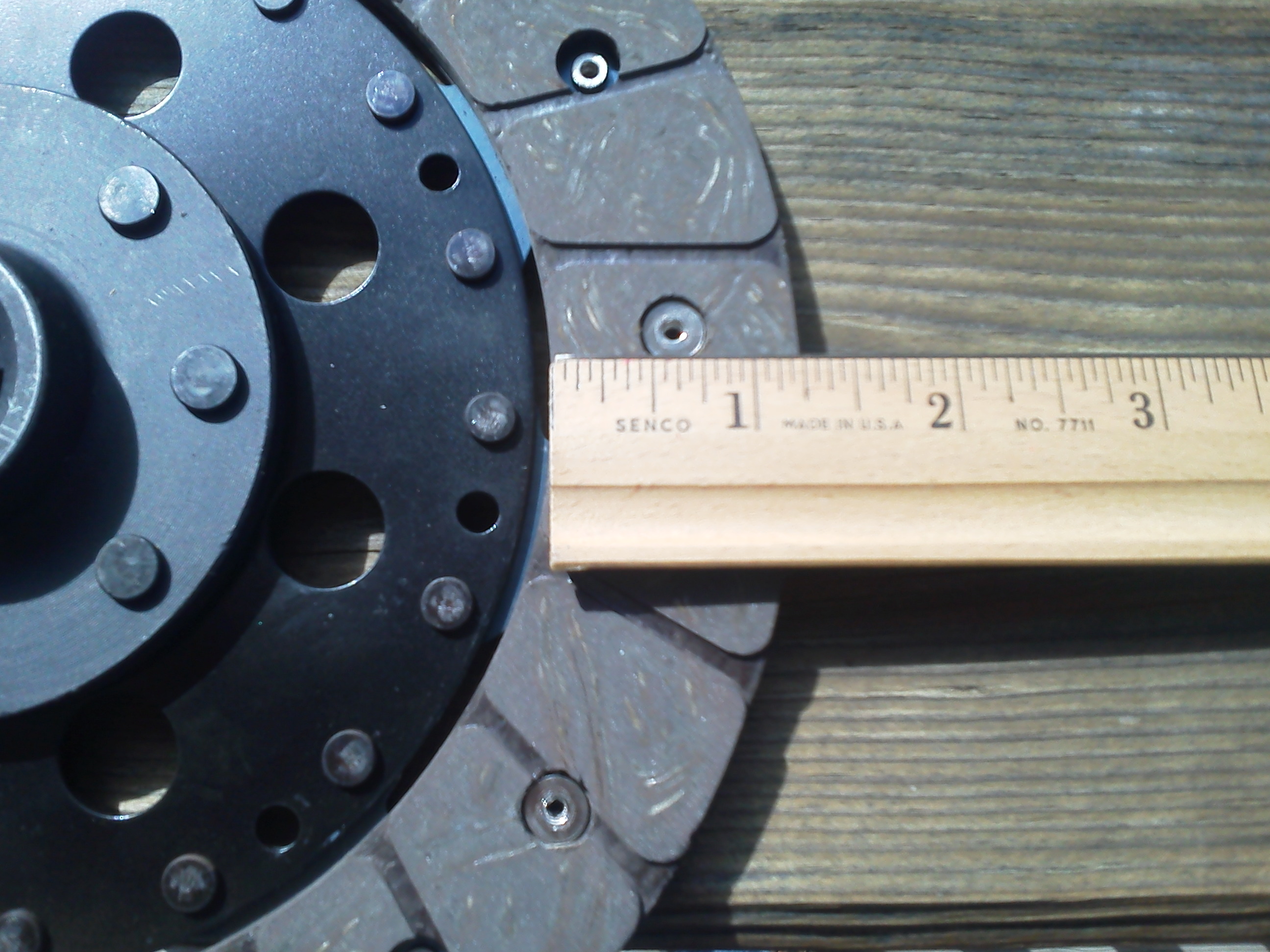

Also, they are telling me that the clutch disk will operate the same even with the reduced friction area, doesn't sound right to me. Any thoughts on how much this will effect holding power?

We've run into a lot of new ones where the friction material is smaller. I assume a differnt material. Should be a sheet in the clutch kit that explains it. Overall we've had no issues with them holding, just make sure its the right one for your application obviously. If its right for your application then its just one more reason to resurface the flywheel, the clutch disk wont be riding in the same area as the old style plate.
On the flywheel resurface- You're talking 40$ to resurface a flywheel from a local engine builder, I dont see any good reason NOT to resurface it. I guess being this is my job I tend to do it the right way the first time, because the second time we are losing money. Its the same for new/ resurfaced rotors when installing new pads. I just dont like putting new pads on an old uneven rotor even when the customer doesnt want to resurface them for 15$ a pop. Doing it right the first time is just in my routine, but if you dont have the 40$ to resurface thats fine.

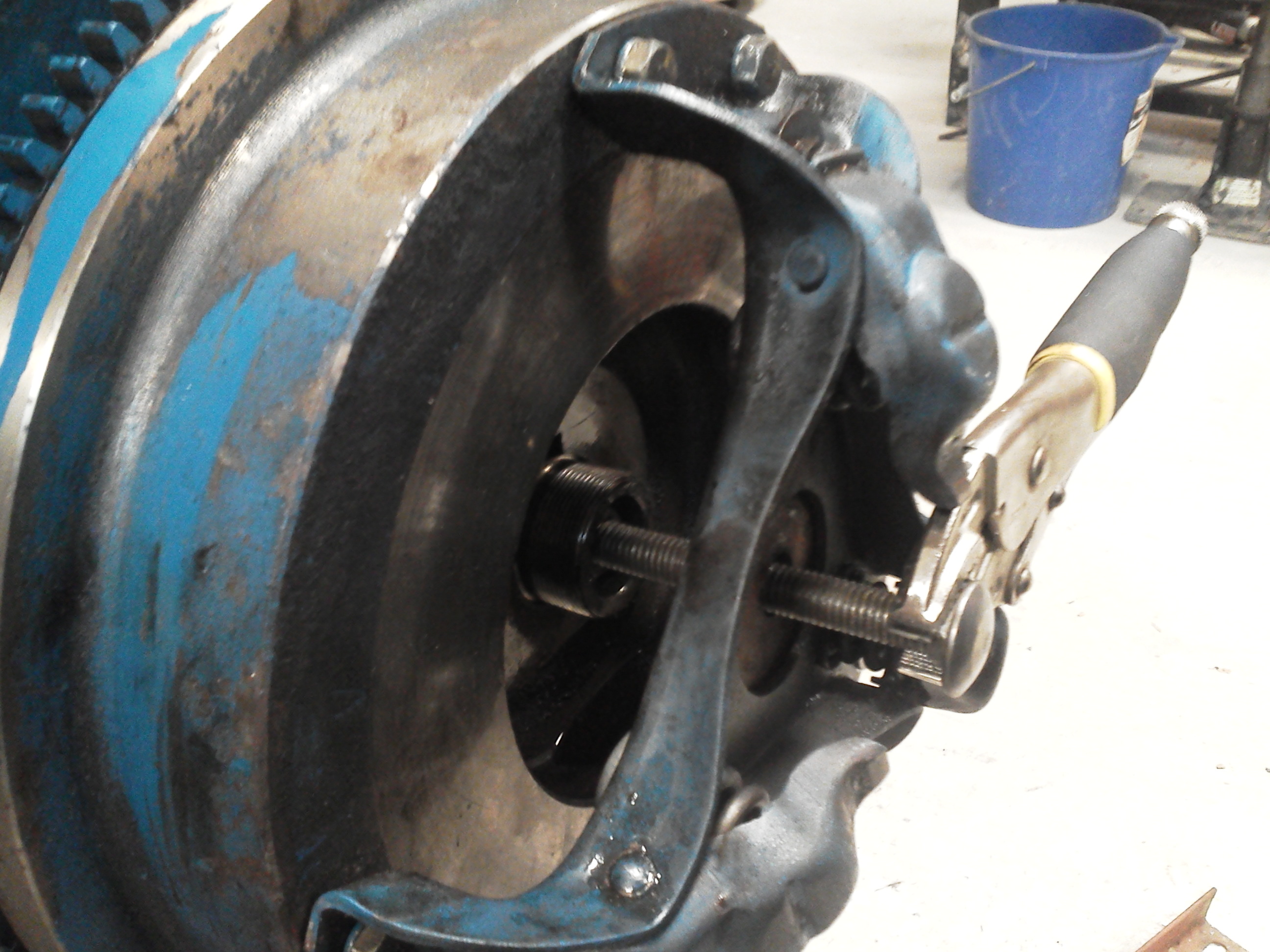

So it took me longer to get back to this project than expected but once again I think I have gotten myself beyond the tools I have availible to me. I was able to remove the flywheel nut but am unable to remove the actual flywheel. I bolted angle iron across the flywheel and tried to tap it off from alternating sides but am a bit weary that ill damage the bottom end bearings if I get too forceful. My current rig is that I modified the old pressure plate to act as a puller and am alternating with penetrating lube and propane torches under tension to get it loose. Am I missing something or should I continue this procedure and hope for the best.
