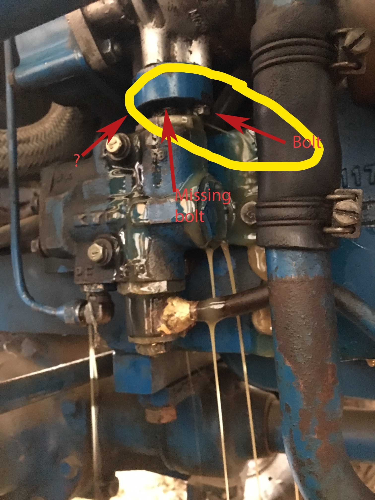

There should be bolt for each arrow. I only see one in the picture. Hopefully this helps.

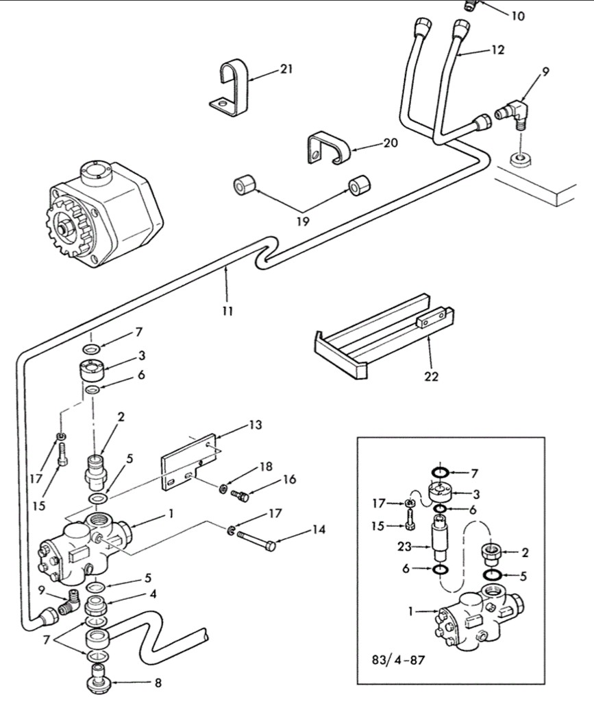

So I think you need to look up a 1710 on Messicks, because I didn't see the diverter under the 1510 schematics.
According to the picture, #7 and #6 are O-rings. #3 is an adapter that goes onto the pump, and the #2 slips inside of that. It looks like it is a slip joint design for tolerance stack up i'm sure. The #15 bolt only shows QT 1 which is odd. My guess your #6 o-ring is leaking. But while in there, replace them all.
#6 O-RING,2.4mm Thk x 9.8mm ID
#7 O-RING,2.4mm Thk x 19.8mm ID, 90 Duro
I double, and tripple, checked. There is no bolt on that side. There are the 2 you can see in the photo and one on the backside for a total of 3. However there is no hole on the front side for a fourth bolt.
   / Ford 1510 Hydraulic Pump Leak Help #15
Just about all these 1000 series Ford's have a 3 bolt flange on the pumps. My 1600 and 1700 were the same way.
   / Ford 1510 Hydraulic Pump Leak Help #16
Most of the flanges like that I have seen have three bolts. Looking at the shape of the pump and when I zoomed in, it appears as if a bolt is missing. I am glad you figured it out and will get it going again soon. :thumbsup:
