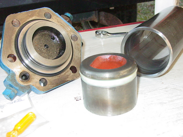

JC I noticed in one of your earlier posts that you had pictures of the lift cylinder and piston when you replaced the seal. My question is when you take the 6 bolts off the piston housing does the cylinder and piston assembly come out with the housing? I have a shop manual but it does not go into detail about this. Also what is necessary to do to seperate the piston and how big a job is it to replace the assembly into the tractor after the seal is replaced. I figure since you have done this procedure you probably can pass along the do's and don'ts to get the job completed correctly. Ray

The whole assembly comes out as whole. cylinder and head comes apart by a little force, they are oringed together if there is a term like that. Make sure the orientation of seal lip. it is a one time try ,can not take the seal off without damaging it. Also be careful with piston orientation and the ram rod that rotate the rock shaft.

JC or Anyone else, I found the piston seal cracked and am now replacing it. Is there any special way to put the seal into the piston? Does it have to be warmen up, oiled or do I just stretch it over the piston? There must be a trick to it. I am a first time replacer. I need all the help I can get although if it streatches it looks easy enough. I don't want to ruin it and have to reorder. Ray
   / Ford 1700 3 pt lift problem #14
Hey Ray, I just replaced mine a few days ago. It is a tight fitting seal. It was tough to get it to go over the piston because the seal didnt stretch much if any. I shot some wd40 on mine and I suppose it helped some. I did it by hand without the use of a pry tool and eventually got it to go over the piston. The slicker it gets I imagine the tougher its going to be getting a grip on it to stretch it over but it will go. I wouldnt suggest using any pry tools on it as you may cut it or damage the seal in another way. Also as JC has shown, make sure you have the lip of the seal in the right direction. I think his pictures show the flared side of the seal should face the red end of the piston (the top). Look in those other posts about hydraulics and you will see some really nice pics from JC. Good luck! Tex

Hey Ray, here is a pic of a new seal on the piston....

Tex, Thanks for the help. I got it on by using mobil 1 and some good old elbo grease. ;) Put it back togather and it works. Ray
