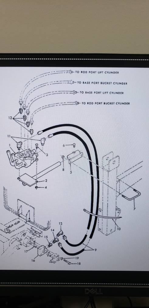

Where do your hydraulic lines for the joystick come from? Mine come from 2 ports under the seat on my 1700. Saw a pic that looked diff. My loader is very week and am going to put a new joystick in. Curious if mines plumbed wrong.
   / Ford 1700 auxiliary hydraulics
#12

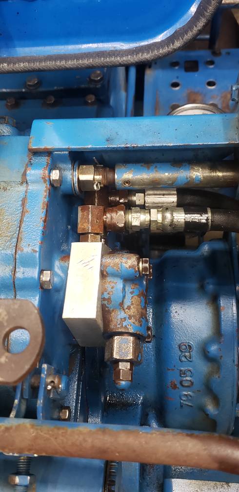

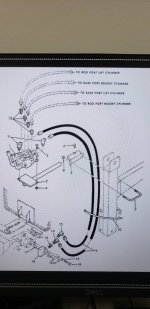

The lines come from an aluminium block under the seat (right side). Post #5 on page 1 of this thread has a picture of the block.
When was the last time the screen was cleaned? I've had to clean the screen on mine twice since 2011, symptoms were slow/weak hydraulics.
Both times the screen was clogged up with a thick slimy film.
   / Ford 1700 auxiliary hydraulics #13
