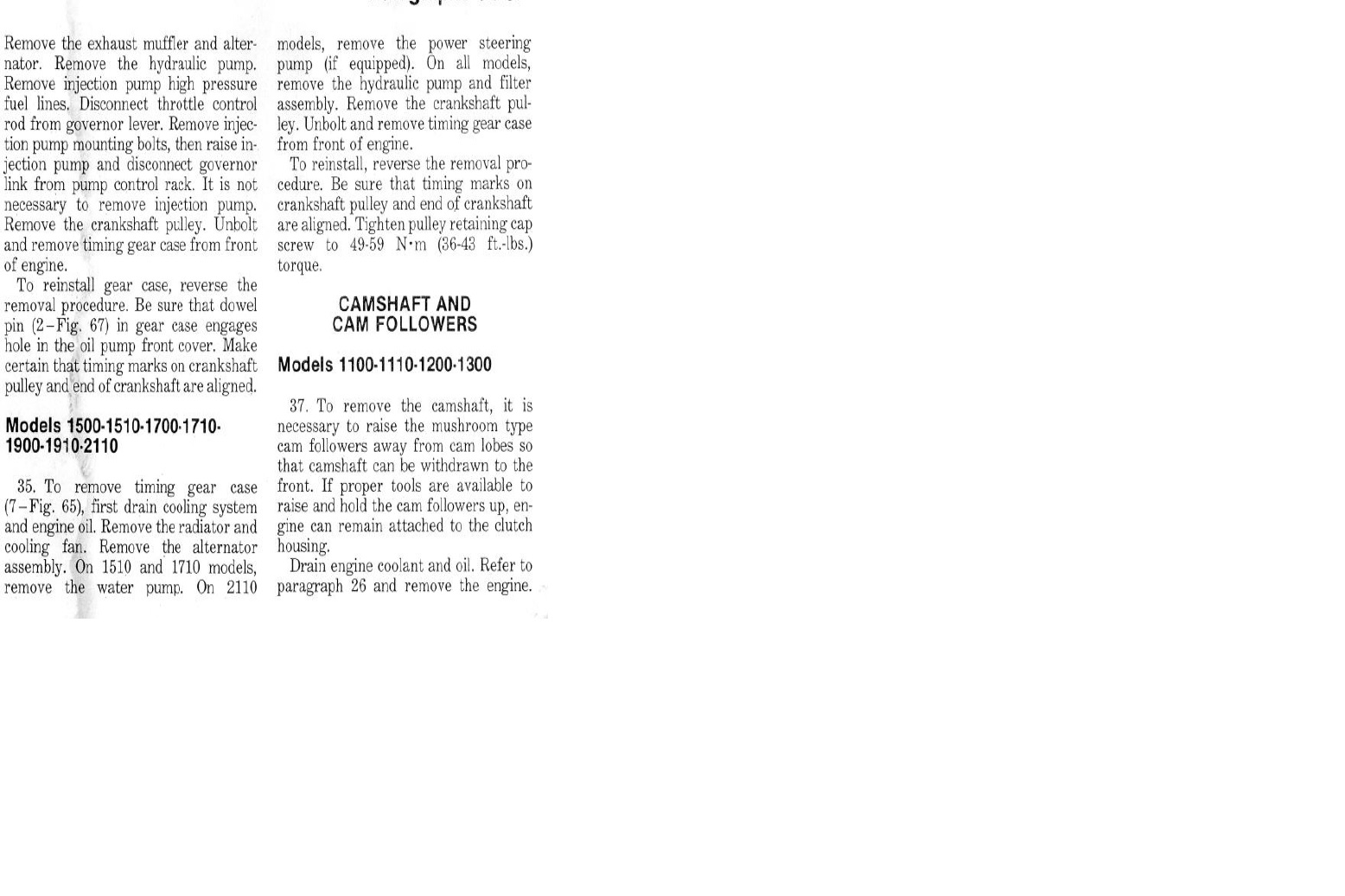

I've got a Ford 1700 with a 2 cylinder diesel, firing order 2-1, with 2 marks on the pulley, the first for injection timing, the second for TDC (information all gleaned from this site, thanks for that).
While running the FEL I stripped the splines out of this pulley completely, as it drives the hydraulic pump. My first observation was a strange vibration, the second was screaming when I tried to raise the loader to dump it. After much research I realized that this is also a balance pulley for the crankshaft and is twice as thick on half of it, hence the vibration fully explained. I was surprised to learn this 2 cylinder runs 180 degrees opposite of each other and I wouldn't just install the heavy end opposite of TDC for the 2 cylinders, but they're opposed. I was more surprised to learn there is no obvious indexing on the crankshaft or pulley that I can tell, or in the splines. My pulley is all wallowed out, and the new salvage one ($289 off a popular online auction site) arrives in 2 days so I'll be able to inspect it more closely for index markings. So all I can tell thus far is its 38 splines with no keying, so about 10 degrees/spline.
As I need this tractor back in service immediately to finish bed lifting 1,600 ft. of fall crops, I'm looking to know exactly how to get this back together right the first time when the part arrives. Which is why I couldn't spend days waiting on salvage yards to return my calls vs. one boxed up and ready to ship immediately.
I believe the correct way to reinstall the replacement will be to find TDC of the #1 cylinder/front most cylinder, not #2 based on firing order, and align the second timing mark on the pulley to this position. I'll probably try to peek through oil fill at the valves to find #1 TDC between the compression/power stroke, being +/- 10 degrees/spline should make alignment this way sufficient. Or I'll have to pull the valve cover to see better, but hopefully not have to disassemble any further than that.
Does anyone have any better ideas, methods, or knowledge on how to do this? Maybe something easier with the injector to align to the first mark? Getting it wrong may lead to a small vibration, or fatigue stress the crankshaft eventually, and will definitely make future injector service extremely painful.

I had a similar issue, but the pulley does not run the hydraulic pump. It runs the alternator and water pump. They hydraulic pump is ran off the gears inside the front engine cover.
The front of the crankshaft should have a dot, or punch mark. There is a similar mark on the pulley. It has been years since I did mine, but that is how I remember it. I can check my manuals.
   / Ford 1700 crankshaft pulley position alignment procedure #3
From the I & T manual. If you don't have the manual, I suggest you get it. They are a condensed version of the service manual. You can usually get them at Tractor Supply or Farm and Fleet stores. Cheap.

Thanks Mike. I figured there had to be something. My pulley is ground out so there's nothing to see there, hopefully new one is obvious. I inspected the end of the crankshaft and couldn't see anything. Maybe some steel wool/light sanding/pencil rubbing with a piece of paper will reveal something there. Unfortunately this end of the shaft did the material removal on the pulley, so hopefully its much harder and still visible. Just went to check for it, but now the loader is settled too low and I can't get the hood open enough. Grrr.. May have to wait until later tonight, but I'll be checking for that crank mark ASAP.

I was able to get a hand in there with some steel wool - got a lot of high carbon caked iron powder out, I guess from the pulley casting debris. And am now able to feel a divot! Thank goodness, I was really worried about how to index that 38 spline back on quickly and properly. Again, thanks!
