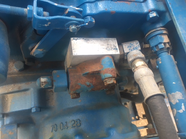

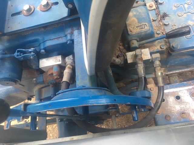

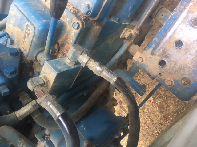

Here's 3 pics, far right one shows the overall, with the adapter block on transmission housing like what is seen in all the FEL manuals, and the power steering priority valve which I haven't seen this style anywhere, connected with 2 hoses. The other is a closeup of each. Note that the priority valve (center pic) is not plumbed to anything, just bolted in that location obstructing easy access to my differential lock. The top and right hoses go to the adapter block at transmission, the left hose goes to the power steering spool which is a hydraulic ram mounted on the side. I'll go get a pic of that now as well.

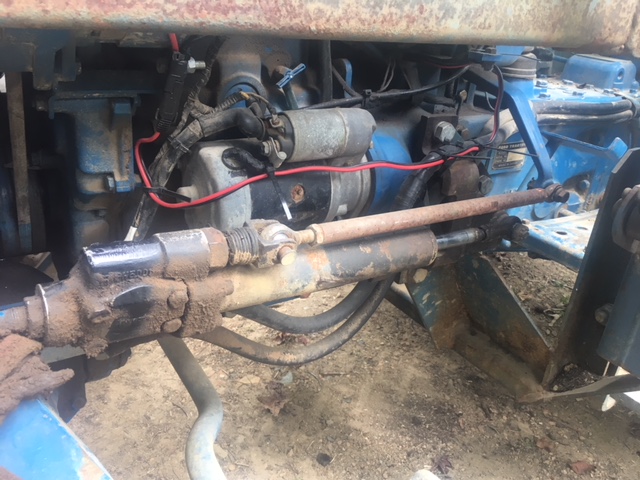

Here's a pic of the business end of the power steering option I have. Very simple, pitman pushes spool valve mounted on hydraulic cylinder. If no hydraulics, you're back to armstrong power steering and dragging that hydraulic cylinder to boot. With pressure, obviously you're steering with your pinky. 2 hoses, one returns to atmosphere/transmission housing. The other comes off that priority valve in previous post.

That front block looks like a pressure relief for the steering. They usually run a lower PSI. It looks like maybe an aftermarket or dealer power steering system? Not sure what you can do. You could pipe it so it goes to the loader first, then to the PS block, but you will loose PS when using the loader. That is what a priority valve does, makes the steering a priority, but I don't think you have that, or can't verify since that block probably doesn't have a part number on it.
Maybe just figure out your pulley issue and be done.

I did discover, through looking at the material you just sent and feeling around on what I've got, a large bolt head on the bottom of that block. I'm 90% certain it is a priority valve and that's the spring relief/diverter pressure control in the other drawings of those other styles. I think I could add the FEL at the high pressure return side of that priority valve, and after reading how the ones work that you sent, it should maintain steering priority at low RPM's, and provide surplus at higher RPM's to run both, which is what I'd be doing if running the FEL a lot.
