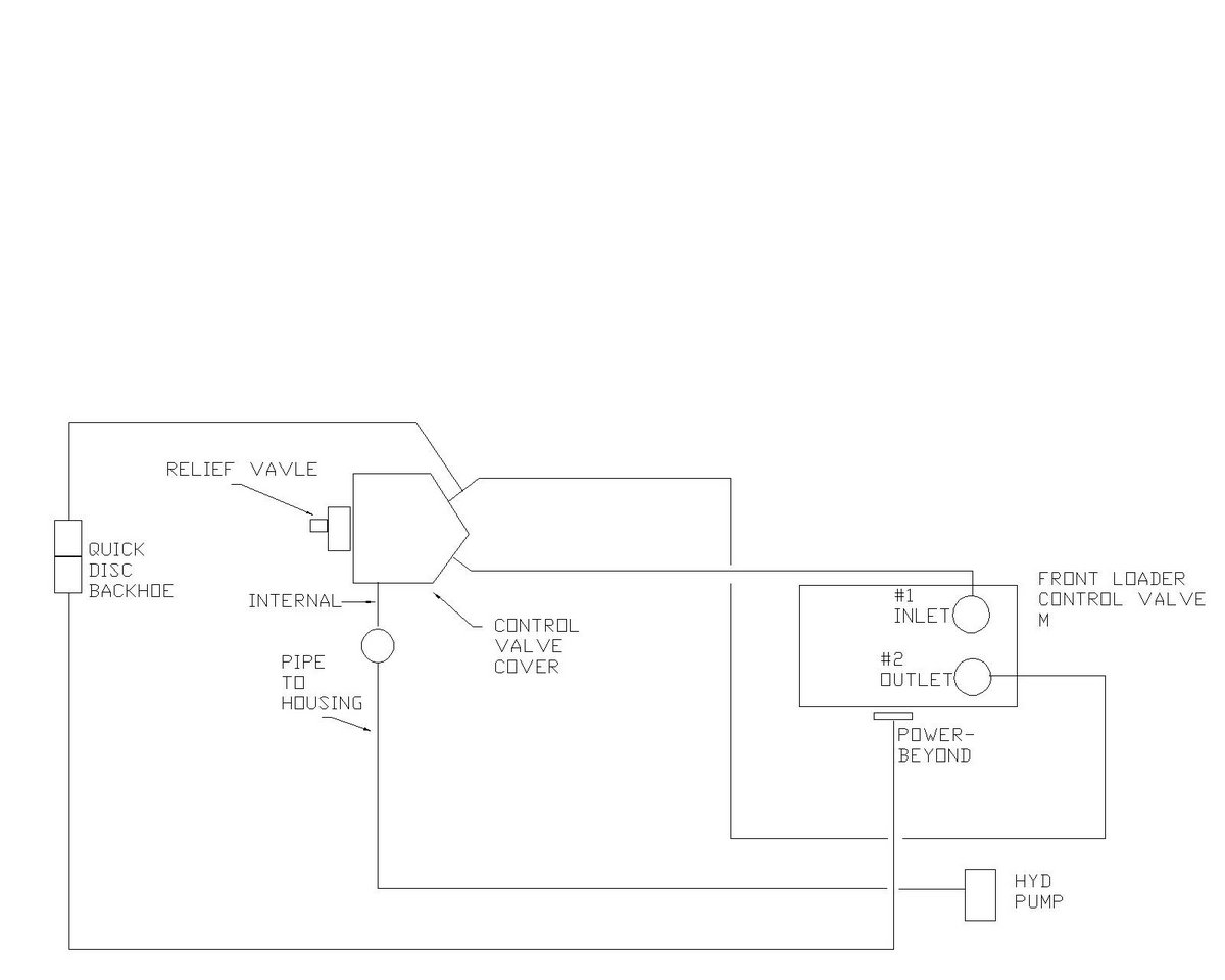

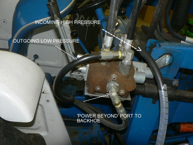

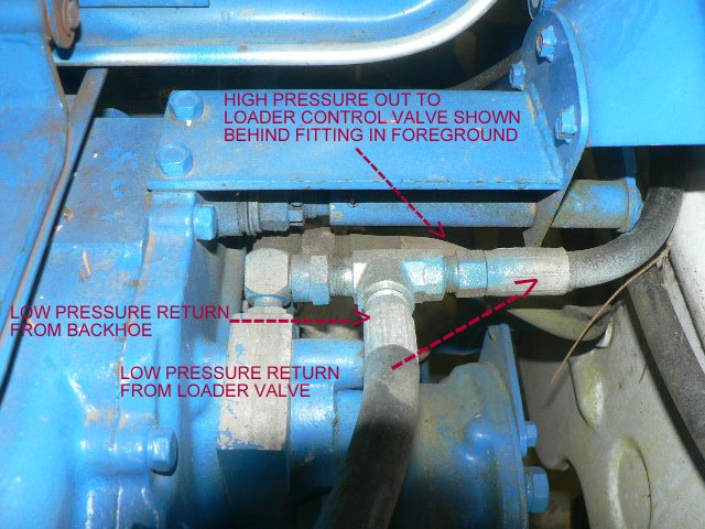

I don't know much about hydraulics, but here is my as-built description of the system. Please correct any incorrect terms I may use. Somehow I think my term 'low pressure return" is inaccurate, but I've attempted to document as best I can.
As I show in the photos, it appears to:
1. Leave a high pressure port to the loader valve from under the driver's seat, then returns from the valve to the fitting as noted in the photo.
2. Off of the loader valve, I had installed a 'Power beyond fitting', and this goes to the backhoe, and from there returning to the same return fitting as stated under item 1.

Thanks for suggesting I go step by step on this. I need to study this more, because when I look at the attached layout of my system, and if the power beyond is simply passing high pressure fluid through the loader valve, it would seem the fluid is going directly back to the tranny, which isn't pressurized. It would appear that the system would be unable to maintain any pressure in the lines as there would be no back pressure if it were as I describe, so I'm missing something.
EDIT: I think I see now. There is little pressure in the system when action is not being called for by the operator. When he actuates a device, it blocks off the return path to the tranny building pressure, and directs it to a cylinder to do work. When he lets go of the control lever, the pressure again drops and just flows in a loop, unless you're stupid enough to disconnect the quick connect which is part of the return. Am I looking at this correctly?
So If I'm understanding your logic, you want to rule out that the pressure relief valve actuated due to the backhoe quick disconnect coming apart, but then the pressure relief valve failed to reseat?
I said zero pressure, but there is enough for the loader to lift after holding the loader valve lever for a bit. Does that remove the need for the test stated next?
So you want me to remove the nut and valve underneath at the location of the arrow in the attached photo, right? Then start the tractor and see if I have flow? I will check the level, and try this when it won't bother the neighbors later this morning, and post back.

JC: YOU SIR ARE A SAVIOR!!
I checked the fluid level and it was fine.
Connected a 0- 140 PSI pressure gauge and ran it- had zero PSI as I stated earlier.
Pulled out the pressure relief valve component, and started the tractor for 6 seconds, as fluid went all over. NOTE: I'm glad I had put down plastic sheeting for this test just in case.
Reassembled the valve. At first I started the valve back into place, but was concerned the poppet might fall off the spring into which it fits. So I took it out and put some grease on it to secure it in place while screwing it in.
Started the tractor- operated perfectly.
I then performed the pressure test per the manual, and had 1900 PSI, and adjusted the pressure relief valve to 2100 per the Ford manual value of 2133 +/- 71 PSI. So I'm assuming the poppet valve was stuck out of position as you surmised. Still would have thought would have had some pressure, not zero, but that wasn't the case.
Q1. My 'EDIT' statement above is incorrect, right? What approx. pressure would I see if I put the gauge at the return fitting at the tranny/control valve? Would it be near zero or?
Q2. For the system I drew above, a properly operating pressure relief valve will protect the hyd. pump from people like me, right?
