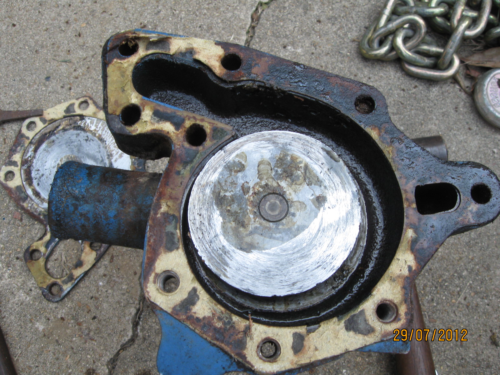

I was able to include the picture. This is the back of the water pump opened up. Shaft is bent. I doubt that this pump would be easily rebuildable.IMG_1209.JPGIMG_1210.JPG. The other 2 photos are of the nut that won't snug up on the injector pump mount. Do you have any part numbers for radiator hoses that will fit this tractor. Thanks, Jerel
   / Ford 1700 fan pulley #13
JC,
I have pulled the water pump and ordered a replacement. View attachment 277058
I'm trying to attach photos. I may need some help with including photos if I can't figure it out.
Cool, you did it just fine. I can see the impeller not centered probably due the seal damage and the wobble caused by it. will you verify if if there is a bearing in front of the seal or just a bushing. For posting pictures you have two options there:

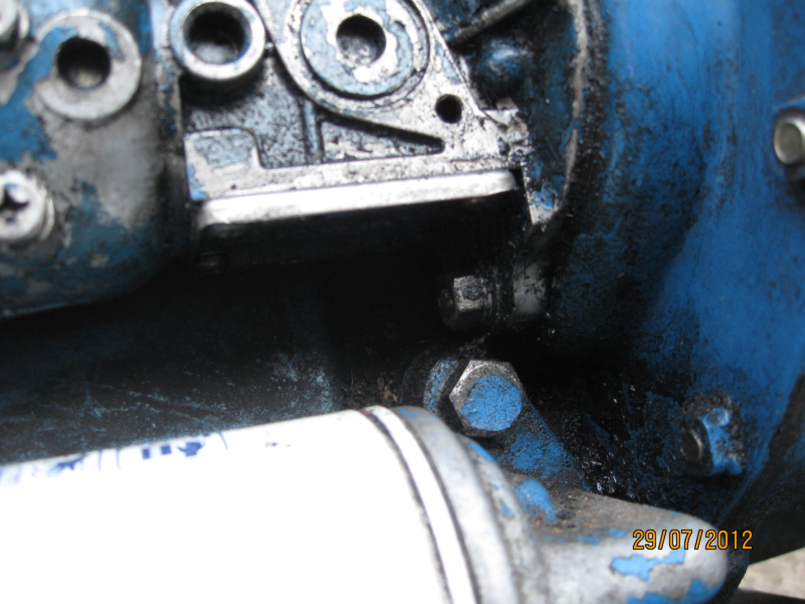

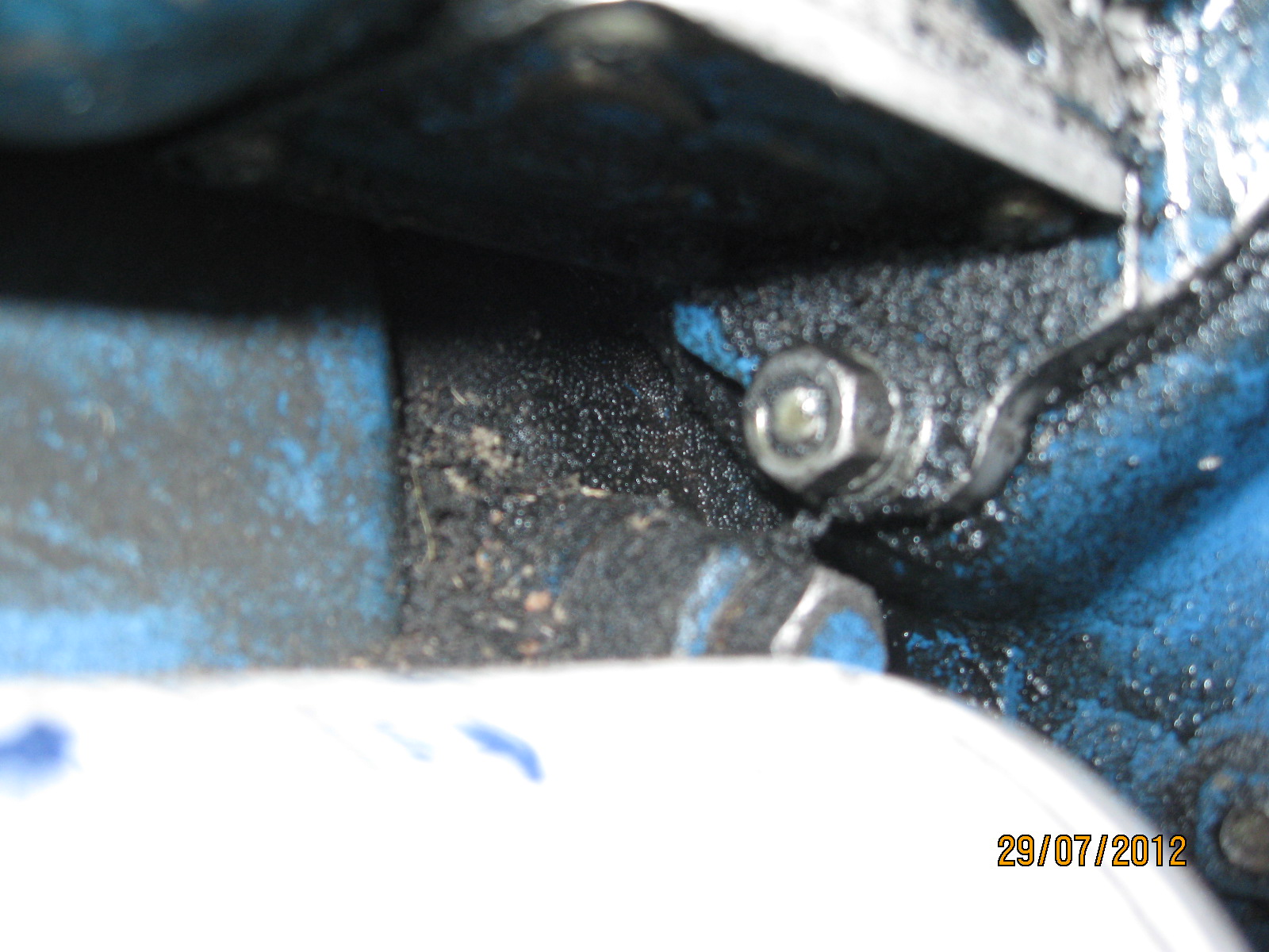

Thanks for the parts info. I'll try to remove the pulley and see what is in there. It didn't move when I tapped on it, but I didn't get real aggressive. Do you think that trying to hitting the shaft from the impeller end would work?
Any thoughts on the injector pump mounting bolt that will not tighten. When I try to tighten the nut I can see that the bolt is turning. View attachment 277068View attachment 277069View attachment 277070View attachment 277071
#16

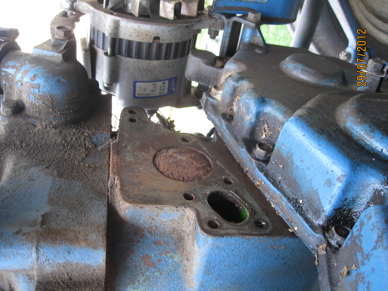

Pictures of engine mounting surface for the water pump. The lower right mounting bolt was missing and bolt hole required cleaning. I have already found a replacement metric bolt. Any other pictures that you would like to see? Jerel
   / Ford 1700 fan pulley #17
Jerel,
The attachment did not come trough as being invalid. The pics you had are fine. On the mounting bolt, are you concerned the injector housing is lose or are yo getting oil seepage? the bolt head on the inside has a washer and supposedly it should keep it from turning once it grabs. the only way to get to the bolt is just taking the timing gear cover off ( too much work). I'd probably try to grab the nut with a vise grip and try to pull out and turn and hope for it to tighten. If it is oil that you are concerned, then I'll use some degrease to clean all the oil, let it dry out completely and cover it up with %100 silicon. Once silicon is cured it might keep the oil seepage at least for a good while. The input shaft should be pressed, driven out toward the impeller and not the other way around. I"d use couple of 2x4 and lay the old pump flat on it back and allow room for the impeller to be driven out and try to hammer it out using a piece of 2X4 if you don't have a press. The pump is toast already with the bent input shaft. Curious what caused it to bend, can't see a tight belt doing it.

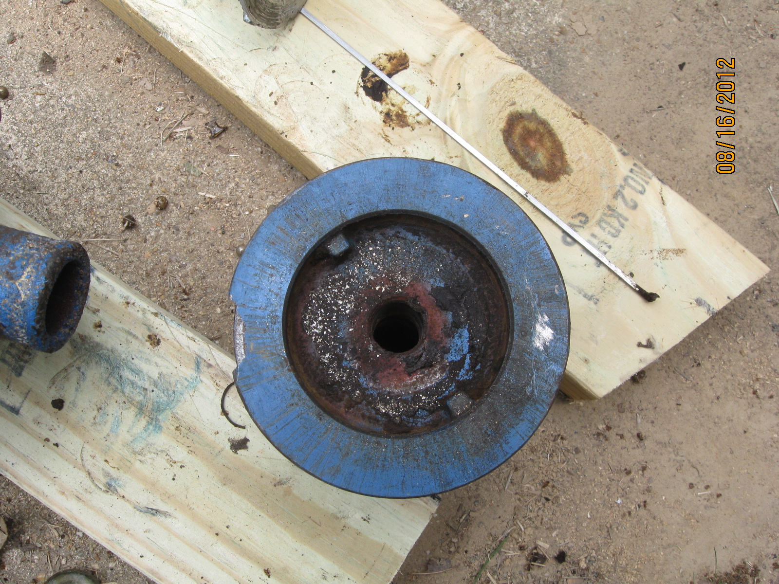

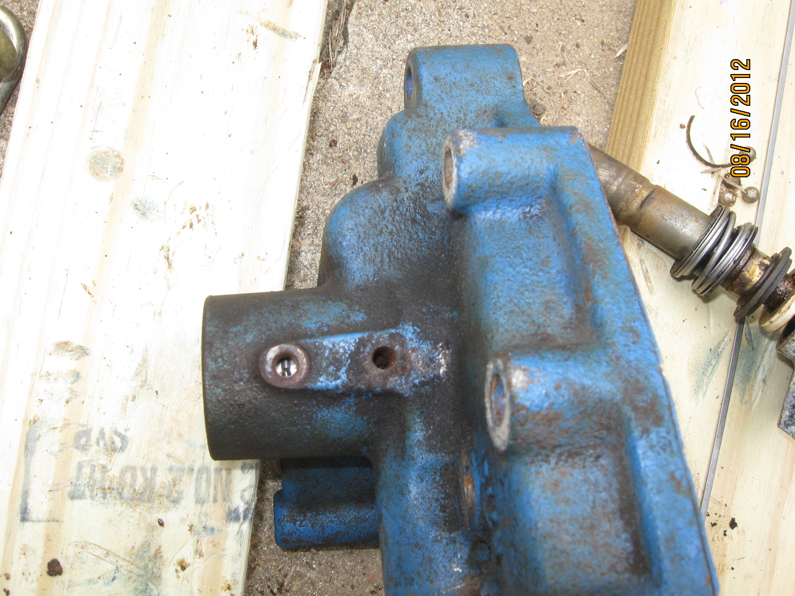

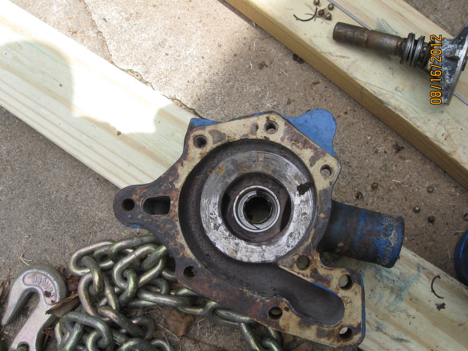

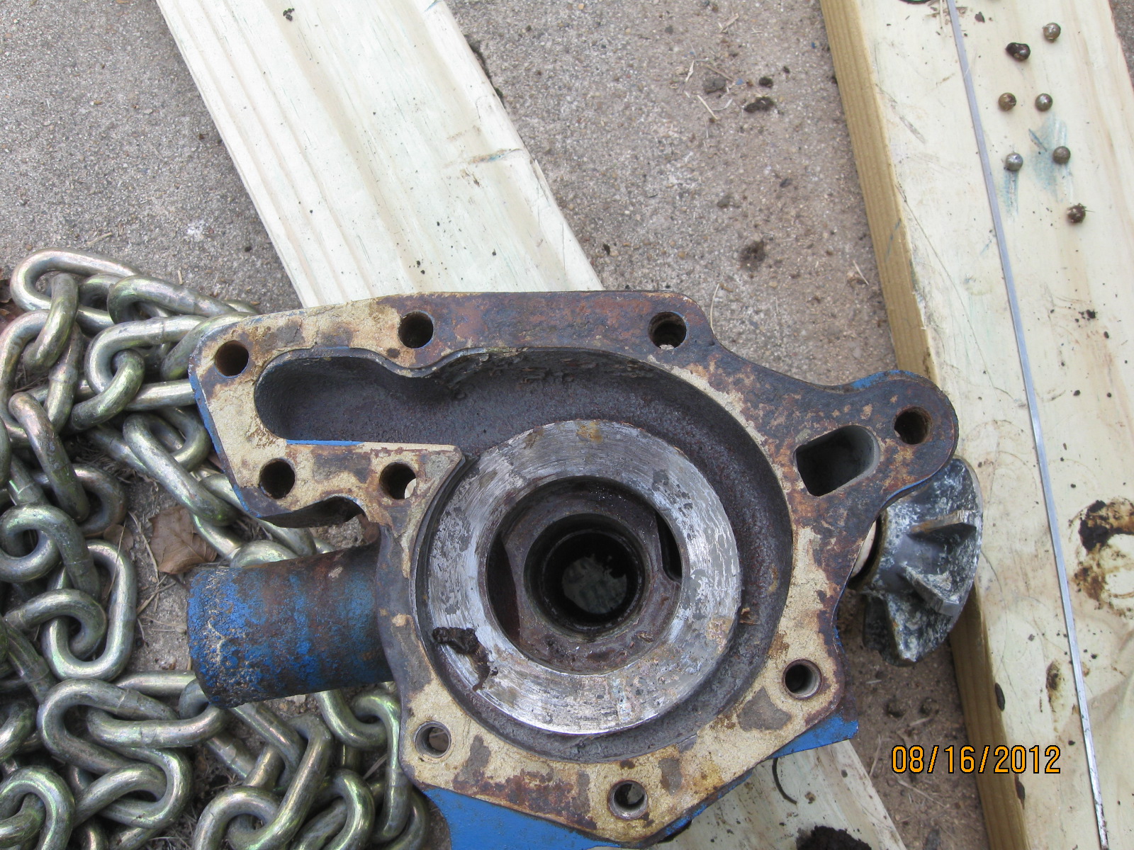

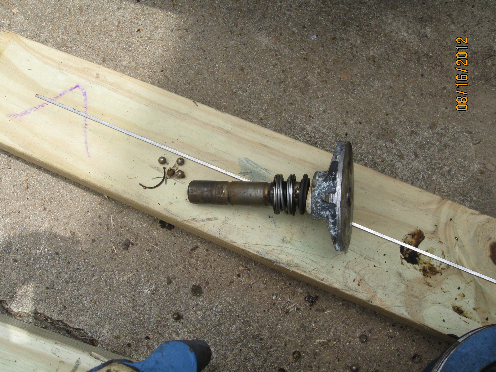

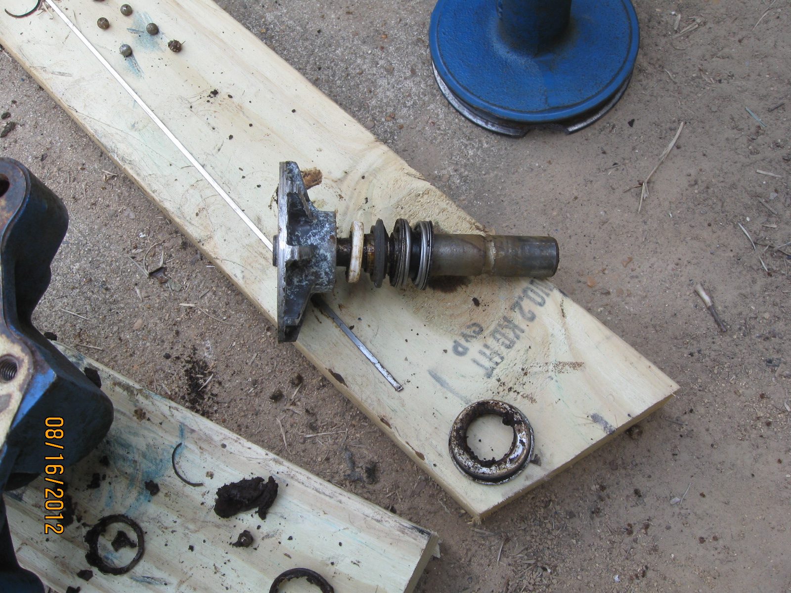

Pictures of dismembered water pump. Shaft not bent. Pump has 2 bearings and it looks like at least one of them was completely gone, allowing pulley section to tilt in relation to pump section. Engine RPM's would probably affect how true the shaft and pullely would run. Would explain the variation in sounds I would hear with engine idling. Not sure how many pictures I can attach at one time, so will attach in multiple replies. Now to move on to injector pump mount problem. Jerel
#19

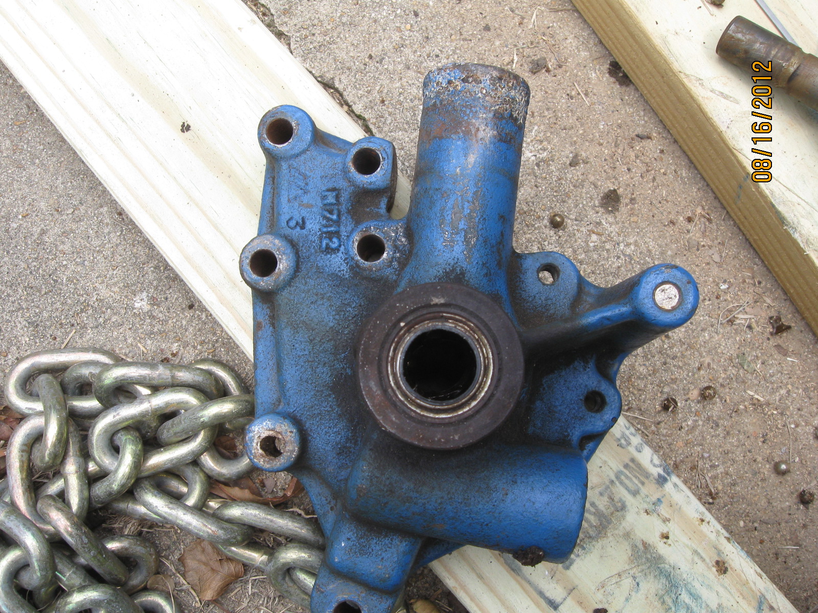

More water pump pictures.
#20
Last of water pump pictures. If you have any questions, I'll do my best to answer them or take other picture angles for you. The only thing that I can come up with regarding the small bolt in shaft housing is to position what appears to be a bushing. The rubber seal with spring butts up against the inner end of this bushing. Sound reasonable to you? Jerel
