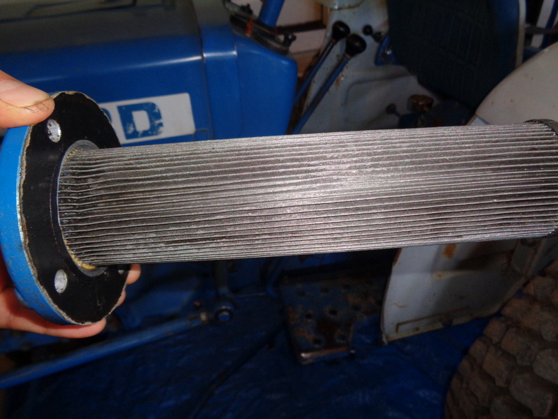

Thank you JC
I was in the process of pulling the filter again just to make sure it isn't clogged. I doubt it is. The tractor has only run a total of probably 15 min since we cleaned it, and we washed the housing out with diesel fuel before we reinstalled the filter and put in new oil. I'll go ahead and back off on the relief valve tension, then go look for a gauge.

Good news, kinda...
Got back with the gauge and installed it. Cranked it up to see if it would register anything, and it didn't. Then I went to pull the filter and check it to make sure it wasn't clogged again. When i went to take out the banjo bolt, it wasn't very tight. Neither were the 4 bolts around the filter. I pulled the filter and it was clean. Put it all back together and tightened everything up. Cranked it back up and everything seems to work like it should. The first few cycles were squishy. I could stand on the arms and they would go down, but spring back up. After I got the air out, they wouldn't budge. Had my son (230#) stand on the arms and it would go up and down without a hiccup. Worked at idle, worked at 2500 and everything seems right. We only mow with this tractor and the bush hog is still at brothers house. I'll check it out with the mower tomorrow. I think it might have been sucking air. The bolts really didn't seem that loose, but they sure weren't tight.

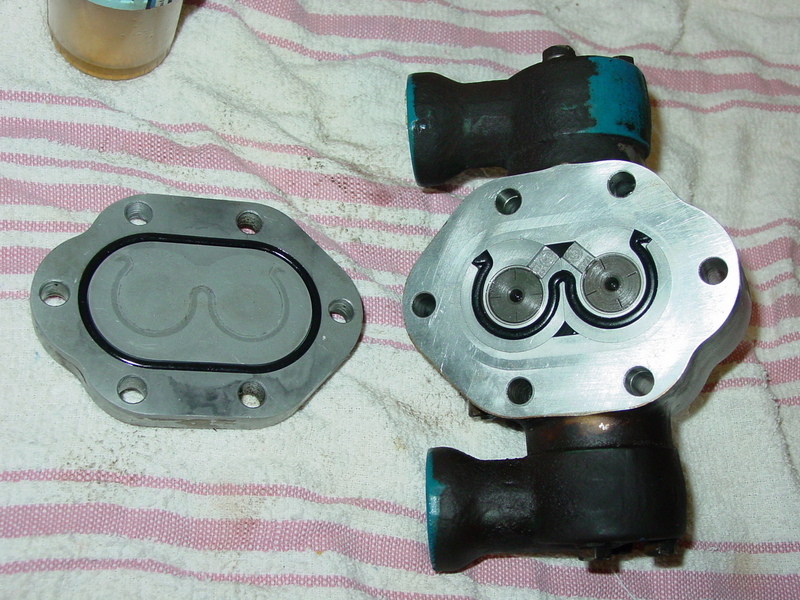

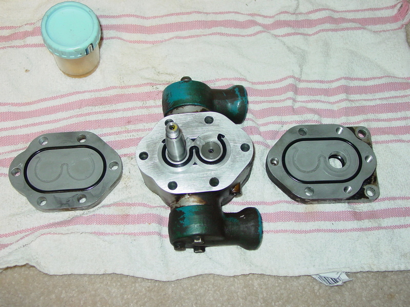

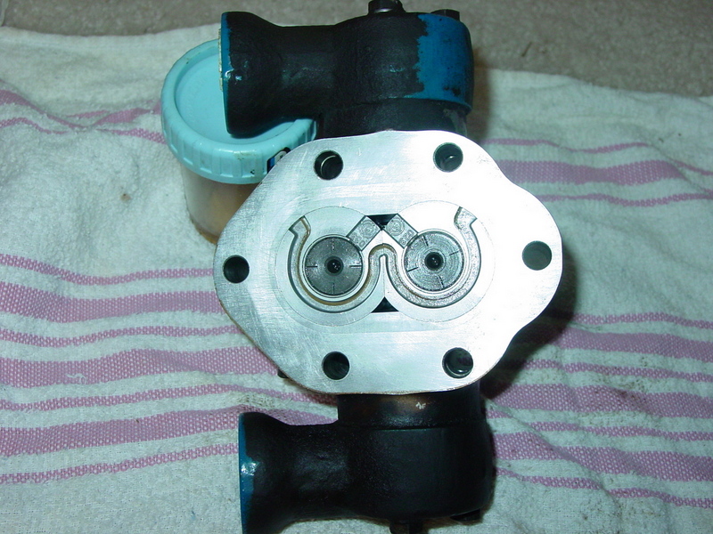

   / ford 1700 hydraulics #15

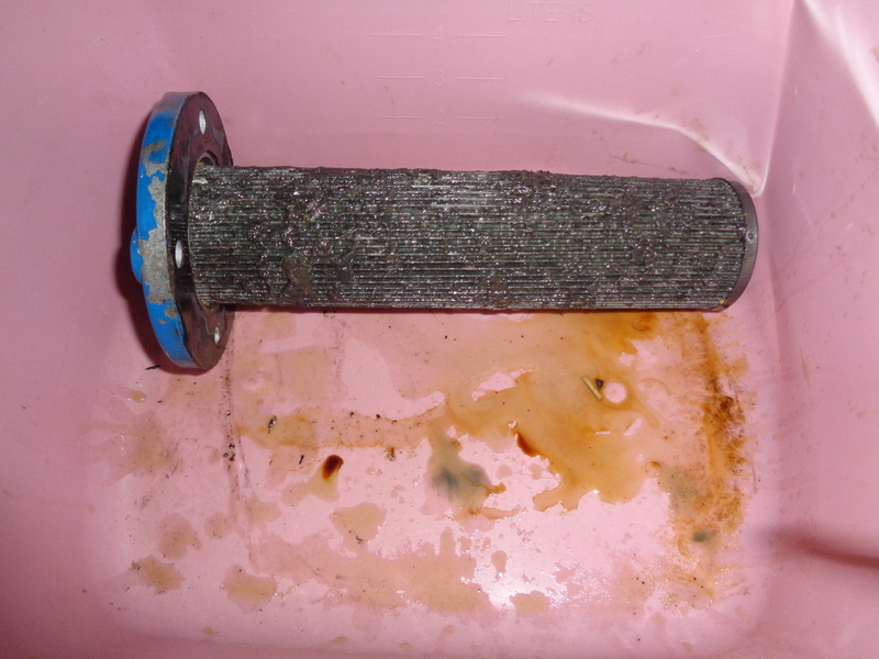

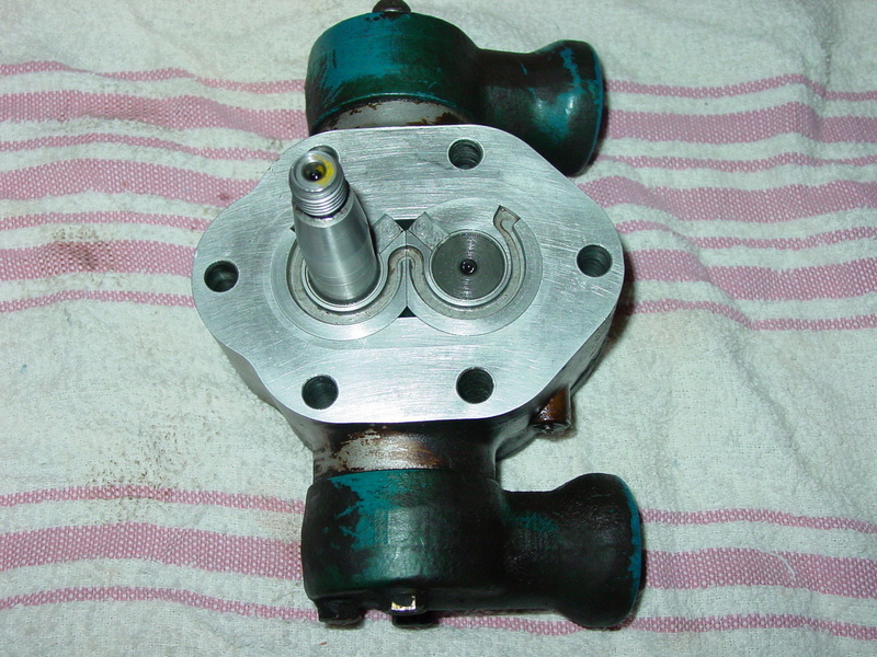

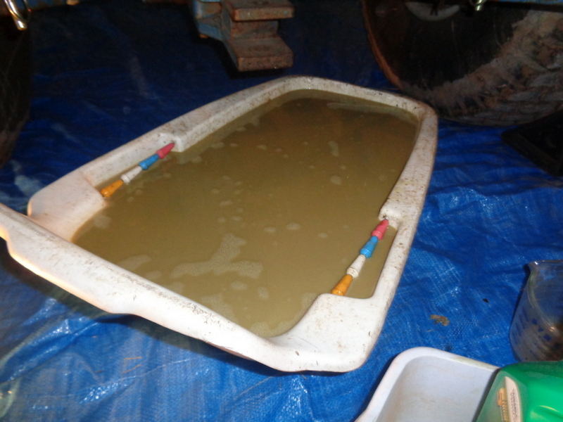

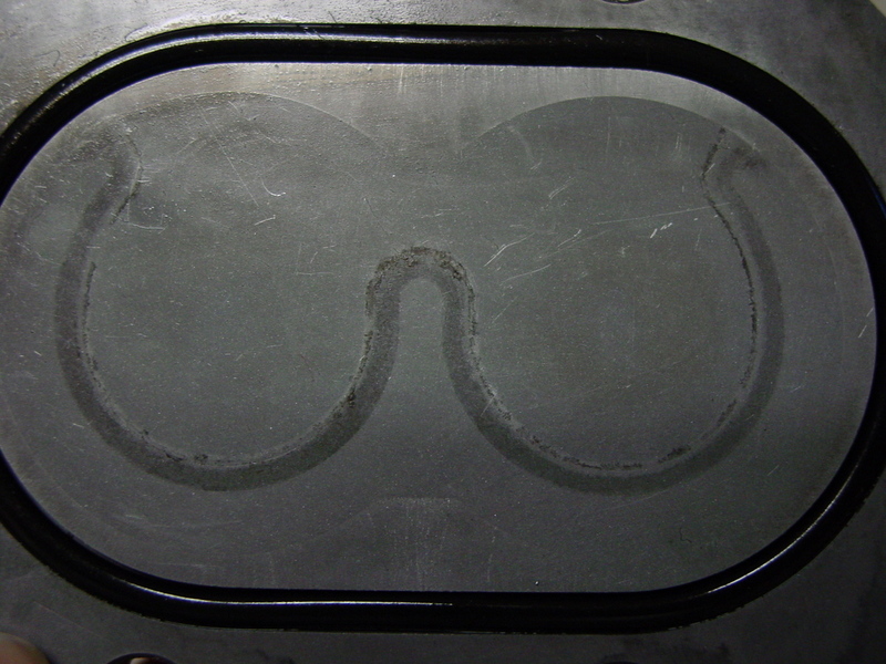

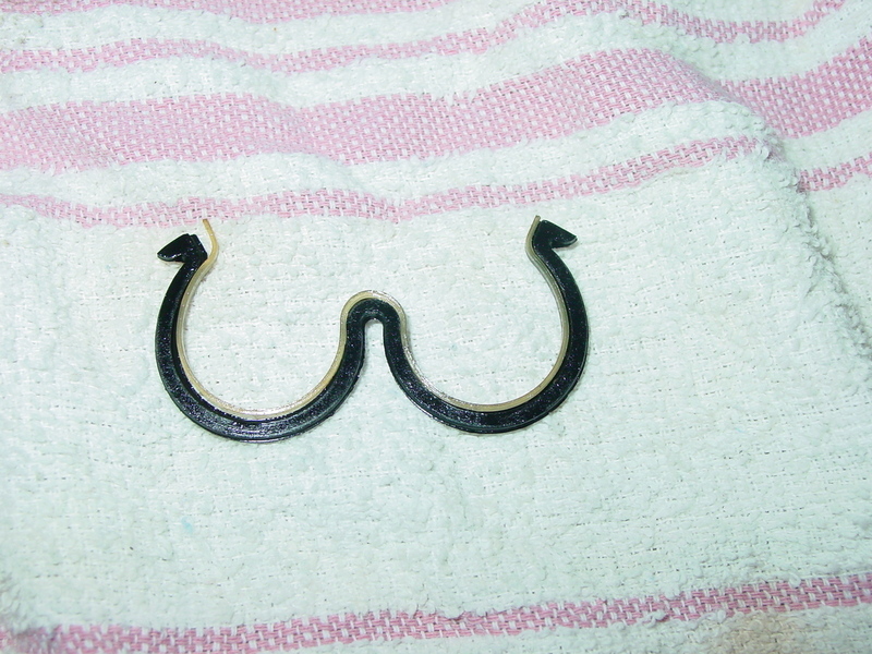

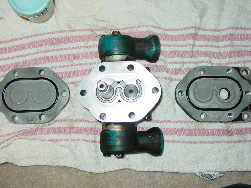

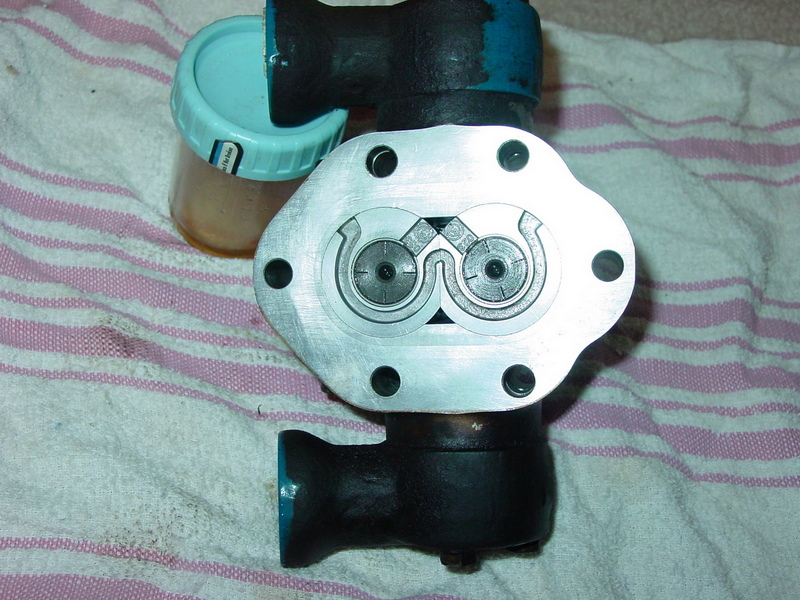

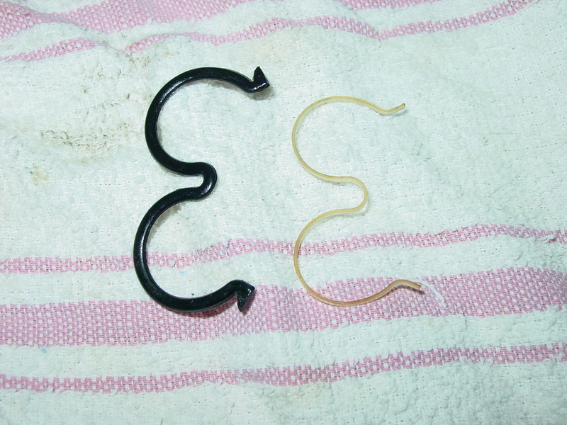

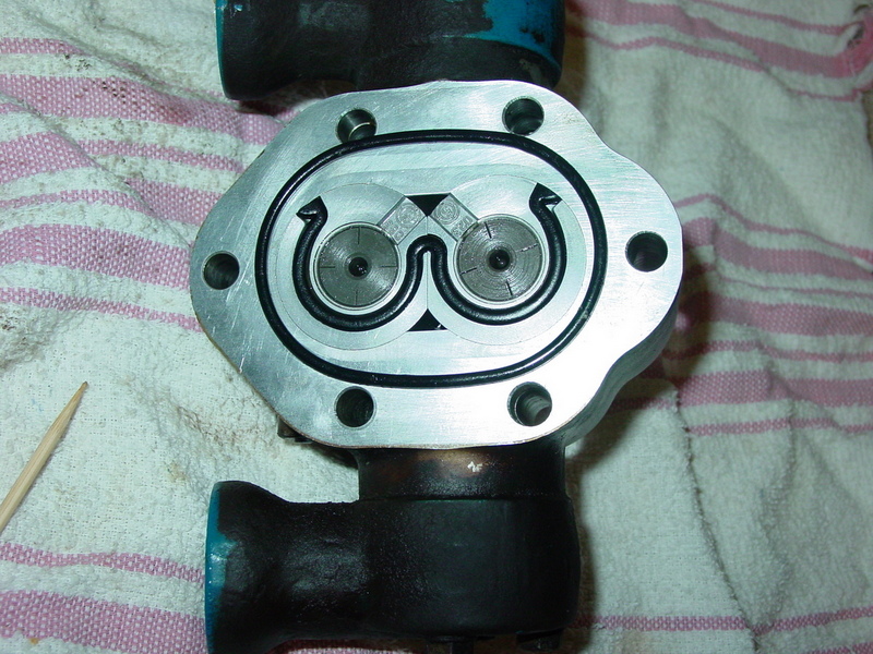

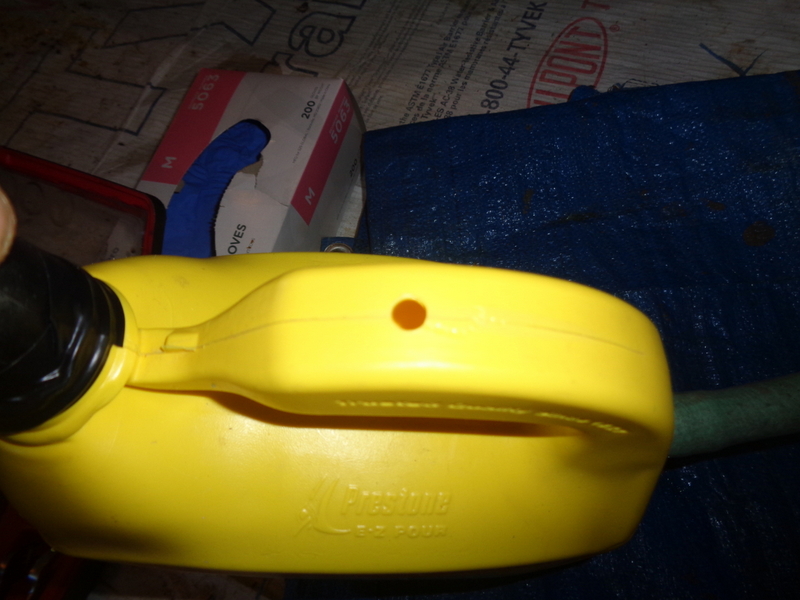

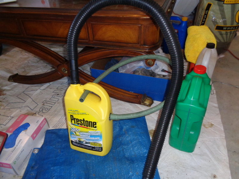

ok. if you tightening the spring stiffness all the way then the pump will be deadheading and it then should lift the poppet valve to relief the pressures so the pump will not be destroyed. If deadheading does not lift the poppet than I think pump seal are having problem. in mine , the seals were but input shaft seal was sucking air in. Just read your post #8. I own my 1700 for about 15 years. the very first time I cleaned the screen, I opened up the drain at the bottom of diffy and nothing came out, then I made a hook thingy with a stiff wire, shoved it in the whole and there it cam a rat looking glob. further when I opened the screen I made a collection jar and shop vacuumed the bottom of the diffy and sucked out about a gallon of thick pudding like crap. You might have a situation like that too. Pump overhaul is pretty easy , My overhaul kit then about $50 and I hope still available out in the aftermarket. actually I wished I bought a spare pump seal kit and lift cylinder . I wished there was a spot you could have checked the pressure on the discharge side of the before it hit the relief. I also suggest you inspect the suction pipe from banjo at the screen to inlet banjo of the pump. few pic , below on vacuum system. The hole on the handle is to keep the bucket from collapsing. plug the hole by your finger and it suck and let go it releases.

   / ford 1700 hydraulics #16
after your post # 8, I responded and did not get to see your post #9. That's great, You are gaining on it. I did suggest checking the banjo, it was sucking air. Now if it lift anything, your son is heavy enough.Even if with the tractor off and weight hanging on the back it causes static pressure in the line and the gauge must, I mean must register something. why don't you take the gauge off and run the tractor with the bucket next to the hole to catch the oil. You must have oil coming out since it 3 point is working. Put some air pressure in the gauge to see if if it working. you might have a bad gauge.
