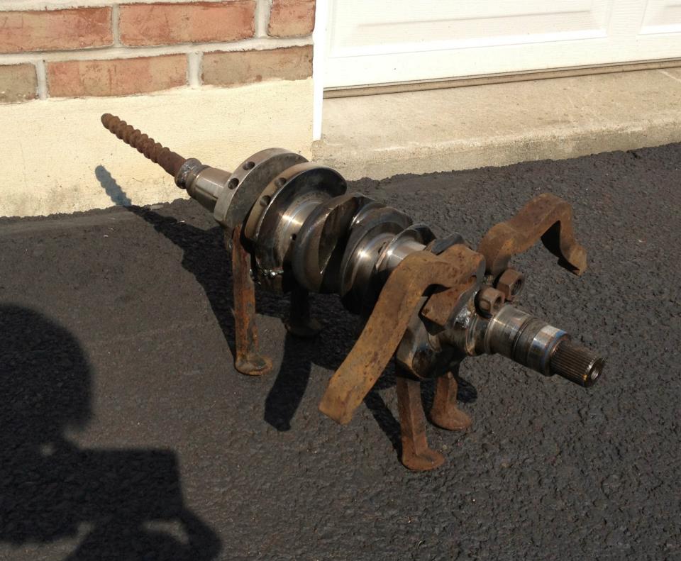

This post is 3 years old. Anyway.....the crank had broke because the motor was run low on oil. This in turn spun a main bearing which heated up the crank at the main bearing journal enough that the crank broke at the main baring support area. The motor has been rebuilt and runs like a top.
I actually welded up the old crank and turned it into some yard art. crankydog.jpg
   / Ford 1710 Crankshaft replacement #17
Is that a Crank hound or a Shaft hog?
#18
We call him Cranky Dog.
