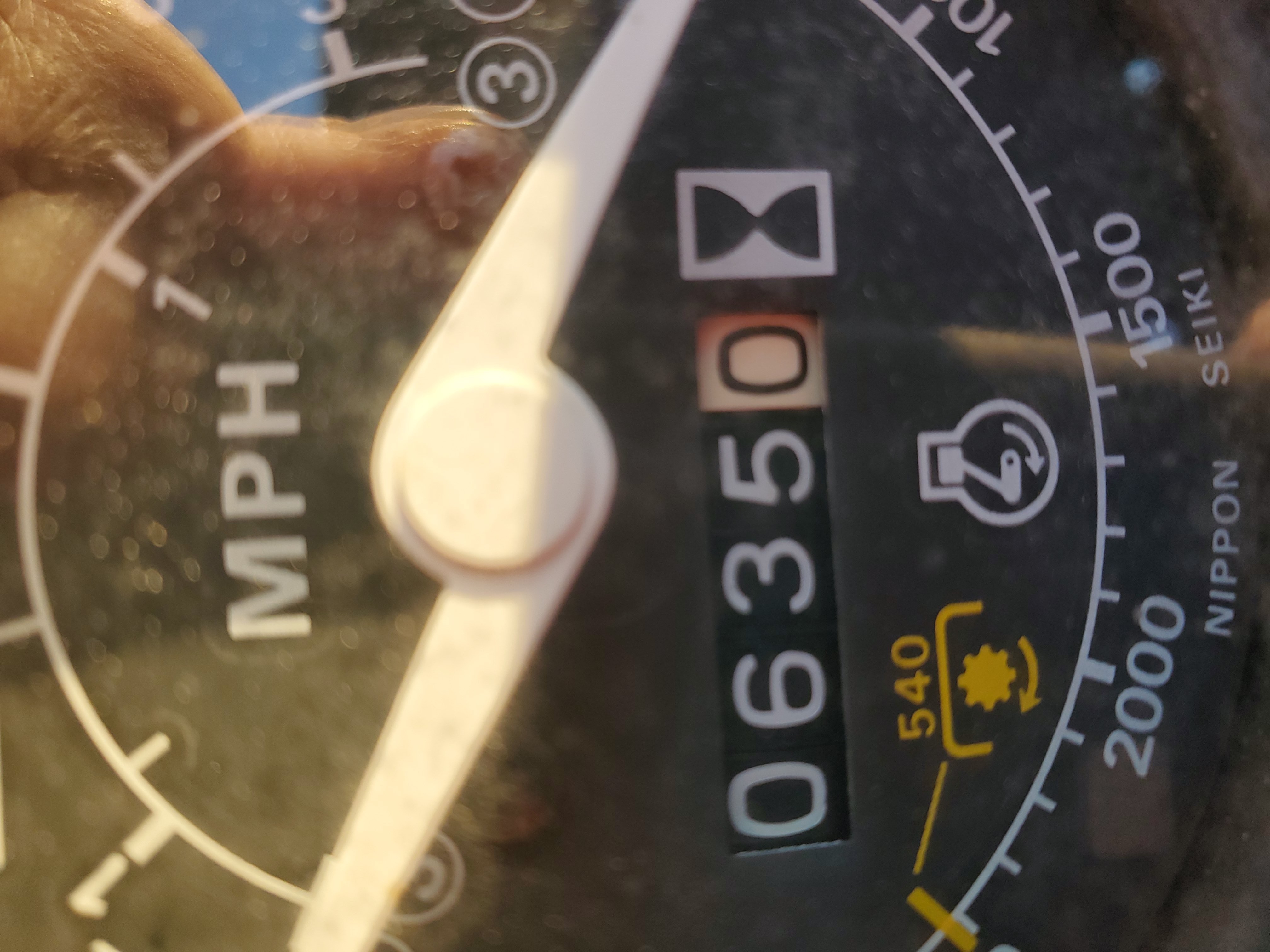

I keep forgetting to turn off the key when I shut off my diesel. I want to add a 'buzzer' when the engine shuts off and the idiot lights come on. Probably an LED light but would a 12v buzzer go off when the lights come on and which side if positive if LED?. Trying to save battery, etc, Thanx.

Probably the simplest way would be to run 12v + to a buzzer (tap into any wire that is hot when the ignition switch is on) then run the negative wire of the buzzer to the oil pressure sender. When there is no oil pressure the sender unit will ground the the negative wire from the buzzer and it will buzz. So if you use the fuel cutoff to stop the engine with the key ON, after a couple of seconds the pressure will drop to zero, the pressure switch will complete the buzzer circuit and it will buzz.
Make sure the buzzer is very low current draw, I have no idea what current the oil pressure switch is rated for.
I guess another advantage would be that it will serve as an oil pressure warning buzzer should oil pressure drop while the engine is running. Bear in mind it will be continually buzzing whenever the key is ON, and the engine is not running.
I recently replaced all my warning light bulbs with direct replacement LED bulbs, much brighter, so I'm much more likely to notice they are still on when I shut off the tractor with the fuel switch.

I used these from Amazon Amazon.com: Partsam 1pcs Ba9s 6K White LED Bulb Instrument Panel Gauge Cluster Replacement Lamp Kit 1815 1895 Bulbs 12V: Automotive
I had to shave down the tops of the idiot light sockets ever so slightly to get them to fit in and make contact properly. I pulled the idiot light panel and cleaned the bulb contacts, actually disassembled the harness plug too and cleaned the blades, used some anti-oxidation grease on them, put it all back together and they all worked.
Any similar LED bulb would work, long as it has the same base .... take note with the LED bulbs above the problem was that little white plastic ring right at the top of the metal case ... if you could find the same base type, same wattage but with a different design that didn't have that, it might go easier.
I can't attest to how long they will last out in the weather, but they are working so far ... made the swap about 2 months ago.
