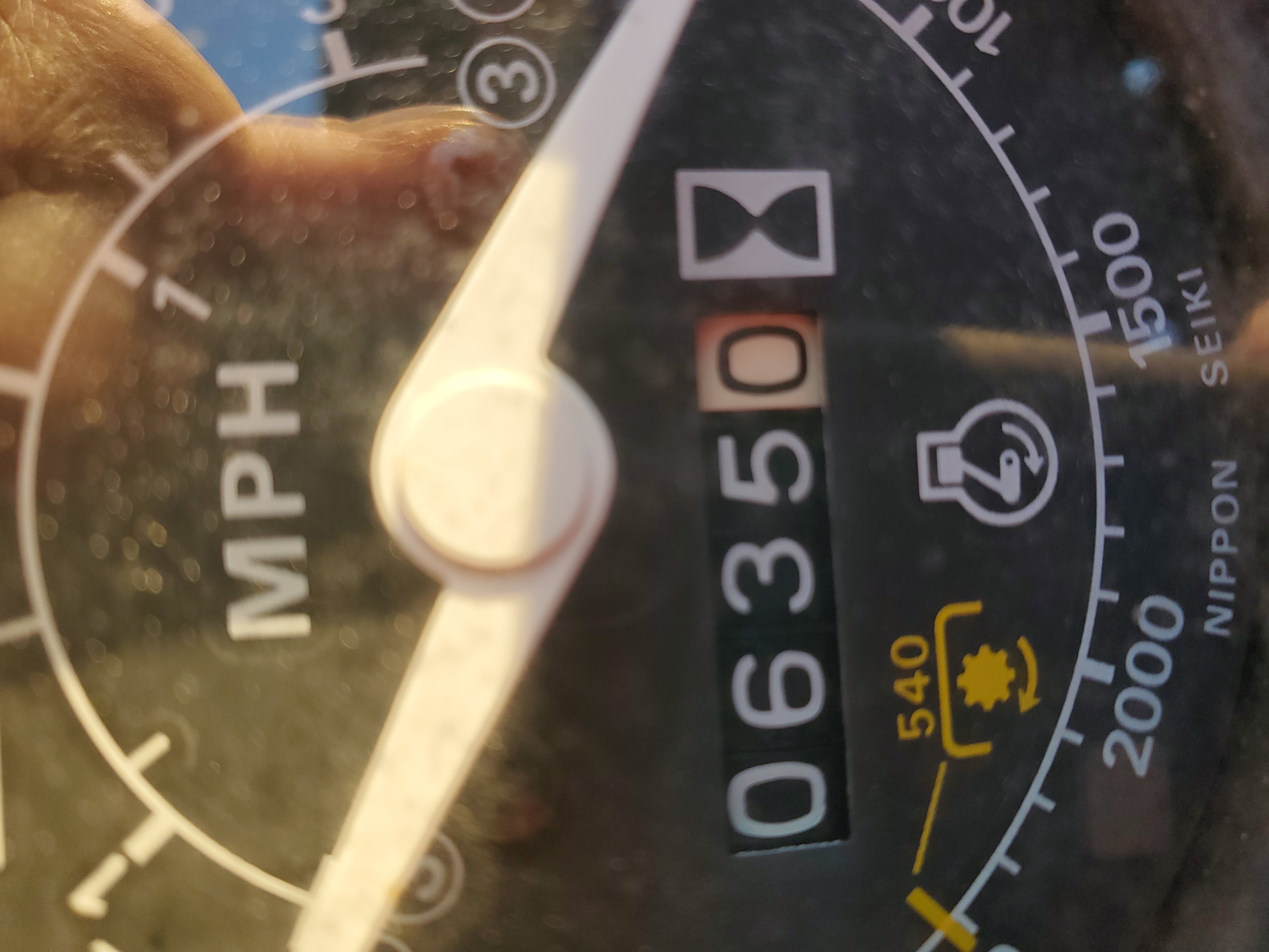

Sometimes it's a pleasure to 'tinker' on the old ones, even this one is old but low hours hours.jpg. sheet metal all banged up, one tire has been replaced. Had to disassemble the seat an rework. Now is definitely a little workhorse.
