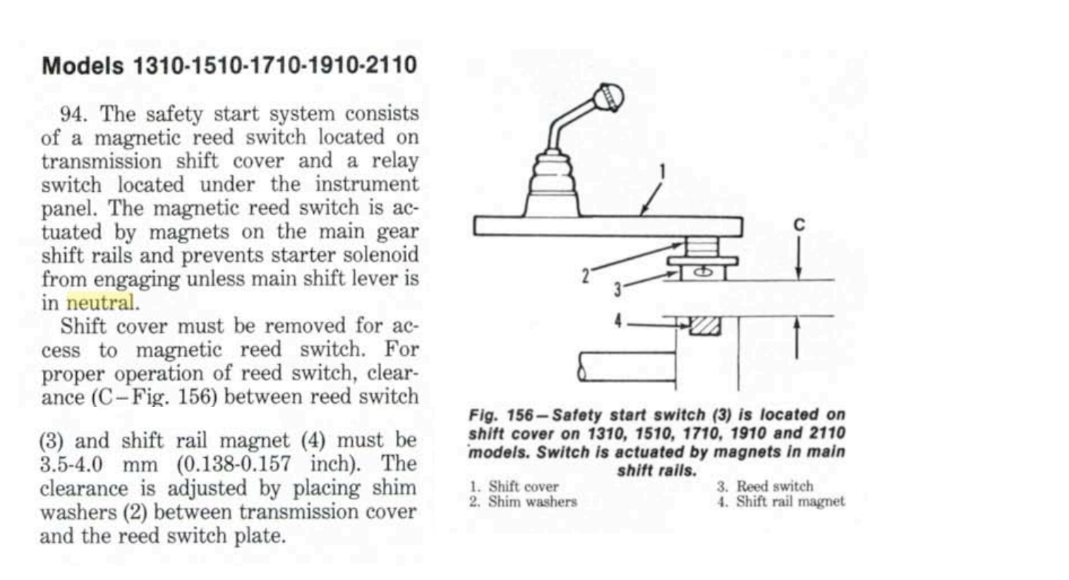

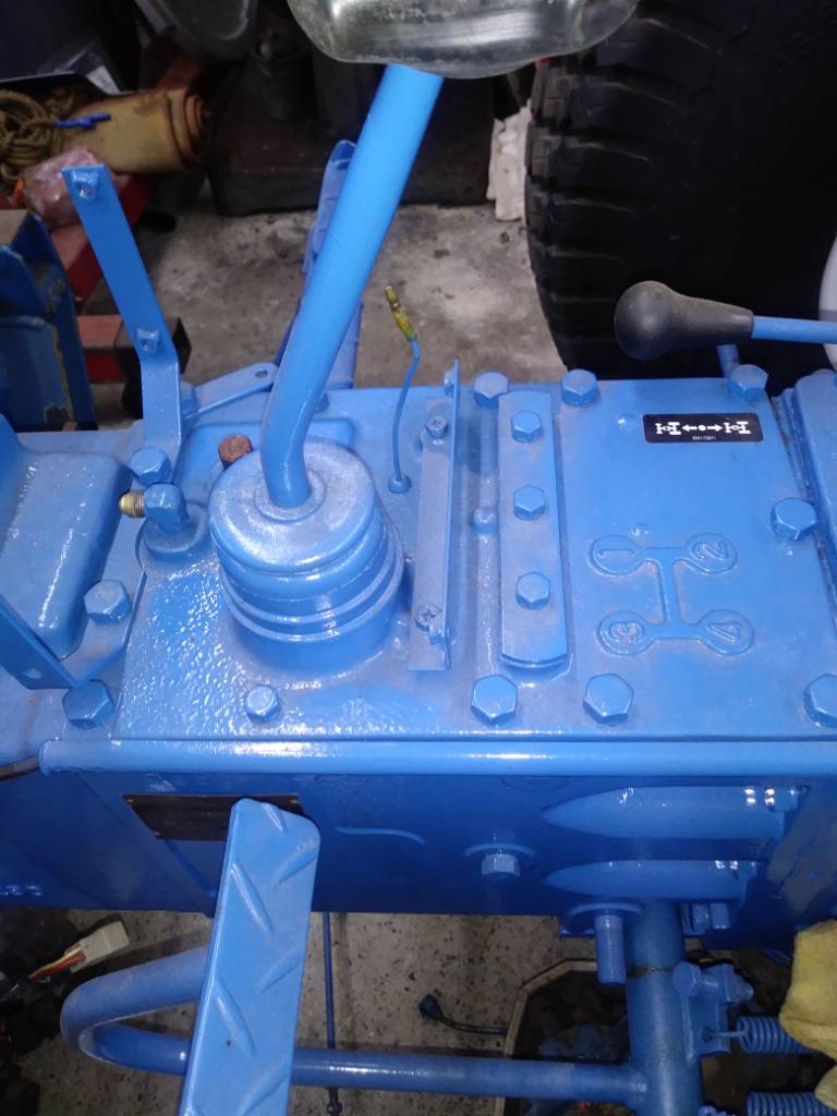

On the 13,15 and 1710 the switch is internally mounted. These models do not have any switches on the clutch pedal. These models you have to put the gear selector in the neutral position to start.
This switch provides a path to ground to enable the starter relay. The relay is usually the problem, but is easy to troubleshoot. 0726202032.jpg0726202031.jpg

This switch provides a path to ground to enable the starter relay. The relay is usually the problem, but is easy to troubleshoot.View attachment 664433View attachment 664434
Thanks for the pic. I personally think it is a bad design. The stick shift cover cover can be removed to have access to the switch but that's a bunch of unnecessary work. Saying that and if switch is a magnetically operated reed switch then they are very robust . what happens when you ground the wire ? does it completes the starting circuit?

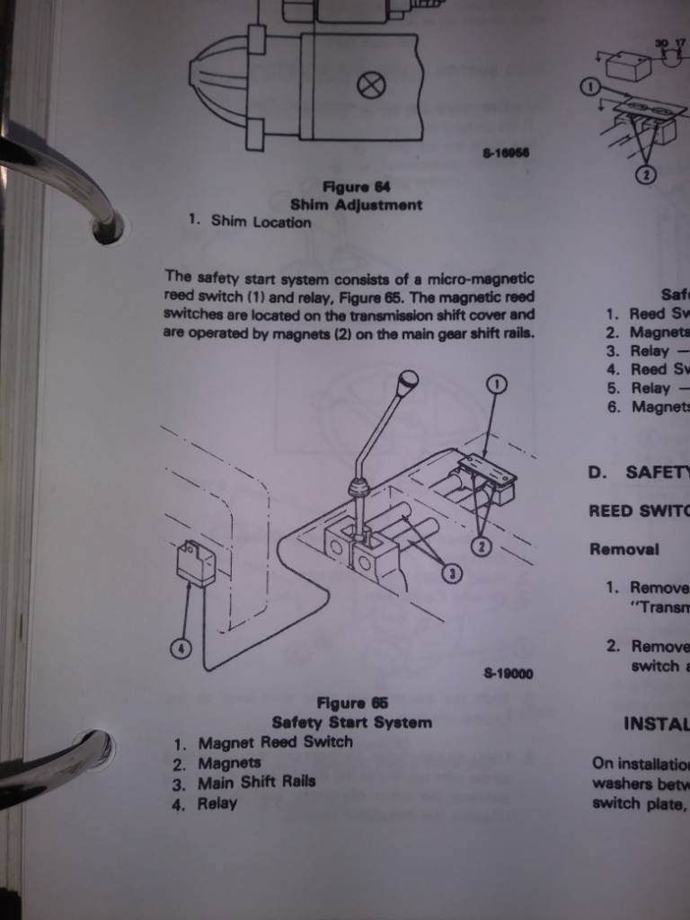

Instructions and diagram from Ford repair manual

Yes, when you ground the wire it pulls in the starter relay. The ones I have been around are very reliable. The only time I came across a switch that was a problem with is that metal shavings accumulated between the contacts. It created a higher resistance and would intermittently not close the relay. I had to remove the cover and clean the contacts of the metal shavings.

I'm new to this thread but about to tackle the Safety Switch under the transmission cover. I have a Ford 1700 with the two gear shift levers. I can verify one black wire leaving the transmission and travelling to the relay. My questions is at the relay connection. I have two wires that travel from the solenoid to the relay and then from the relay to #50 on the key switch. My question is where the black wire enters the relay. I have a second wire that leaves the relay but is connected to nothing. Where should this make a connection? Is it a ground to the tractor body?
