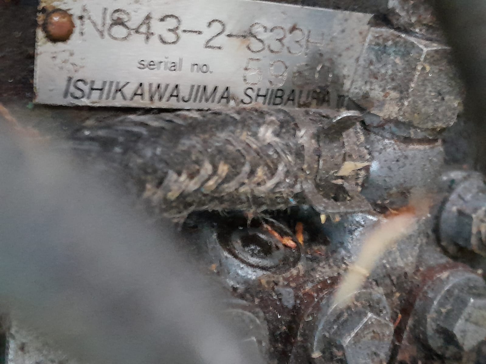

hi I am in the same boat. I have a Ransommes ct333 with a Shibaura N843 3 cyl engine seized that I ran without oil after a period sitting up... Any ideas how to get a replacement engine or parts either for retrofit? I am at a loss and thinking of just scrapping her at this stage!based in Ireland.

Since you are in Ireland, you might look at:
or
