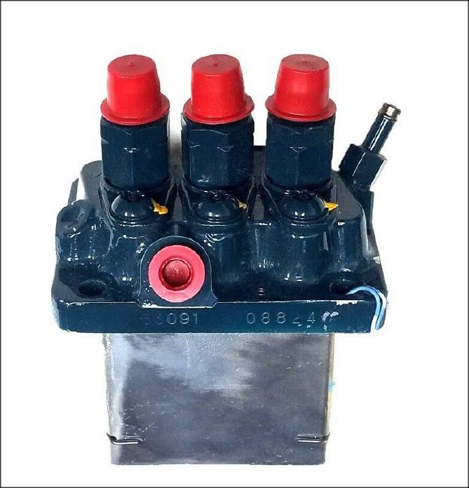

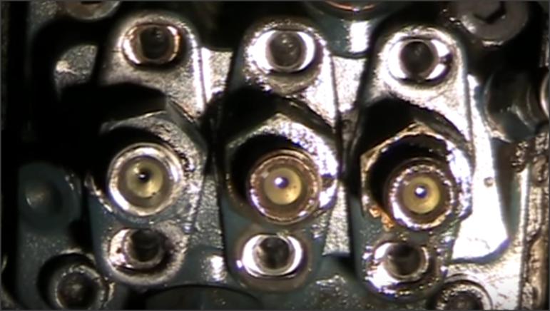

How is the amount of fuel delivery adjusted for each cylinder in the Ford pump you have?
Here is a photo of Kubota pump where fuel injection amount is adjusted by slight rotation of the delivery valves (see the oval hold down screw holes).
I think it requires a Diesel injection shop to calibrate the volumes once these have been moved.
Exactly. The initial determination that these pumps have no adjustment was incorrect. Conventional wisdom that major injection pump work is not a DIY effort is valid. The pump will have to go out for calibration.

Diesel Kiki made the PFR3 injection pumps for Ford 1710 and probably also for 1715 but the OP can easily verify that?
Here is a photo of Diesel Kiki PFR 3 Cylinder injection pump showing exactly the same type of injection volume adjustments as the pump in my Kubota V1305

Well, You guys are correct. It is a Kiki pump, exactly like the Kubota. I was curious about the rotation of the individual cylinders once I saw that they had elongated holes and could rotate. I made witness marks and tried to put them back where they were originally, but it's entirely possible I got them slightly off.
I verified today that I'm not missing a cylinder. Loosening the lines one at a time while engine was running caused a drop in engine power, with the center cylinder causing the most drastic drop. I also noted that fuel volume was much higher under pressure than the other 2 cylinders, so it's definitely pump calibration.
Thanks all for the help.
