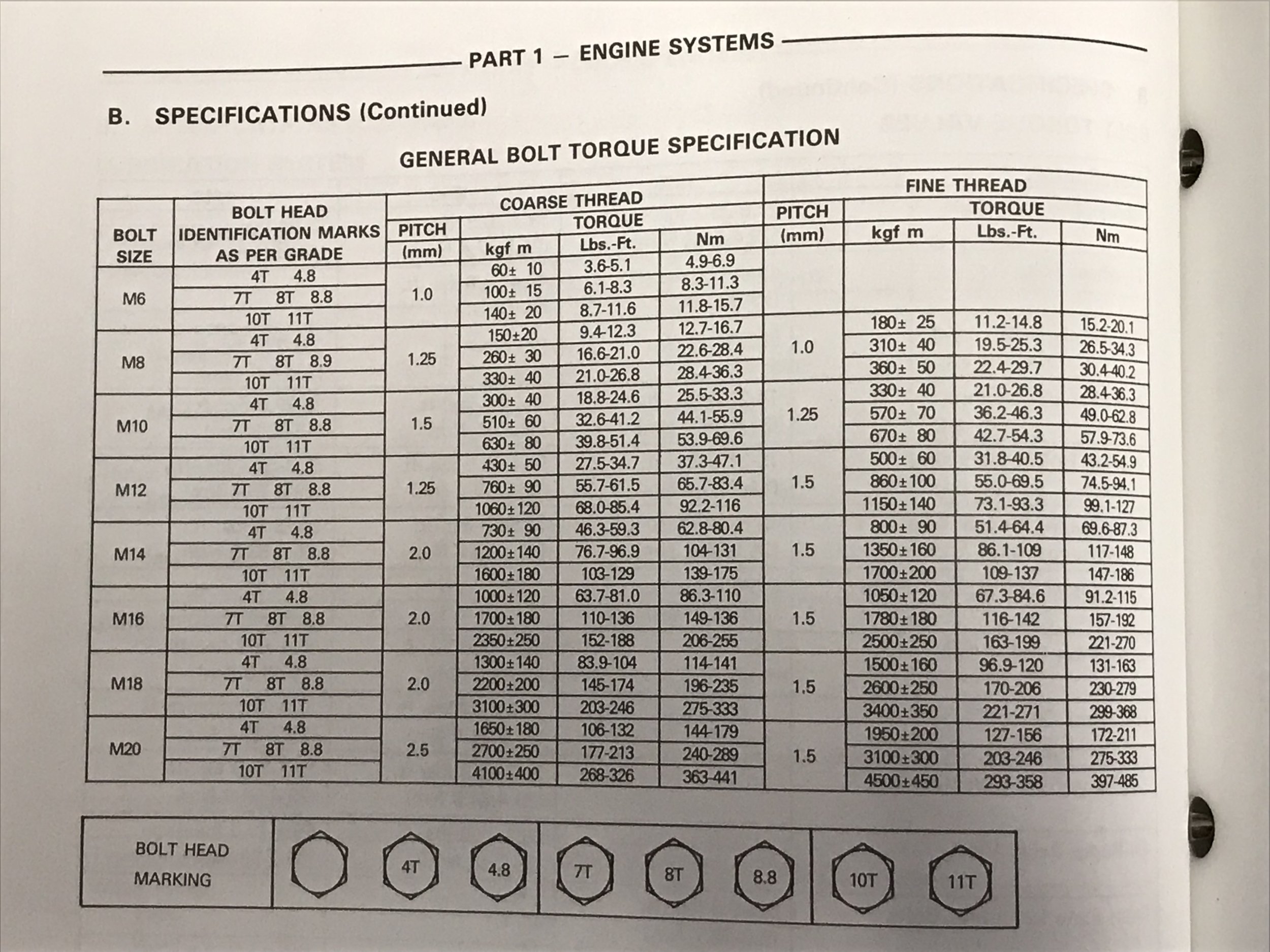

Nothing in a 1310 thru 1710 manual either regarding timing cover bolt torque, all I could find is this:

Yes. The general torque specs I saw as well. Assume these were meant for metal-to-metal parts. The timing gear cover has a gasket between it and the block.
Plus, I'm not really sure what to make of the chart. The heads of the bolts are blank (except the one that goes through the alternator bracket), and being M8 (I think), that puts the torque anywhere from 9 to 26 ft-lbs, based on the chart. A pretty broad torque range.

For a timing cover, 9-12 should be adequate and safe
