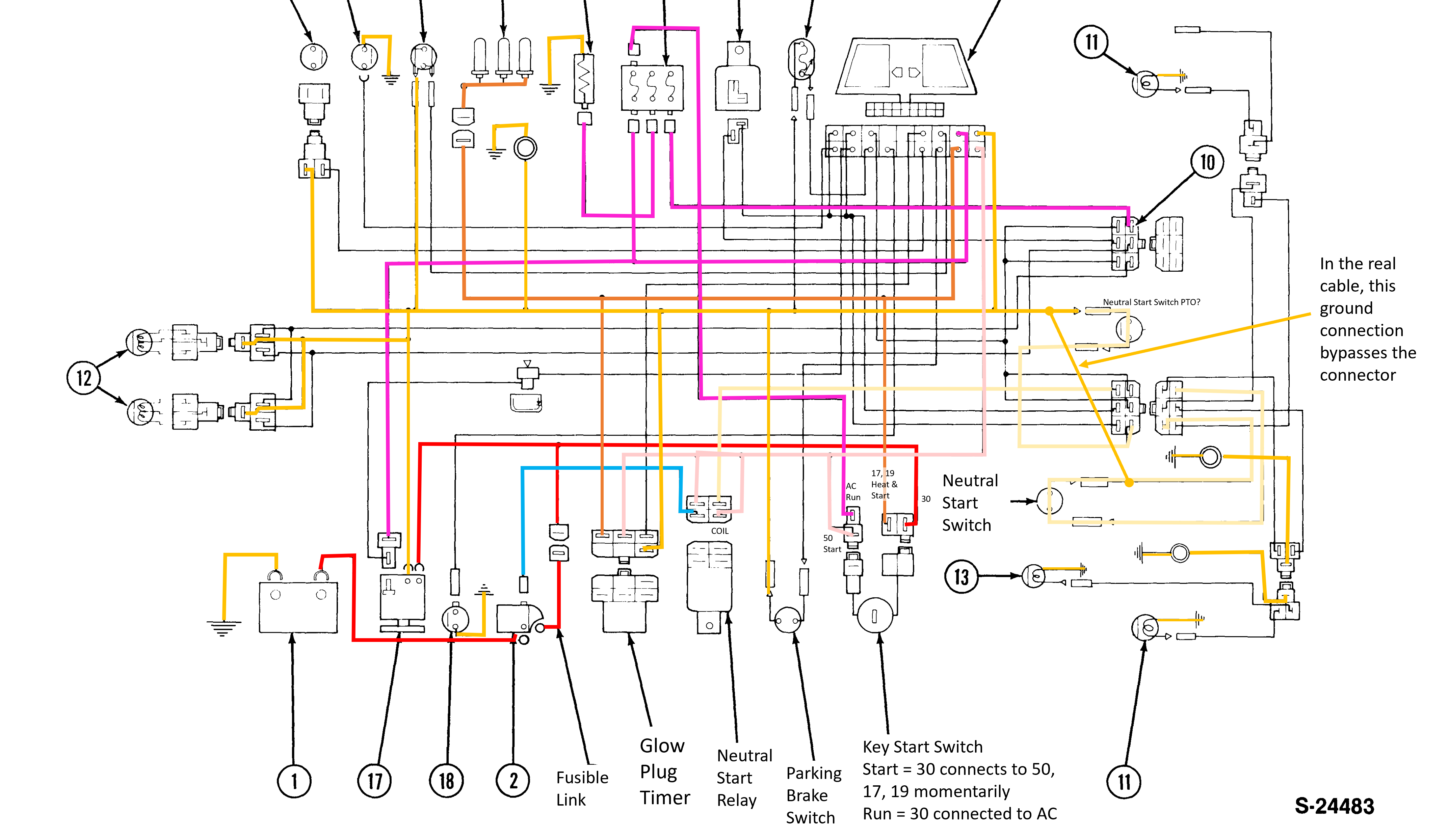

If the fusible link did blow (as
@Harry in Ky suggests) you can find replacement info in this post:
NH 1920 Fusible Link rating?
But before replacing it, you need to recheck the wiring for something that caused the fusible link to blow, such as miswiring the Key Switch.
If the fusible link is good, the next guess would still be miswiring the Key Switch.
Power comes into the tractor on the red wire which should be connected to switch terminal 30.
Black/White wire should go to terminal 17.
Yellow/Black wire should go to terminal 19.
AC terminal should go to the fuses.
Terminal 50 goes to things like the neutral start relay and the glow plug timer, etc.

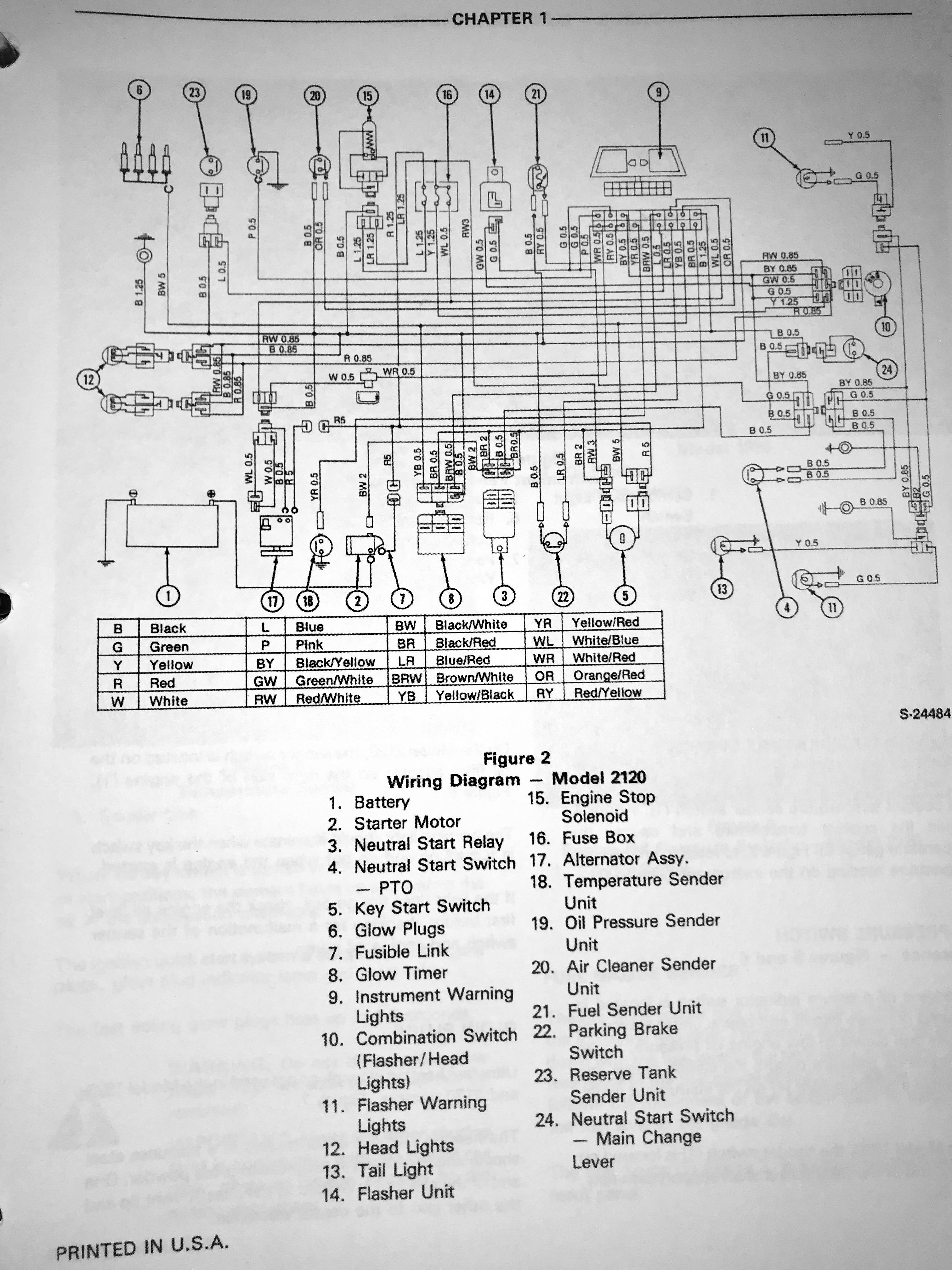

I've attached a highlighted schematic.
If you have the repair manual, note that in figure 79 for the Key Switch, the descriptions for terminal 50 and terminal AC appear to be swapped. Figure 78 is correct.
The Neutral Start Relay is unlikely to be the cause of this issue.
