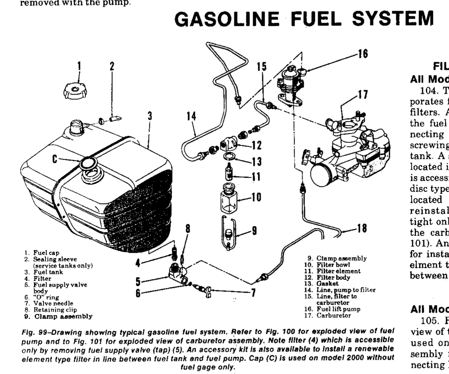

Is anyone able to share photos or drawings of the correct path for fuel lines?
I have acquired a 1974 Ford 2000 with a gasoline 3 cylinder engine. Someone has cut the original fuel lines and connected directly from fuel tank to carburetor. I bought some steel tube and would like to bend and reinstall the three fuel lines:
1. Tank to pump #18
2. Pump to sediment bowl #14
3. Sediment bowl to carb #15
BUT... since the lines are missing, I don't know where they should be routed. The manual (attached) shows the bends in the tubes, but not how they fit versus the radiator and other components. I could make it work, but I would like to follow the traditional path for each tube, if possible.
A photo of someone's engine or a link to a photo would resolve all my questions easily.

I think I'd just put a clear view fuel filter and move on to something else.
