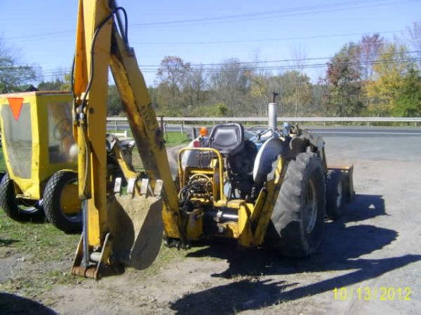

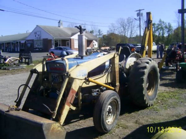

1975 Ford 2000 TLB
Ford 2000 TLB Here is a running machine.. Has a 3 cyl. diesel engine, hi-low trans,. power steering, live PTO with 3 point hitch.

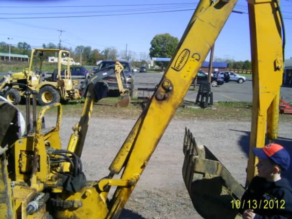

Backhoe is a BRADCO, it is tight, and well cared for, (not a beat up junker)...Backhoe is sub frame mounted (detachable)
Unit runs/works 100%!
I'm not sure of the year it was produced but I know its between 1965-1975.
   / Ford 2000 $4800 Is this a good price? #2
The unit does not look like it has had a hard life but it has been used. Not knowing what you expect out of it makes it hard but that is a lot of boom on the hoe and it will walk the tractor around while in use till you get used to it. The boom on the hoe is light compared to others of it's length so check it's structure well. check the pins for sloppyness. asw well as the engine for normal oil consumption and an important part in a tractor of this design, the clutch! Otherwise it is about what the going rate is for a machine of this design.
   / Ford 2000 $4800 Is this a good price? #3
If the real condition is about as it looks, I'd say it is a fair price. Backhoe is worth at least 1/2 of the asking price which makes the tractor & loader price attractive.
   / Ford 2000 $4800 Is this a good price? #4
Tractor looks like a super dexta. It is, if it has a diffrerentional lock. Tractor is worth around $ 2200.00
   / Ford 2000 $4800 Is this a good price? #6
that sounds like a good price we just bought a ford 3000 for 5500 with same features accept no backhoe
