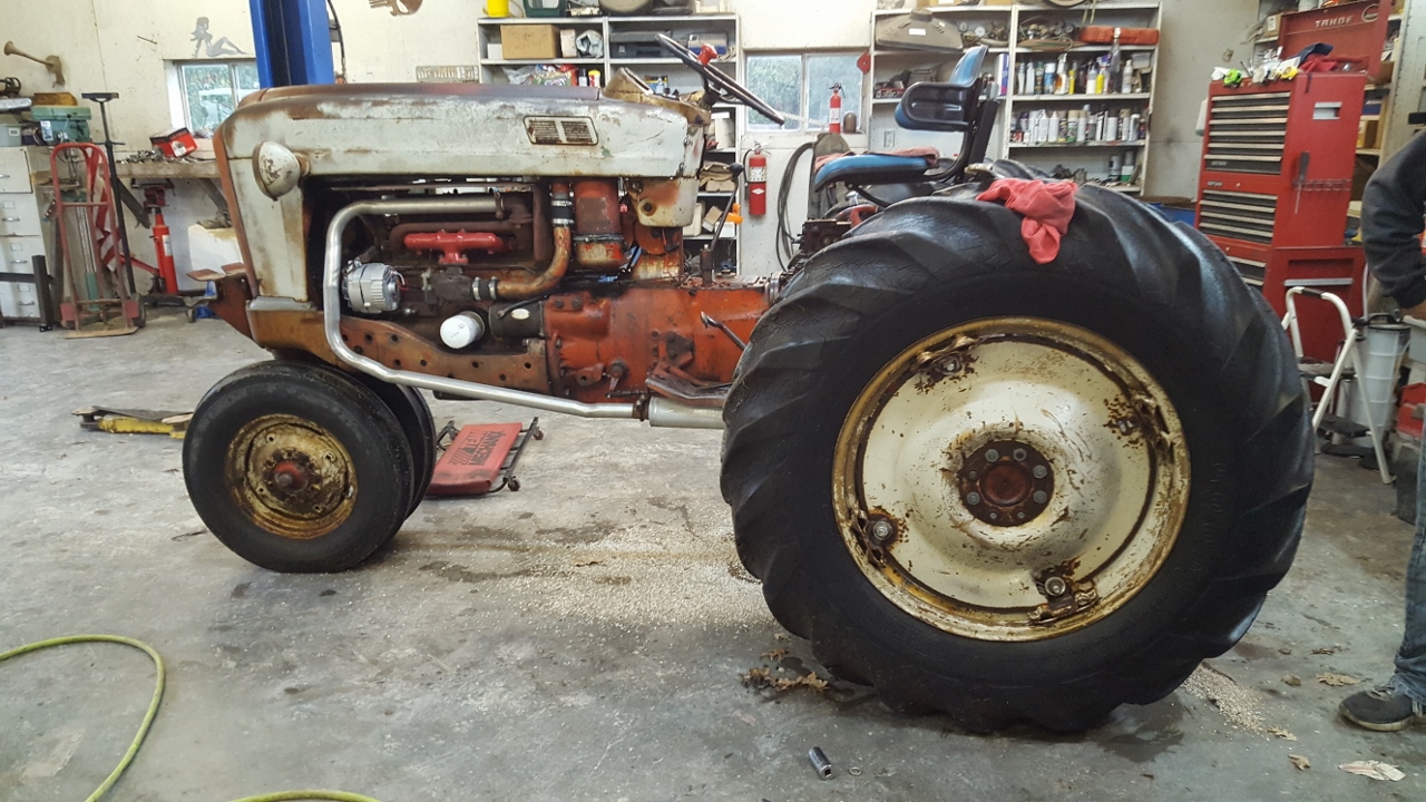

a 900 series would be year model 55-57, a 901 series would be a 58-62 year model. Essentially the same machine with a very few exceptions in the dash and fuel delivery area. possible rear hub external difference.. etc.
If you send me pics of the transmission bellhousing, rear hubs and the dash, I may be able to help you narrow it down. Those rowcrops ( 7xx, 9xx, and 541 / 2000 offset models ) are my favorite, and what I run the most. My everyday mower is a 950

I posted pics of it on another thread, can't remember where, so here ya go. It was originally a SOS tractor and sometime in it's life was converted to a 5spd. It also was originally a "gold" tractor. :)

That actually narrows it down a bit. SOS came out in 59, so it is a 901 series, and would have been a 981 or 971, depending on pto. Without the original trans about the only way to date it is via parts castings.. axle trumpet.. etc. In any case, you've made it a 951.. that's good enough to buy parts with.
