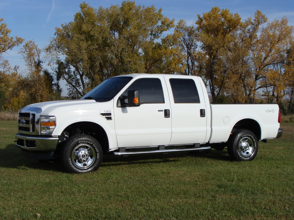

My 08' v-10 with 4.10 gears, running around town I get 11.5 mpg. Only driving 10-15k per year, I couldn't justify a diesel.
