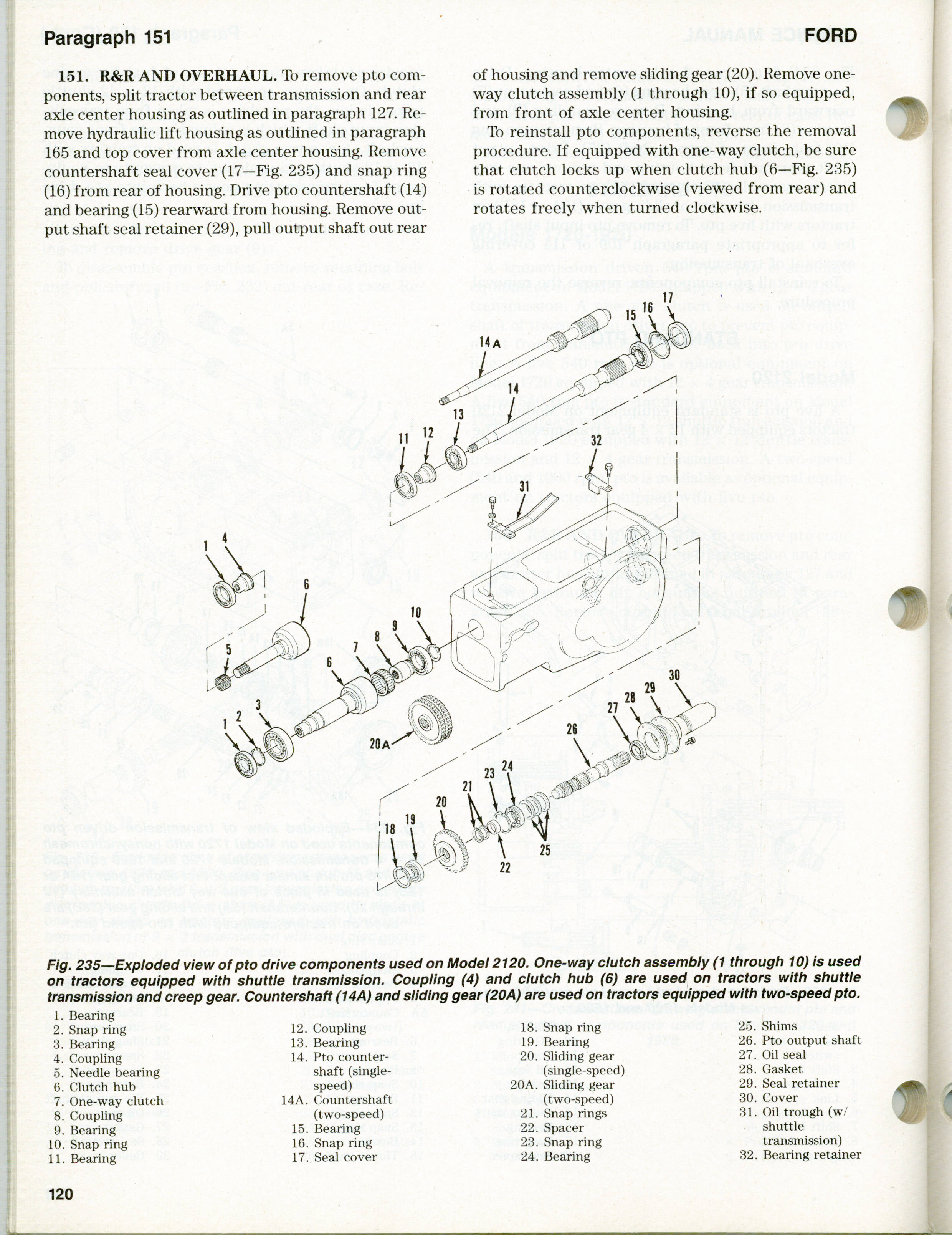

do you or anyone know how tough of a job it is to replace the one way clutch on my ford 2120? it has only 950 hours on it. is this a common problem? i am hoping i dont have to split the tractor. thanks Jim
   / Ford 2120 #12
Are you talking about the one-way clutch for the shuttle shift? That is internal to the transmission and requires a split, looks like; see diagram. Never heard of that causing trouble, but that would only be through TBN. I imagine if oil got low or watery or some such it would be sensitive. Ouch!
Jim
