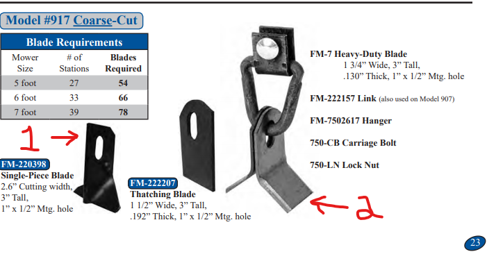

another question the the knifes, in the picture below i currently have the one on the left marked "1". would the one on the right marked "2" be better for mowing food plots and trails? what is the advantage of each. Sorry for all of the questions just trying to figure it all out. Thanks again for all of the help! flail knife.png

another question the the knifes, in the picture below i currently have the one on the left marked "1". would the one on the right marked "2" be better for mowing food plots and trails? what is the advantage of each. Sorry for all of the questions just trying to figure it all out. Thanks again for all of the help! View attachment 619580
The cut is something you will have to decide on Mallard, the scoop knives are a one and done affair. the side slicers will let you make a second or even third pass on the clippings to shred them even finer. The scoop knife was developed as a dual purpose mowing knife in that it could be used for mowing lawns and heavy brush.
The only decision will be whether you want to have brush laying down on the food plot or clippings that will dissolve quickly.
Happy Mowing
Heavier things win a fight thanks to basic physics. So the heavier a blade, the more likely it is to win a fight with a stick or a rock. For various definitions of win. You definitely want heavier blades for woody or brushy material so they impart more cutting force before bouncing.
I have side slicers on my 917, "2" according to your image. They cut woody brush up to finger size. When attempting to mow over branches or small trees 1-2" or so things would get noisy & it would just strip bark off. I'd imagine the duck foot (what you are calling "1") blades would do a bit better due to weight, but not that much better. My Peruzzo has 5lbs hammers that look basically like the duck foots. My tractor runs out of HP mowing wrist sized trees & branches while the mower is happily mulching away.
When mowing heavier brush, rocks or a well head, the lighter side slicers will just just bounce off without damage unless you jam things up really good. A heavier blade will have enough momentum to more likely damage itself. The 5lbs hammers start damaging the rocks & often taking little significant wear themselves.
The side slicers are plenty good for fields & pastures. They are also stupid cheap as its little more than light bar stock with a hole & a small bend in it. Way simpler & cheaper than the complex bending or welding required for a duck foot blade. Massively cheaper than my 5lbs cast hammers. Hitting the well wrecked 8ish side slicers & was under a $15 pain in the wallet (although I had old spares already).
