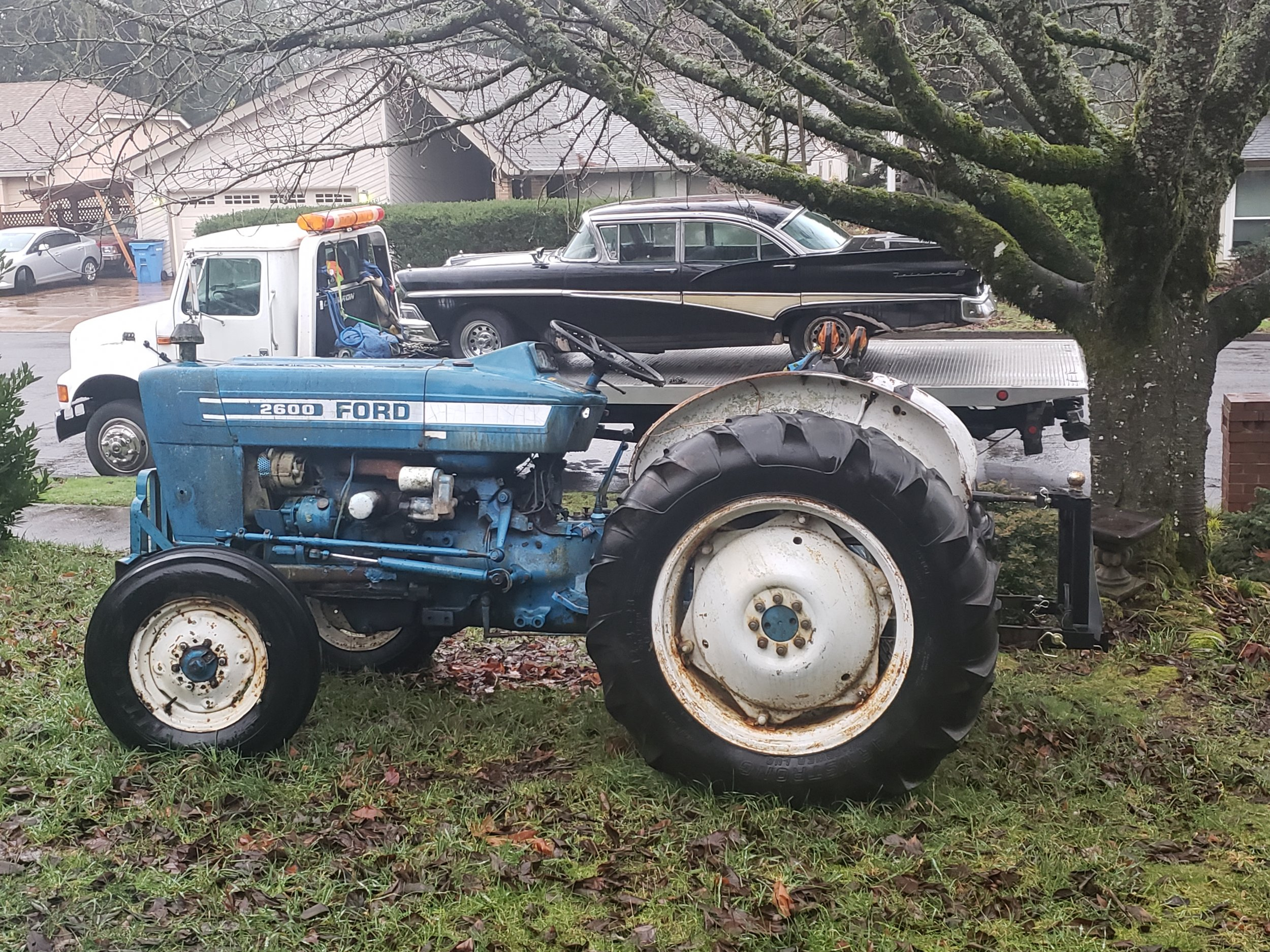

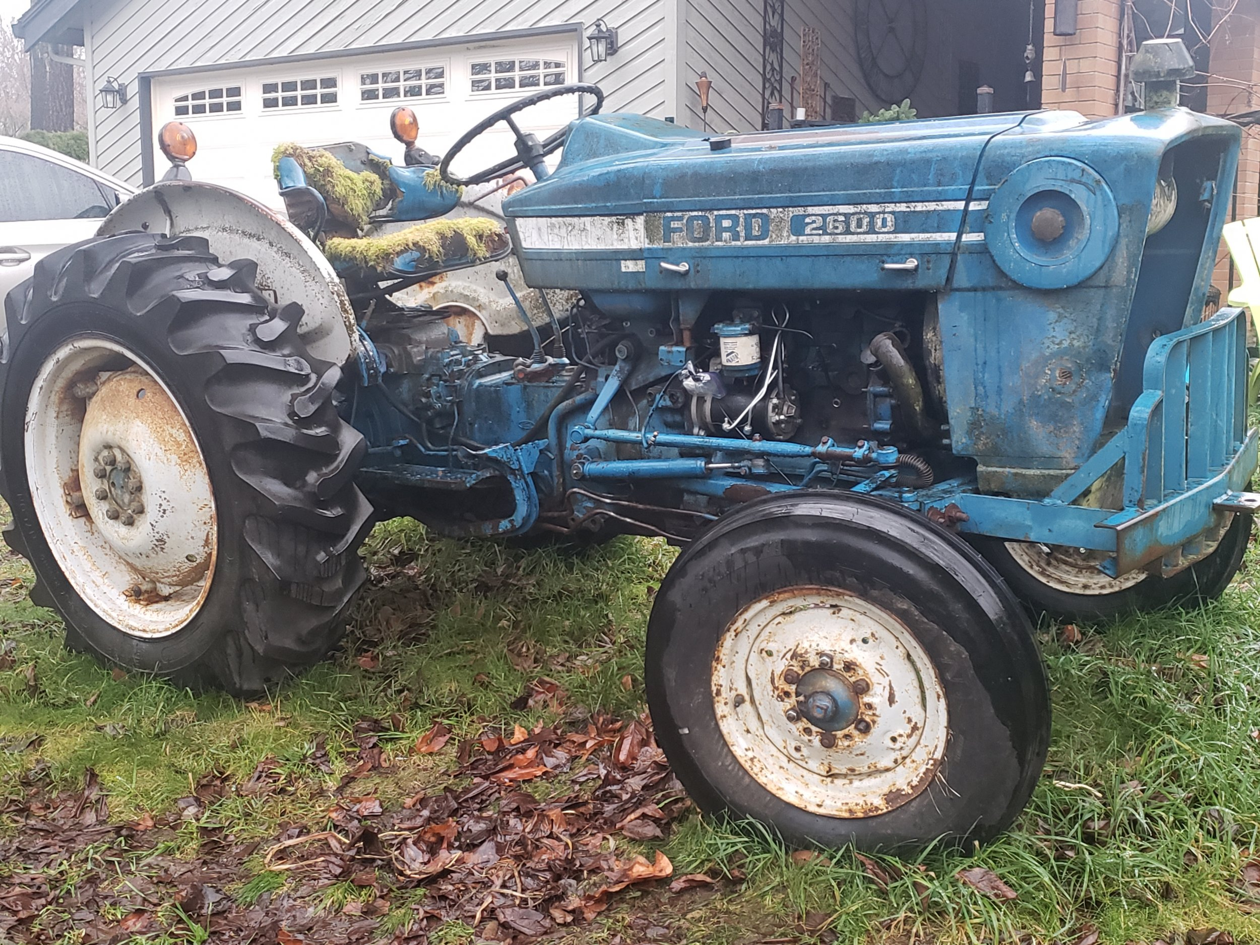

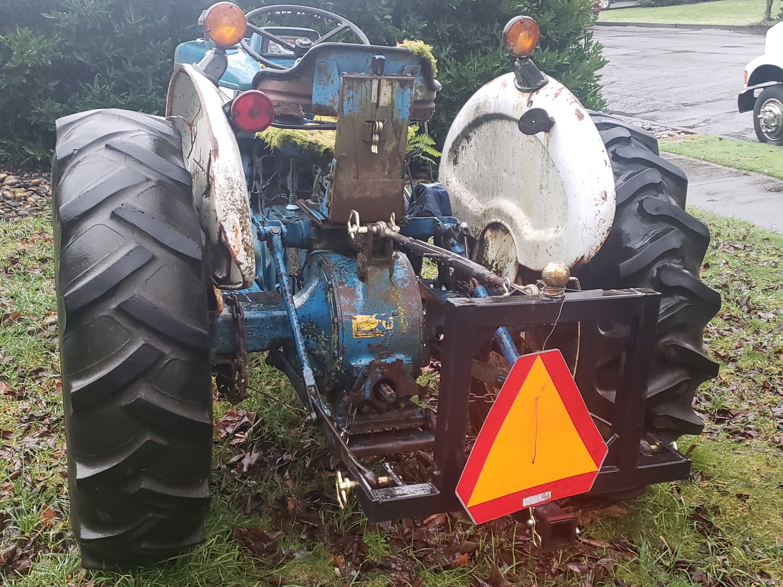

Pics of the little Ford 2600 to fix up. New seat and exhaust are in hand and up next after she runs again soon.

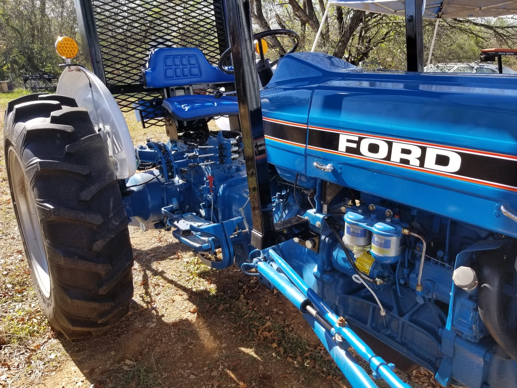

I just completed a re-paint on the 3910. Don't even have many pictures yet but here's the pump side. It's the same tractor in my Avatar but when I bought it. It stayed ugly for a long time--About 10 years.
