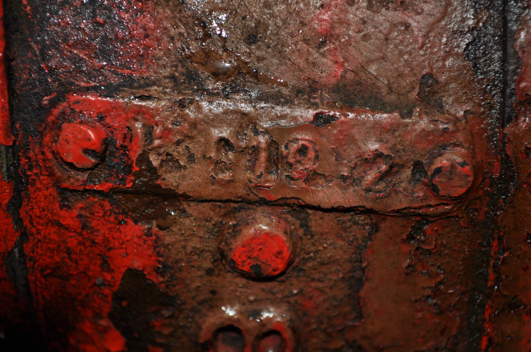

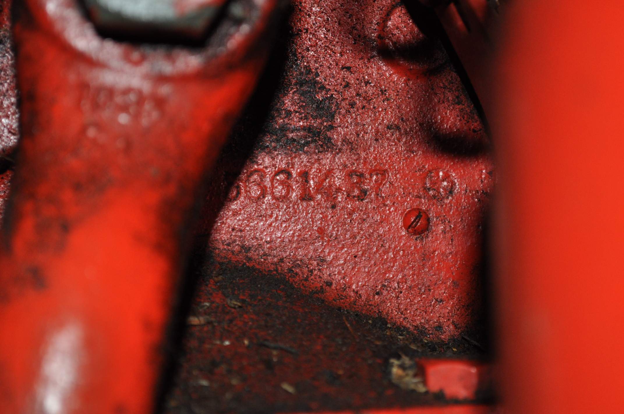

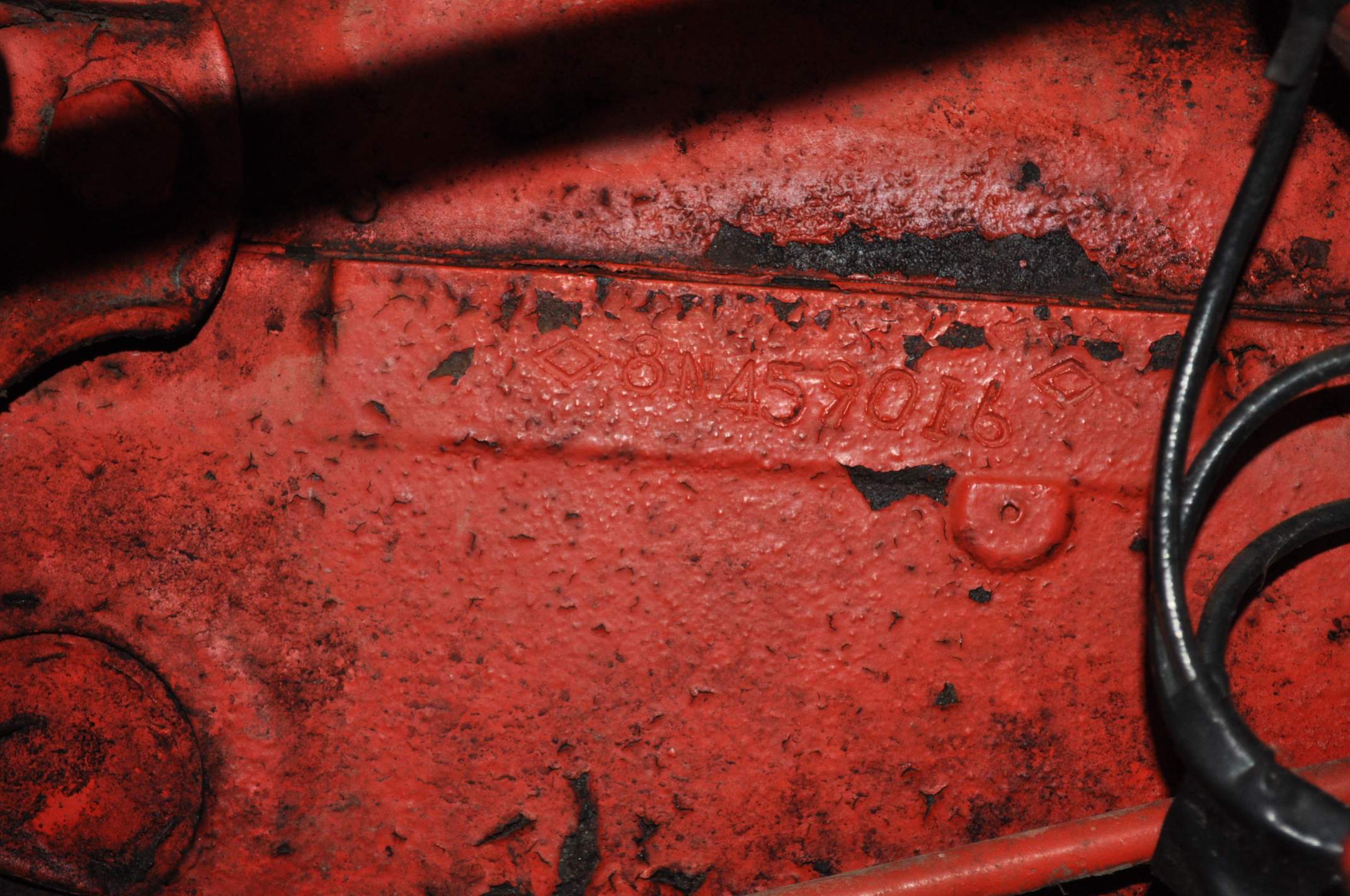

Well I got lucky as I had a job in Marlette to do today, only 25 minutes from the cabin and I had my camera this time. Needed it for the job EST. I found several numbers but I'll start with the engine block
Engine block - <> 8N459016 <> DIAMONDS very unlevel stamping but clear
number behind the oil filter 5661437 with a circle around a star, steering box
tranny behind the muffler under the foot rest 1SK a big dot L8 now it also
could have been ISH dot LB

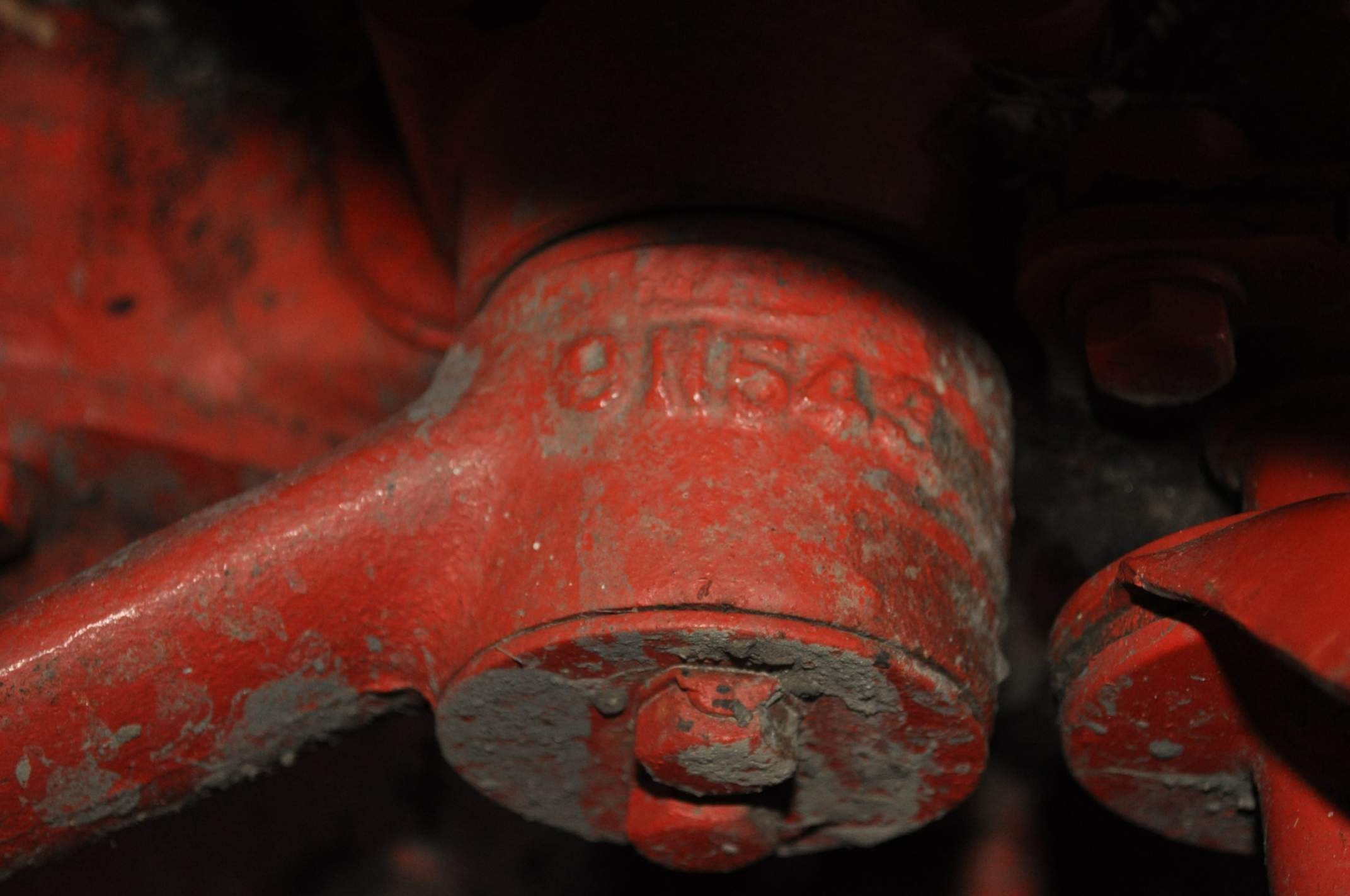

I also found a 9N543 on a arm from the 3pt under the seat.

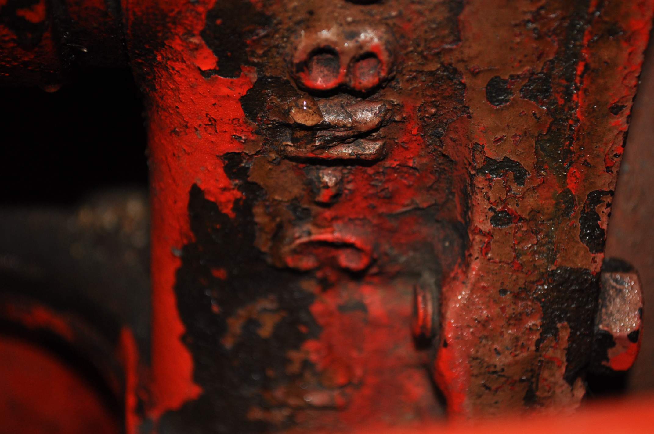

then there was another # to the right of the E block # under the battery
it was 18 819 .2 this was a hard one to read and I'm not 100% its correct
then reading verticle it was 8N-C
I will post some pictures soon, Thanks again all, it is a fun experience learning all this. They are way more fun to work on than what I usually do.

moter is an 8n.. lets see a pic of the chassie..
soundguy

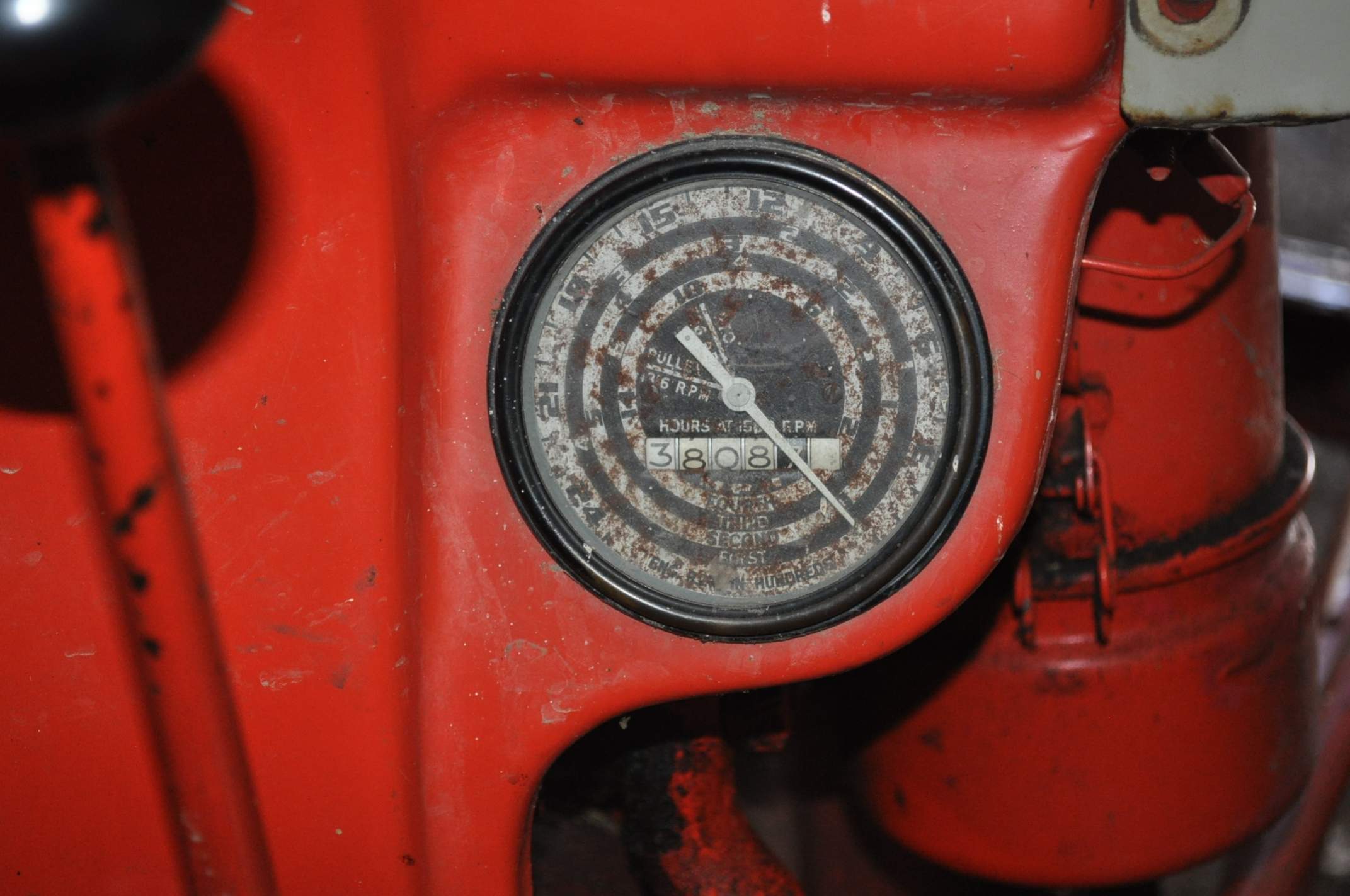

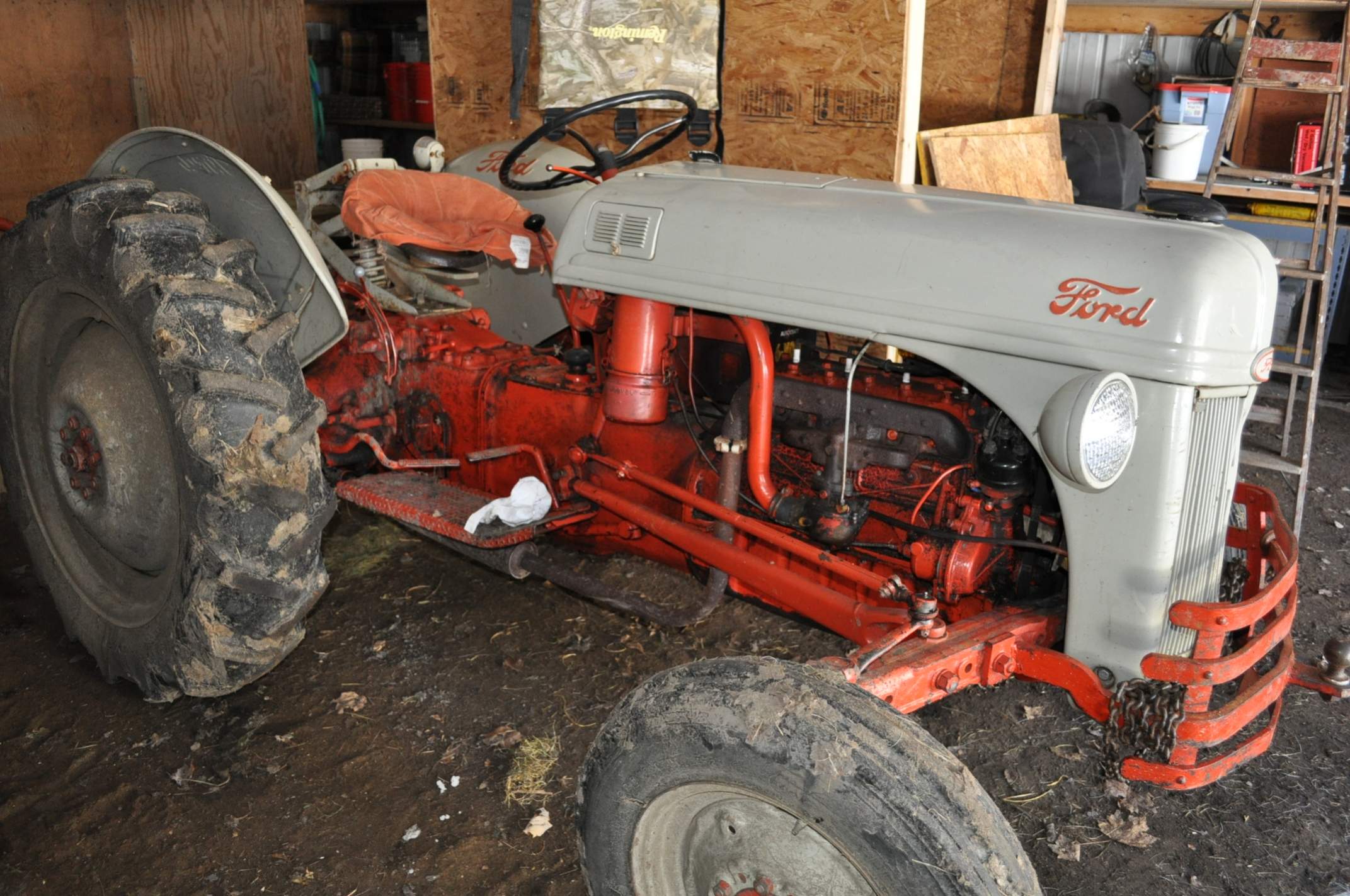

Some tractor ****, how does it look?

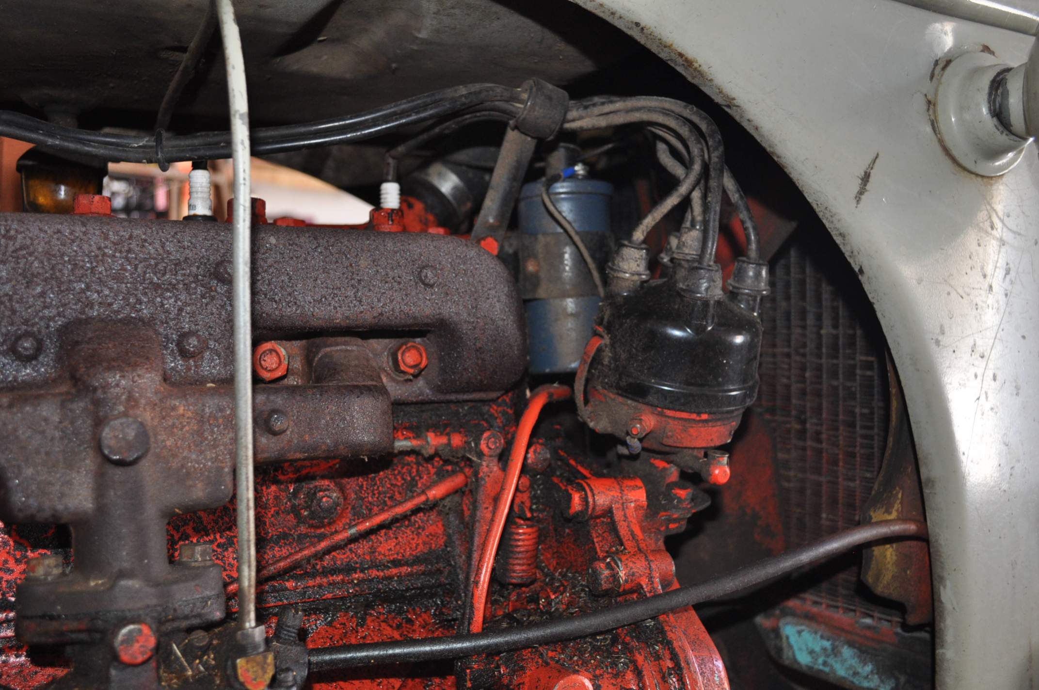

More pictures

side mount 8n.. no doubt about it.. hubs and brakes and hyds plus other details tell all.
