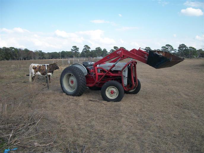

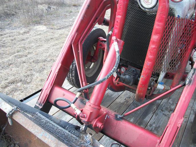

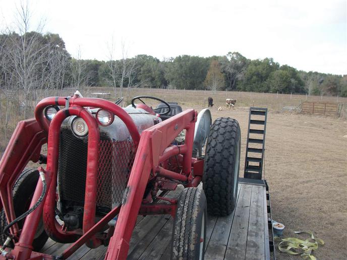

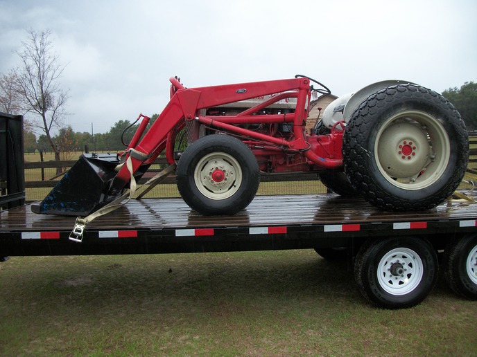

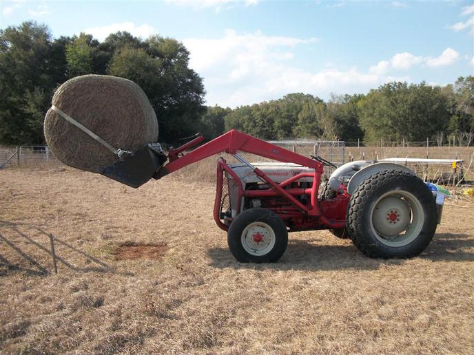

here are various shots of my superior loader.. as you can see it has a front stinger pump, 2 lift cyls, and a single bucket cyl.
I have since added a hay spear in the front bucket to lift hay bales instead of having to belt them into the bucket like that one.
also shows you how capable these laoders are.. even on the older tractors.
I just unloaded that gooseneck trailer full of 5x5 tightly rolled round bales of hay. I'd guess they were right near 2000# each... loader did it fine..
