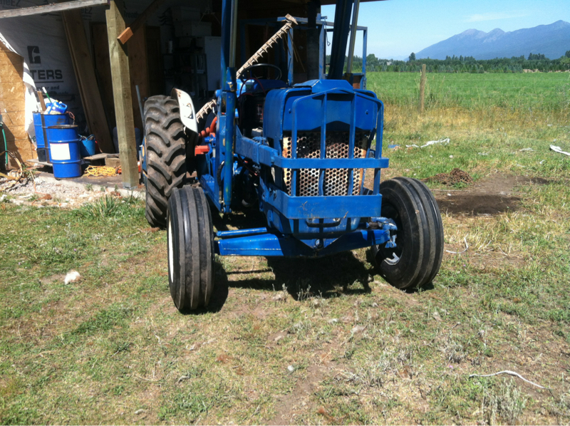

need to see some pics of this machine. a few things not adding up here.

Upon further review...... I took charcoal and rubbed it on top of the tabs the numbers are as follows
5C 315
5021G
C138473 6E10
Semper Fidelis - Freedom isn't free, to see the cost visit your local VA

So here are some pictures with out the hood off

/ Ford 3000???? Problems #20
well.. she ain't a 3000.
gear reduction rear ... and wet brakes.
heavy front bolster.. and that front axle ain't the 1939 design.. looks like some sort of industrial. I'm not up on all the 4 digit and 3 digit industrial variants.. but could be some sort of 3 digit industrial. front axle is deffinately not the ld fixed.. or the adjustable hd of a 4000 or a adjustable ld on a 39-65 00/01/2000/3000
a 445 is what really comes to mind... especially looking at front and back axle.
might want to bring in whodat and rickb on this.
