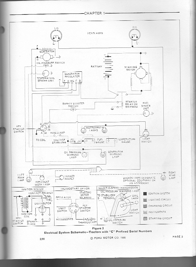

I'm having starting problems.
I'm looking for an electrical wiring diagram for a Ford Model CA213 C., 3000 series.
How many permissive switches are there?
   / Ford 3000 series, Electrical Wiring Diagram #2
My 1966 year Ford 3000 only has 1 safety switch. It's located beside the left hand gear stick and has to be in neutral before you can start it with the switch. No seat switch or seat belt on mine.
