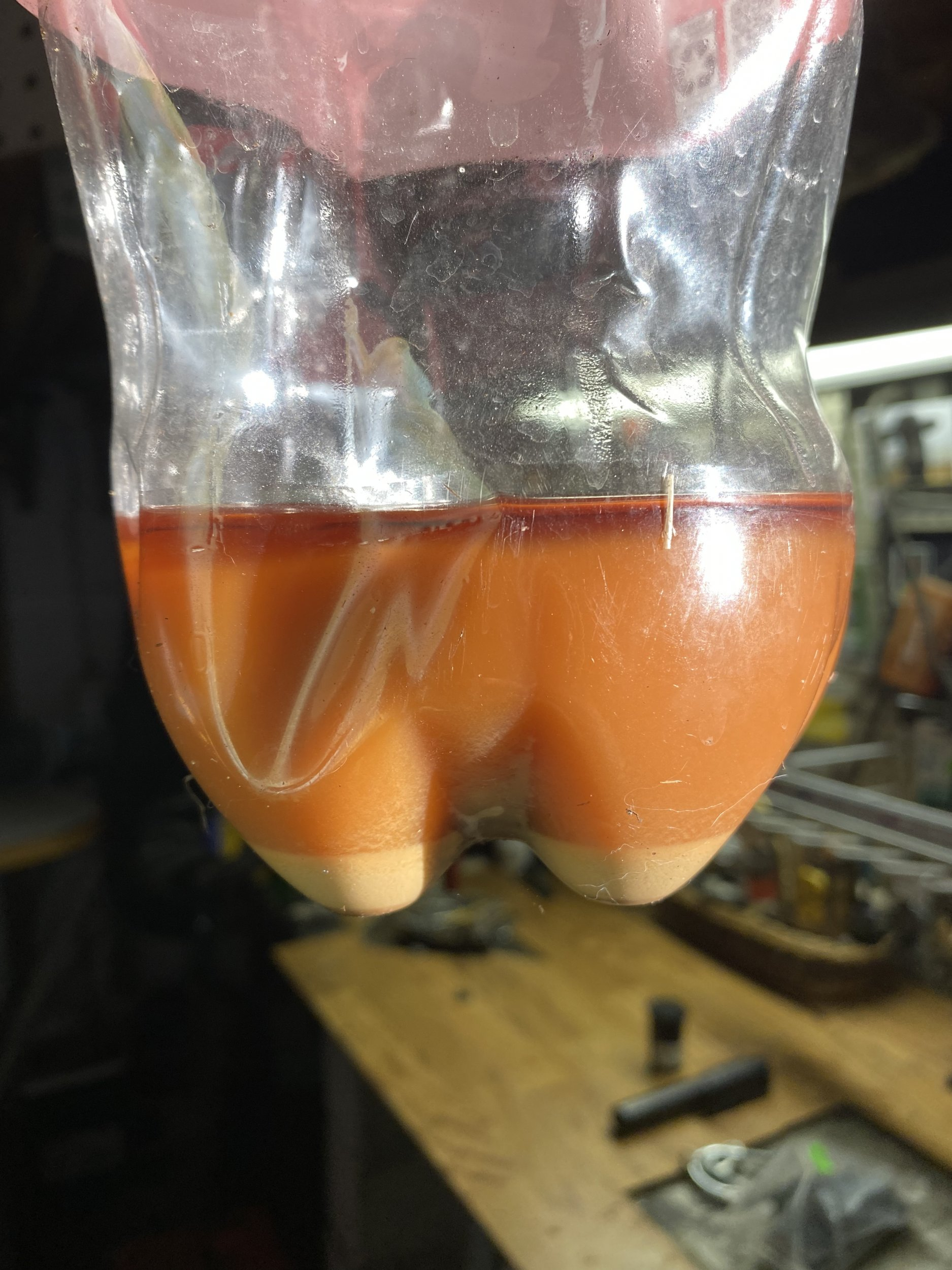

I had sucked some of the fluid out after I ran it last time after I change the hydraulic fluid and then I put it in a jar and let it separate for a week. I’ve been hoping that this is why the tractor barely moves and other times doesn’t move at all but I don’t think it is. Either way I have to get the water out and then I’m gonna start tarpong it until I have a place to park it where it won’t get wet. Maybe the transmesh filter in the transmission is clogged and that’s why doesn’t wanna move? I’ll attach a picture the Coca-Cola bottle is the fluid from the hydraulic reservoir that I changed like a month or two ago. I thought the hydraulic reservoir and transmission reservoir were connected because it takes trans hydraulic fluid but I guess they’re not? I bought the operators manual and the service manual. The operators manual has been helpful but the service manual is very complex and hard to understand

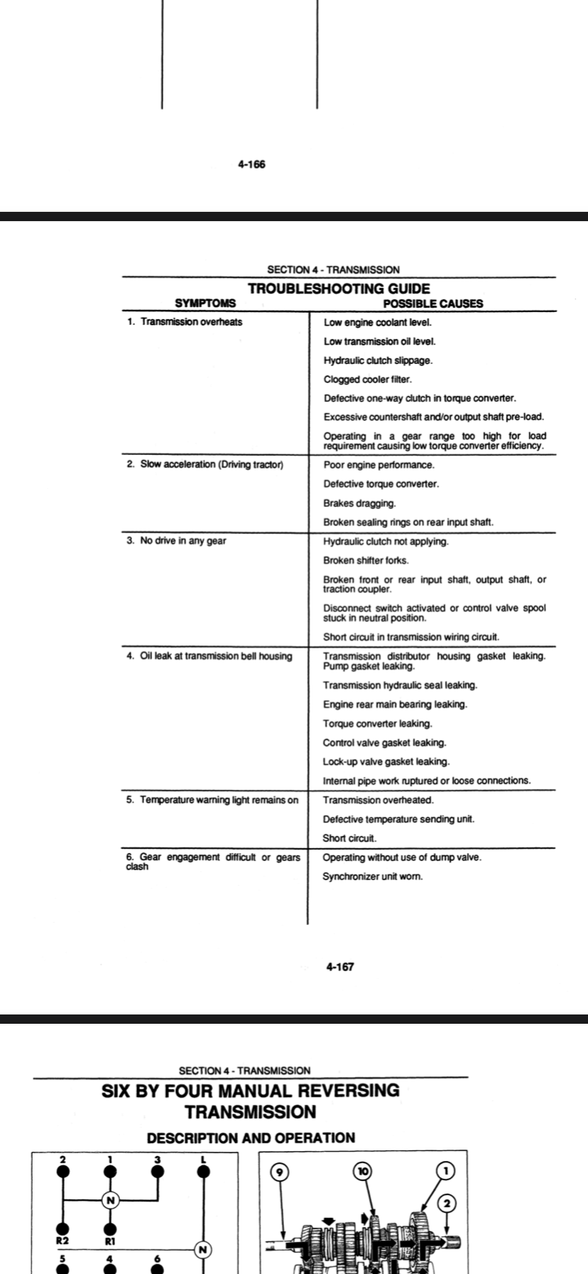

I wonder if maybe the hydraulic clutch might not be applying? It’s weird that it has moved recently but most of the time it will ever so slightly inch forward just a little bit then stop. It’s Almost like when I apply the throttle someone is pushing the tractor from the back but not able to move it much just rock it a little. I wonder if the screen in the transmission might be clogged? i think it’s called a trans mesh or something. I have got to get this working ASAP for our animal sanctuary. It’s killing us not having a working tractor. This tractor has me so frustrated, but I’m trying to read and reread to really comprehend but a lot of it is hard for me to understand. I’m an ok mechanic but no where near a professional. Thank you guys so much for your input , this community is amazing.

That wa5er could have froze and busted something. Make sure the trans fluid pick up screen is clean.Torque converter drain is facing forward on torque converter.

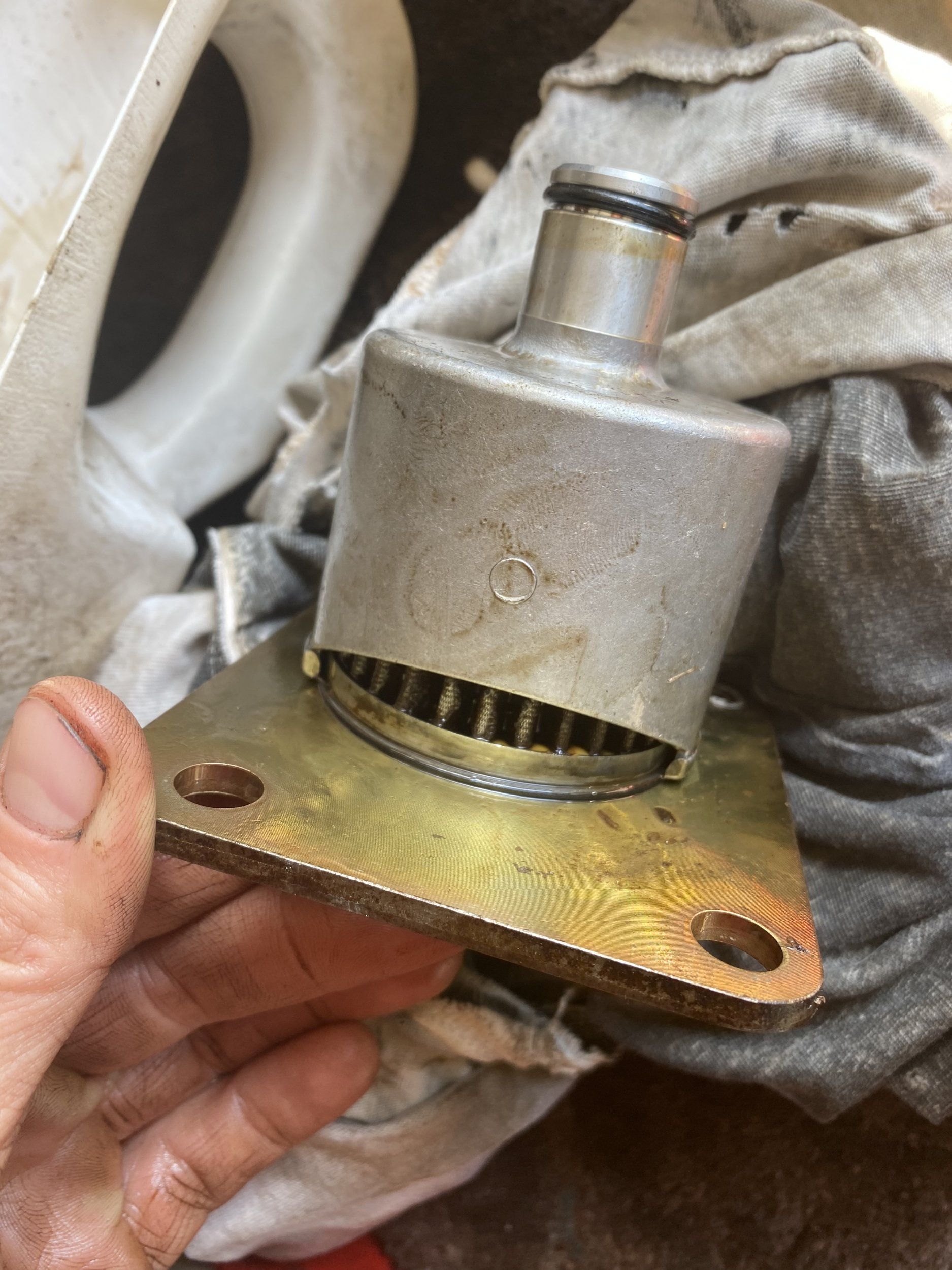

This is the transmission hydraulic suction filter screen. I don’t think it can be cleaned so I’m gonna call around tomorrow and see if I can find one. Any opinions on the possibility that this could be what is causing tractor to not move?

The oil sample you had in post #11 was completely water contaminated.

Ended up being the filter in the transmission. And the water in the loader hydraulics came out when I raised the loader all the way up to drain it. Thanks!!
