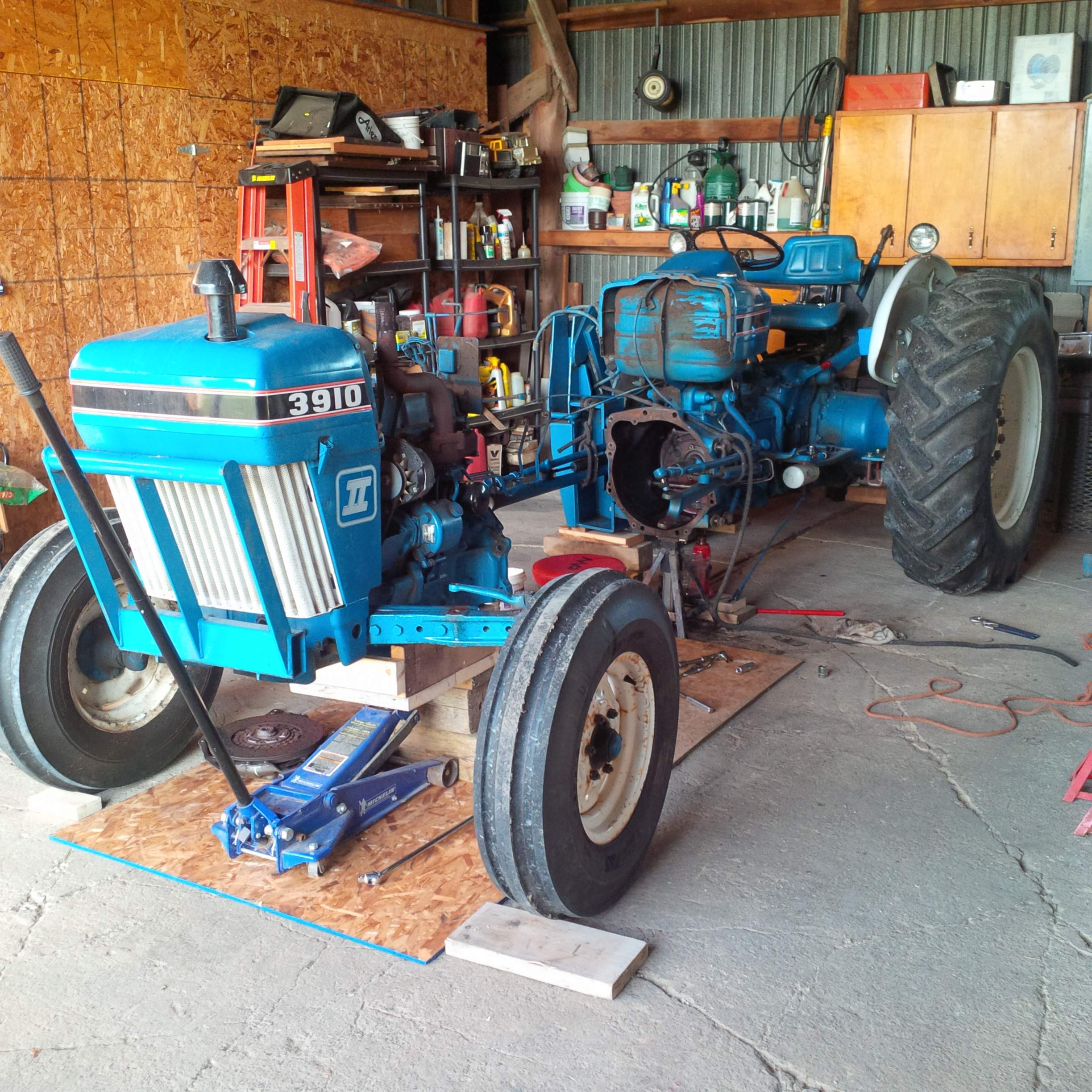

Thought I would share my experience swapping the clutch disc in my 1986 Ford 3910 (13" Clutch with IPTO). First off, thank you to member ovrszd for his thread, the photographs and advice were a big help. Overall the job went smoothly and was not nearly as intimidating as it appears. It took about 4 hours on a Saturday to get it split and the clutch apart (I am not a pro).
The problem I was having with my machine was most noticeable at high throttle it was very difficult to shift. You could push in the clutch and it didn't want to disengage, like something was dragging. I tried adjusting it as far as it would go and it still would not disengage fully. Problem turned out to be a defective clutch disc, the rivets were all loose, the friction surfaces had cracks in them and looked like in spots they were dragging on the flywheel. Total cost for parts was $580 CDN for clutch disc, 3 seals (1 engine/2 tranny), new radius arm bolts/axle bushing, cork gasket, pilot bearing, throwout bearing).

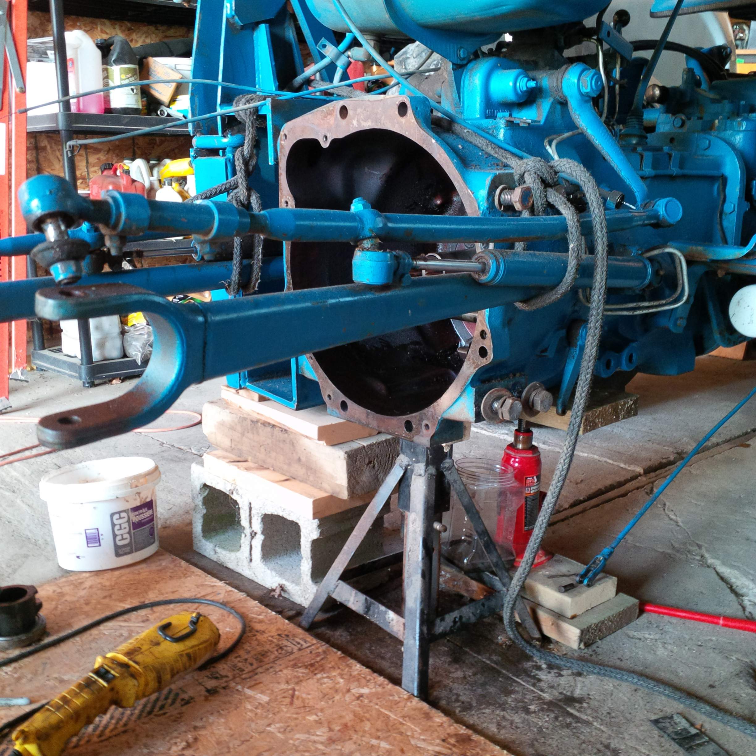

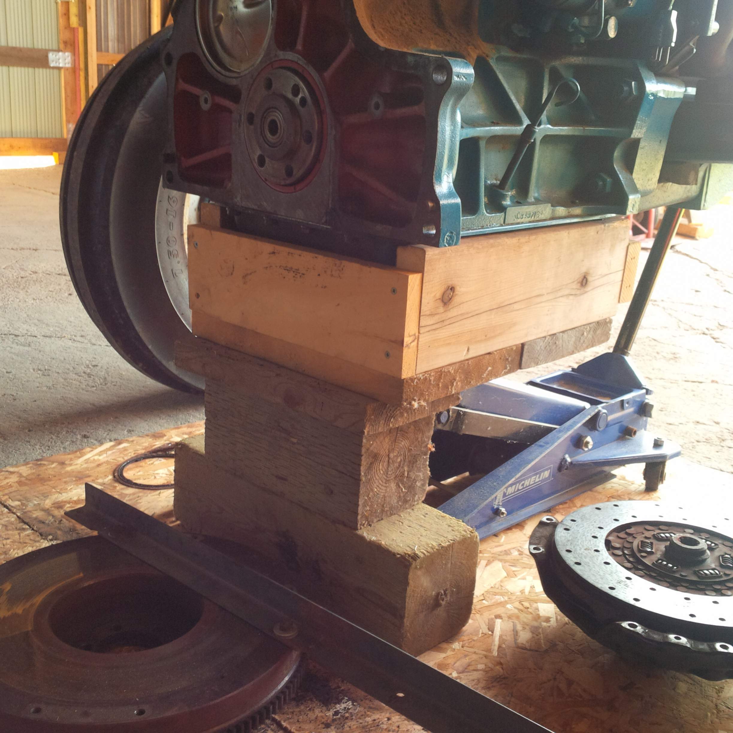

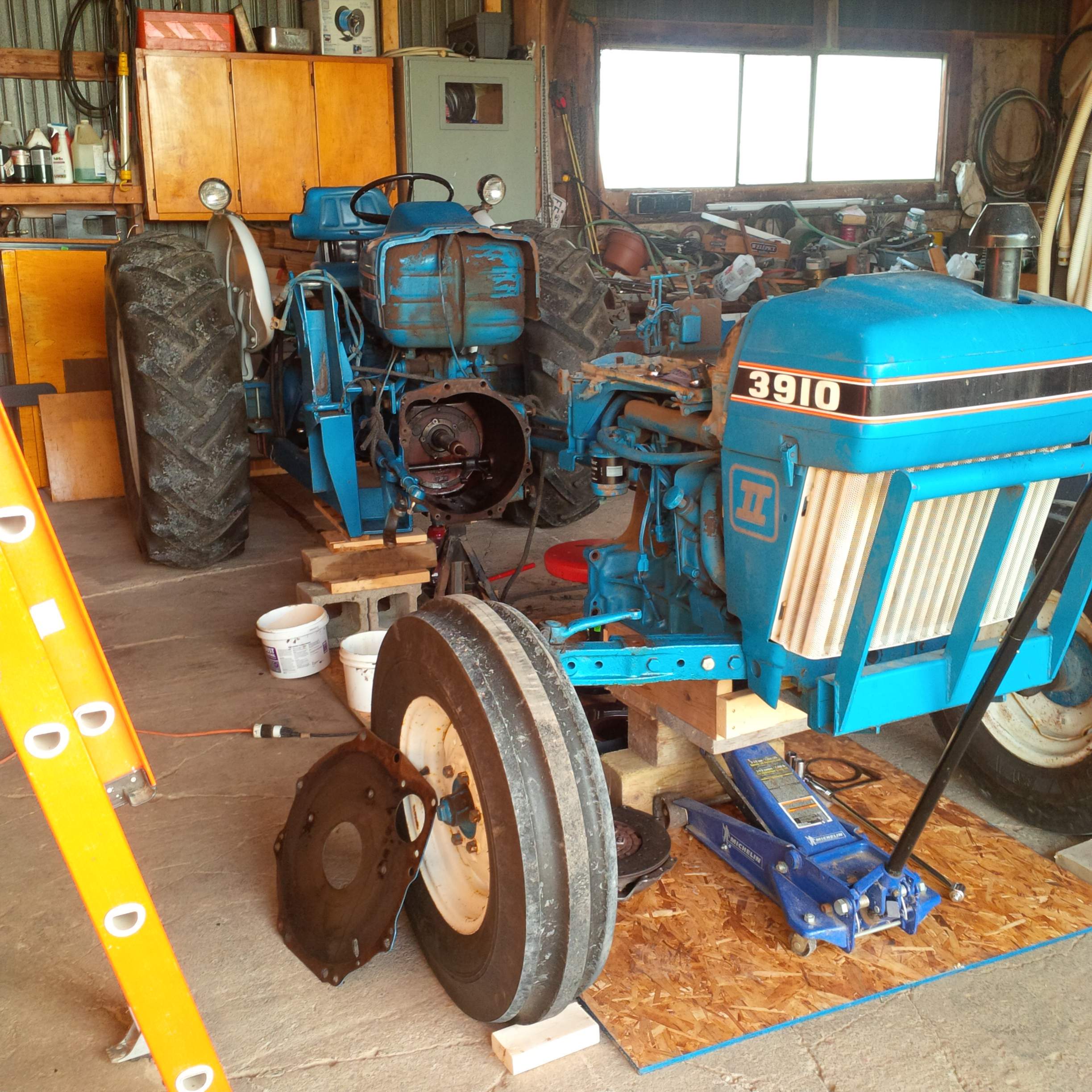

2. Splitting Supports
My supports were a lot less slick than ovrszd's (very nice job btw), but they did the trick and were quick and easy to build out of scrap lumber. I built a simple box frame that straddled the oil pan and allowed me good flexibility to use a trolley jack and blocks as required. I also pounded two hardwood shims between the front axle and the frame to keep the front end rigid so it didn't want to flop when torqueing bolts, etc.. I just used an axle stand/bottle jack on the rear end.
Some pictures post-split when I had the front end dropped onto blocks for working.

3. Watch your gap when separating
When you are at the point where you have all the bolts out and are trying to roll the two sections apart, take a look at the gap and make sure it is even at the top and bottom. I found I had to adjust my supports a bit as I was wider at the bottom than the top. Once adjusted it rolled apart really easily. Shouldn't need to put any real muscle into it.

I like your block setup!!! So by using the floor jack under the engine block you could lift enough to roll the front end on the jack and front tires. Very good idea.
I'm a metal guy and am always intrigued by what "wood" guys come up with. Looks like a professional setup to me. Bottom line is if it works, it's perfect!!!
