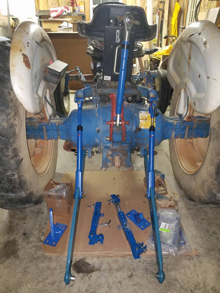

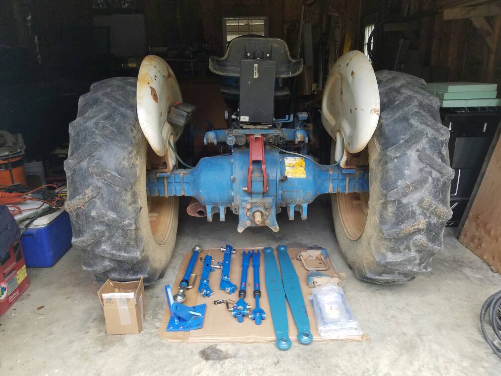

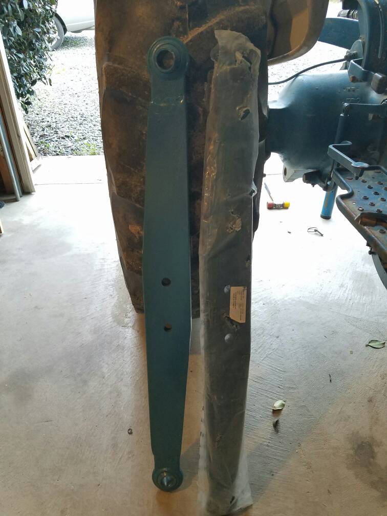

Got my parts today. :) So far everything looks great! The top link bracket looked like new and was real tight. I can't wait to get everything installed. Everything is so much more stout compared to the stuff on my 2600. This thing is going to be a real workhorse when I get it done.
   / Ford 3910
#82

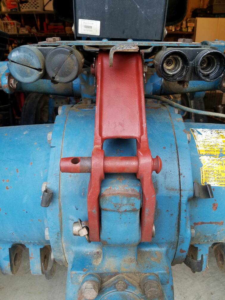

The top link is an older part, as it's lacking the higher connection point. It looks like it's going to work OK though. Plus, it was free.
Had to move the tractor to the garage at the front of the property so I could free up the garage at the house. Have to put a new transmission in my dad's truck.
I'm glad I decided to move it as it forced me to clean up the other bay so I can park the tractor there out of the elements till I can start working on it.

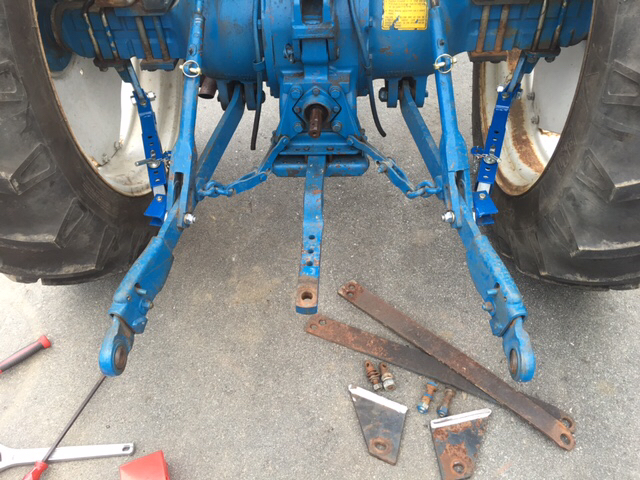

I got my stabilizers and hangers mounted yesterday. Old parts which were removed in pic as well.

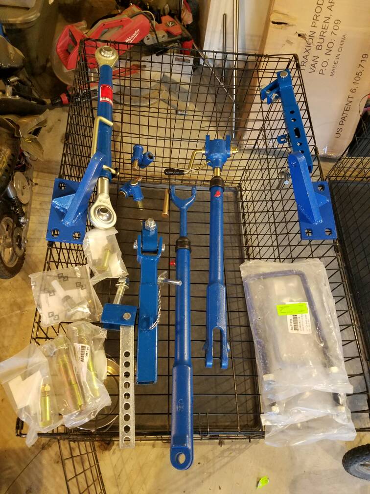

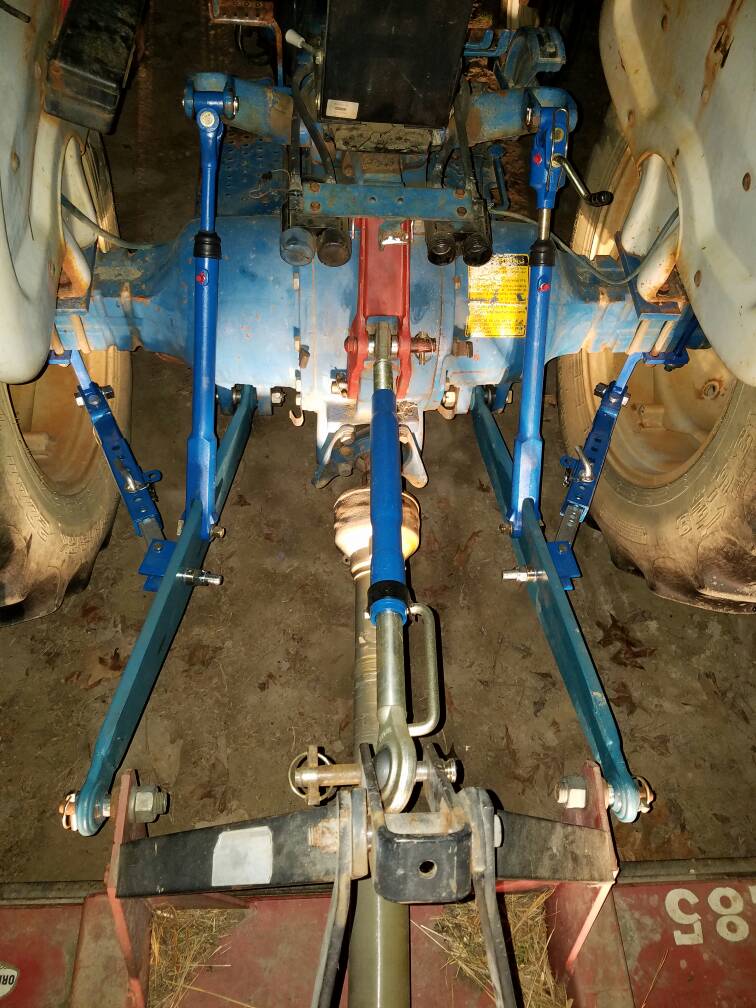

Got some of the hitch parts on to check fit up. Going to remove so I can put antisieze on the pins for the lower lift arm pins.
   / Ford 3910 #86
Got some of the hitch parts on to check fit up. Going to remove so I can put antisieze on the pins for the lower lift arm pins. <img src="http://www.tractorbynet.com/forums/attachment.php?attachmentid=465424"/>
The ole girl is getting spiffed up, nicely done. Isn't it fun when things start coming together?

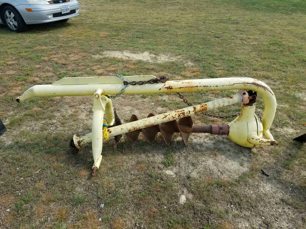

Absolutely! I just talked to a guy that had this for sale. Only wants $650 or best offer. I think it's a match made in heaven for the 3910 and my fence project. :)
   / Ford 3910 #88
Absolutely! I just talked to a guy that had this for sale. Only wants $650 or best offer. I think it's a match made in heaven for the 3910 and my fence project. :) <img src="http://www.tractorbynet.com/forums/attachment.php?attachmentid=465425"/> <img src="http://www.tractorbynet.com/forums/attachment.php?attachmentid=465426"/>
I've heard good things about Danuser, they still make the F8.
