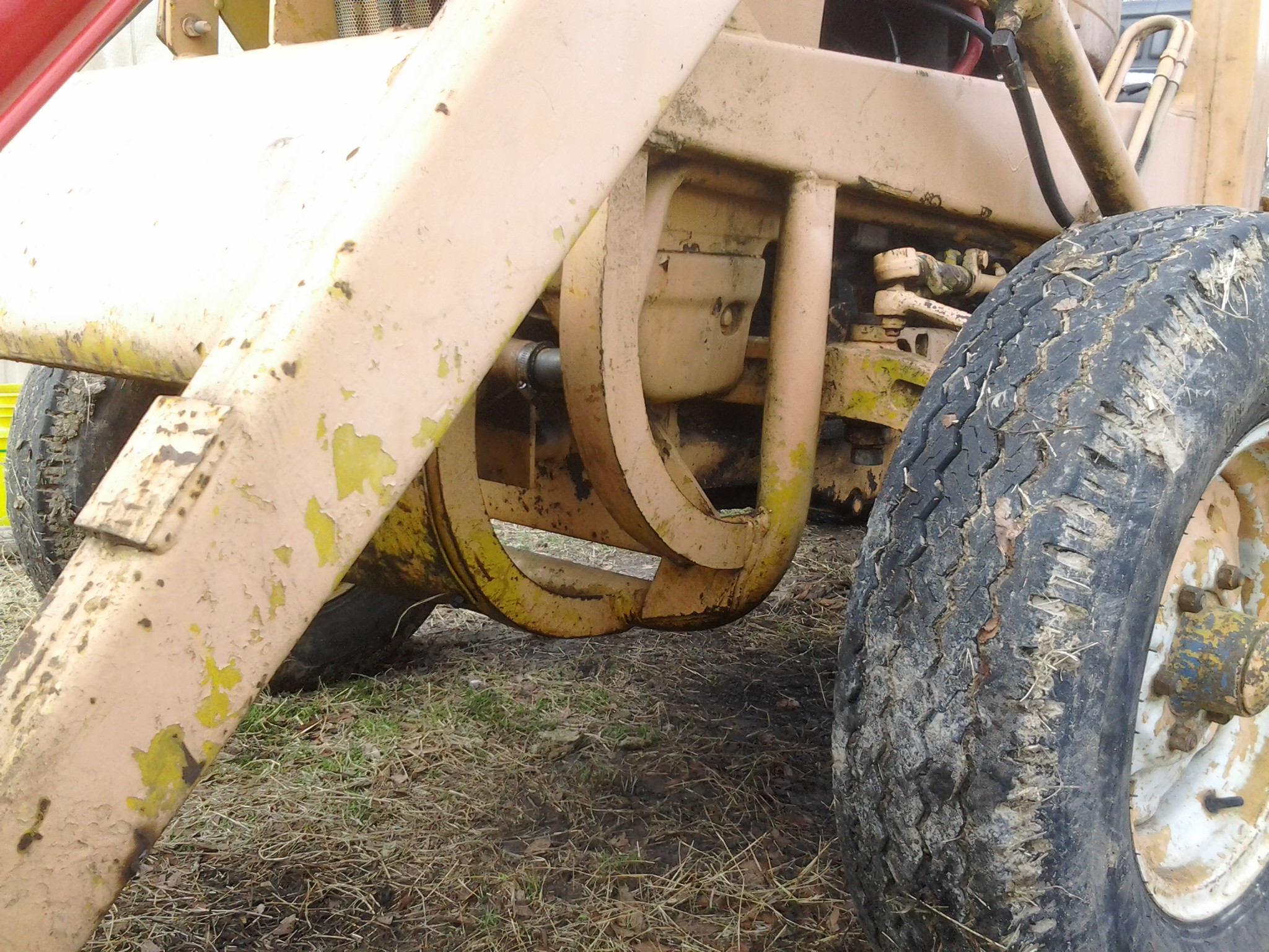

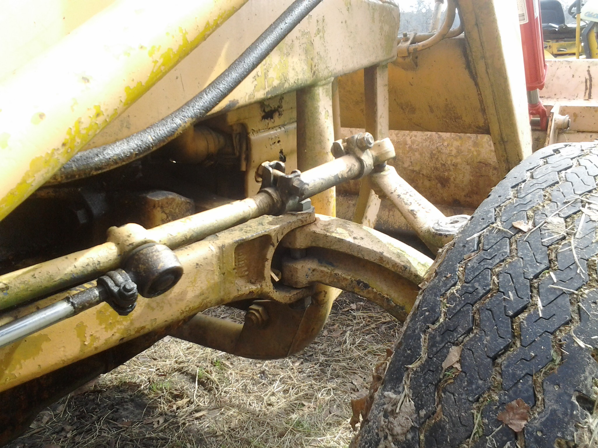

2 Front end pics which I hope helps. Im sorry but I don't understand radius rods. What do I need to look up please? Thanks

Its a Ford 4000 with a loader. The industrial 4400 has the solid front axle. Usually the tractor is Blue and the sheet metal/loader are yellow.
   / Ford 4000 3 cyl diesel NO STEERING #14
that IS a solid front axle!
   / Ford 4000 3 cyl diesel NO STEERING #15
I should've said its a 4000 with non-adjustable front end. He has spindle arms, drag links, radius rods and steering cylinders so it can't be a 4400 industrial.
   / Ford 4000 3 cyl diesel NO STEERING #16
edited
   / Ford 4000 3 cyl diesel NO STEERING #17
now that i think about it. a 4410 has a front end like that I believe.
