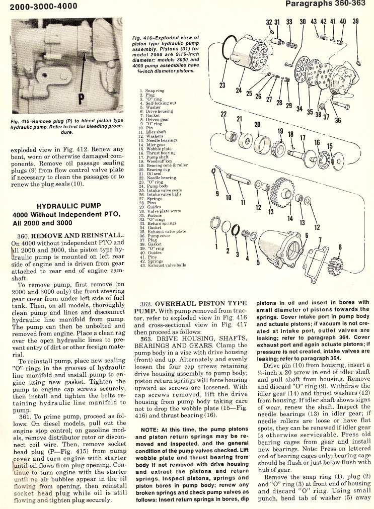

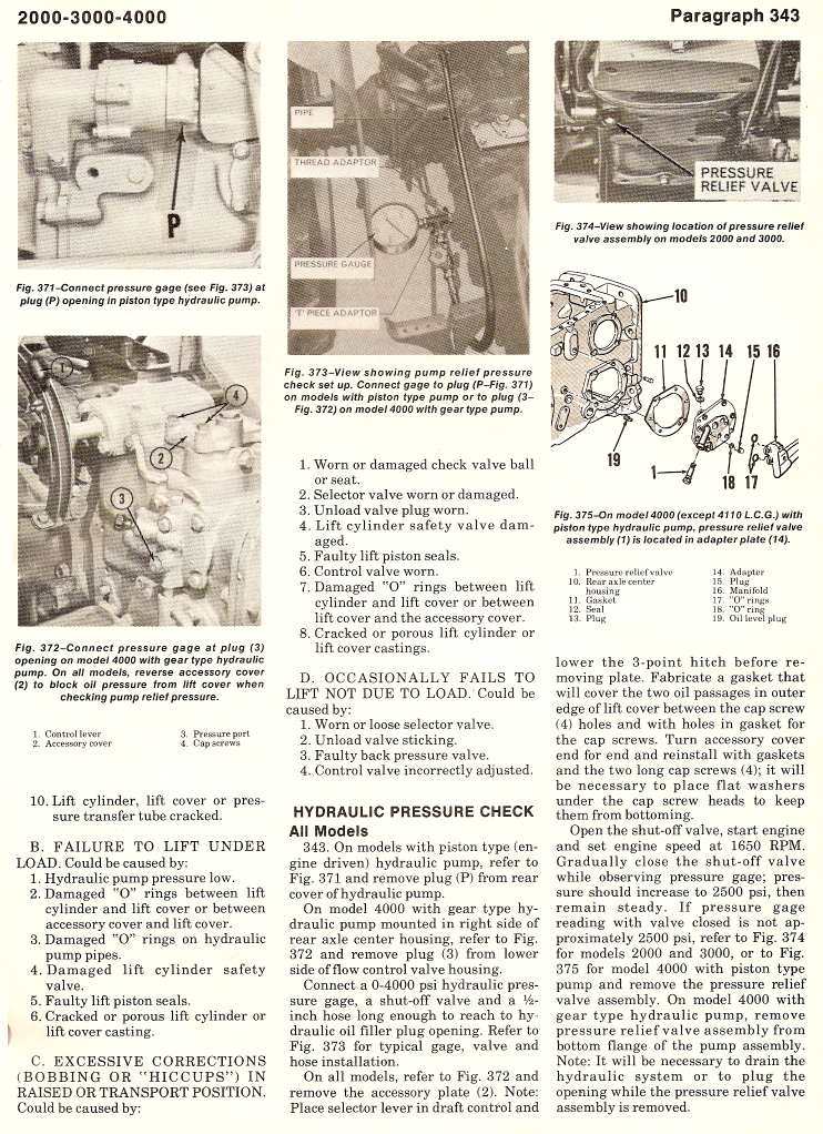

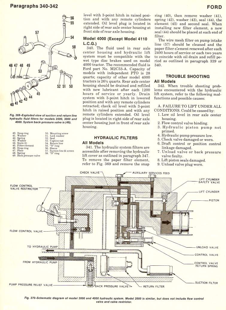

PAB_OH said:
Does anyone have a schematic for this machine or know where I can get one? He's a pretty good neighbor so I'm willing to get it on my own if need be.
Thanks for all the help so far guys.
Let me know if you still need it, I'll see if I can dig it up, I should have it down at the shop.
NV
   / Ford 4000 3 PT won't move
#17
namvet, yes please! I have one last week of vacation at the end of the month and I'm going to try and make it down there. I haven't seen my neighbor much lately since he's haying and staying at his farm through the week and most weekends.
As far I know it's not fixed. Appreciate the offer!
   / Ford 4000 3 PT won't move #18
Here is the schematic, there are about 7 pages total covering the hyd system, I'll UL another page and the pump and you can let me know what else you need.

Don't let the pic of the pressure releif valve mess with your mind like it did mine many years ago, it was taken from under the tractor looking up.
