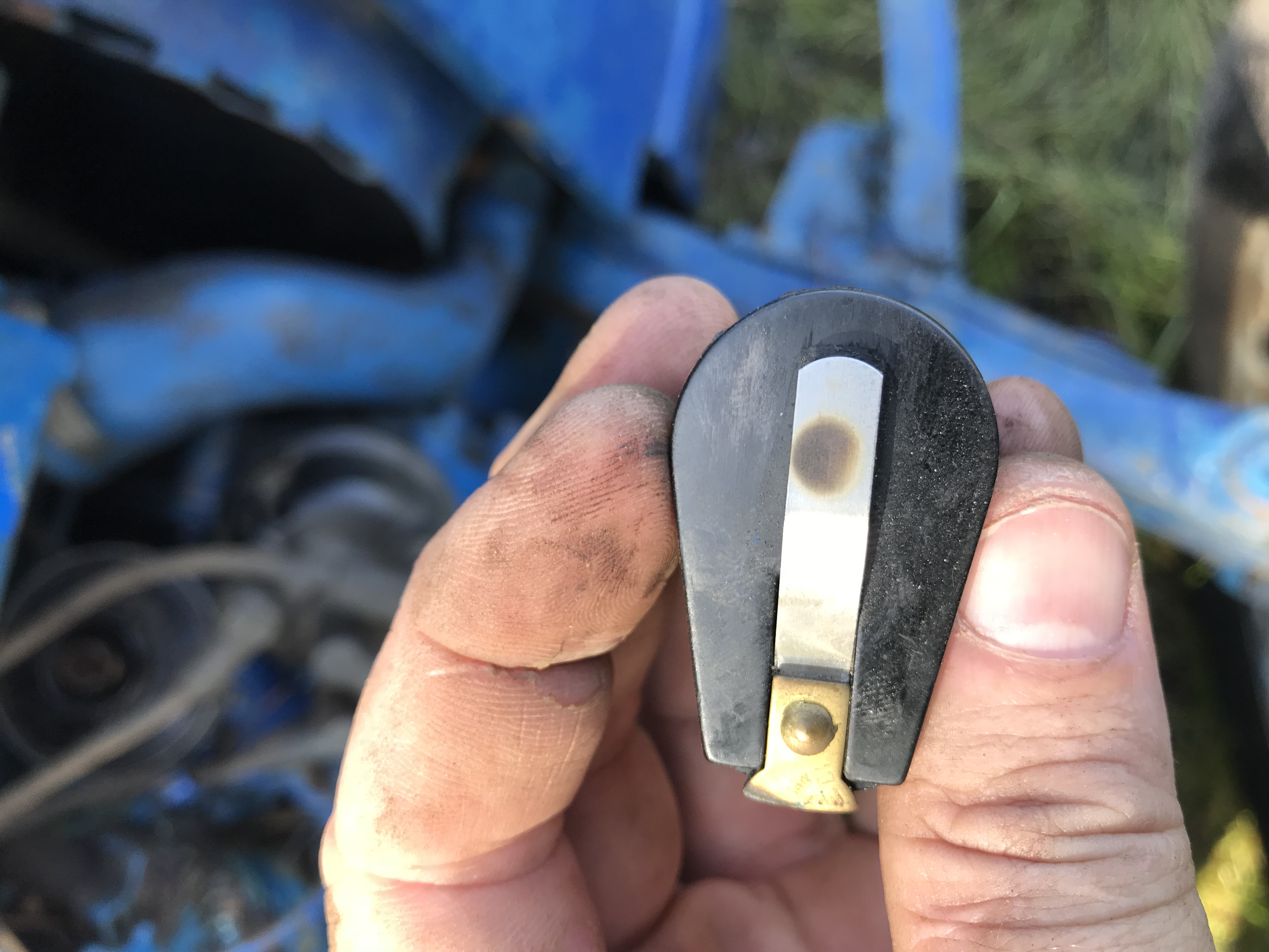

Went out this morning and it would not fire on the first 2 attempts. I unscrewed the bolt on the carb and gas poured out quickly, then went to a constant stream, I let it go 30 sec. Figured from there it wasn?t a fuel problem. I was going to unscrew a spark plug but the socket in my small travel kit was too small. So I pulled the distributor cap and thought it looked good, but then I noticed a black spot on the center contact. When I looked at the contact on top of rotator, it also had a black buildup. I scratched both of the black spots clean and put it back together. It cranked up after that.
Is that a sign of a failing coil or just a need to rebuild the distributor ? Seems to be a clue on why it wasn?t firing.

Now I’m wondering if opening the carb bowl drain plug had something to do with it since it would not crank, zero fire from start this morning and all I did was drain the carb and clean those black spots off and it cranked right up. Will take the right plug socket next weekend ��
   / Ford 4000 won稚 crank after use without sitting a day #5
Just have a philips screw driver handy if it doesn't start,
pull a plug wire off a plug and crank it over with the screwdriver close to ground and see if it sparks,
if it doesn't pull the coil wire off the cap and repeat with it.
If no spark at the plug but spark on the coil wire to the cap it's your cap rotor combination.
Just be sure she's in neutral while doing so.
Almost missed it your rotor isn't making a real strong contact with the cap center electrode,
you could tweak it up a bit to increase the contact tension

Very common for old style coils to fail when they warm up.

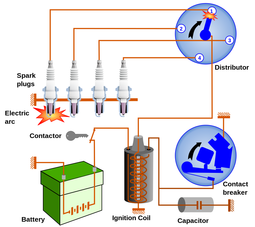

   / Ford 4000 won稚 crank after use without sitting a day #9
Have you checked for 12 volts on the low voltage terminal on the coil, left hand side of the coil in the picture;
1) key on not being cranked
2) being cranked over (two person or long clip on leads)
If that's good;
on the other side of the coil, the low voltage wire to the distributor,
while turning the engine over the voltage reading should be fluctuating from zero to possibly 5-6 or 8-10 volts
