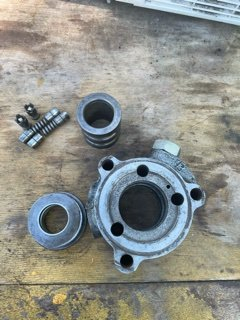

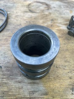

My tractor is a 1963 ford 4140 HD Industrial 4-cylinder gas with drag link assist power steering. I just purchased the tractor and have gone through everything that needed repair except no power steering. I have a new pump 1350 psi and have fixed all the leaks in the lines. The PO rebuilt the power steering cylinder and removed the control valve. The control valve C0NN3A730B has 3 plunger ports only, not 4 as in photo of a control valve that I have seen. I suspect that the PO of the PO may have assembled the plungers wrong. Do you know the correct assembly of the 3 plunger control valve (4 plungers, 2 springs, 2 horned plungers, 2 balls)? Also, which way does the center valve install? There is a groove on the inside at the bottom (or top depending on orientation). I hope you can help because there is very little info on this. Thank you

Thank you for the reply but my tractor is the heavy duty industrial with drag link power assist. I have tried the special plungers in every hole but still it made no difference. I have the FO20 manual and after reading it over again I'm going to start at the beginning and follow the procedure to disconnect the cylinder at the shaft and rotate the steering from left to right 6 times (or more) to bleed out the air. I have installed a 3000 psi pressure gauge in series between the pump output and control valve pressure port input but have yet to get a pressure reading when turning the wheel against the hard stop in either direction. It's supposed to be 1350 psi for the pump. I took a deadhead pressure measurement and only got 500 psi repeatable reading. I have fixed several line leaks in the steel hose sections of the PS hydraulic lines but I may have a minor leak between the reservoir and the PS pump so I will fix that tomorrow and update the thread in case it helps anyone else with their 1963 Ford 4140 HD Industrial tractor backhoe loader.

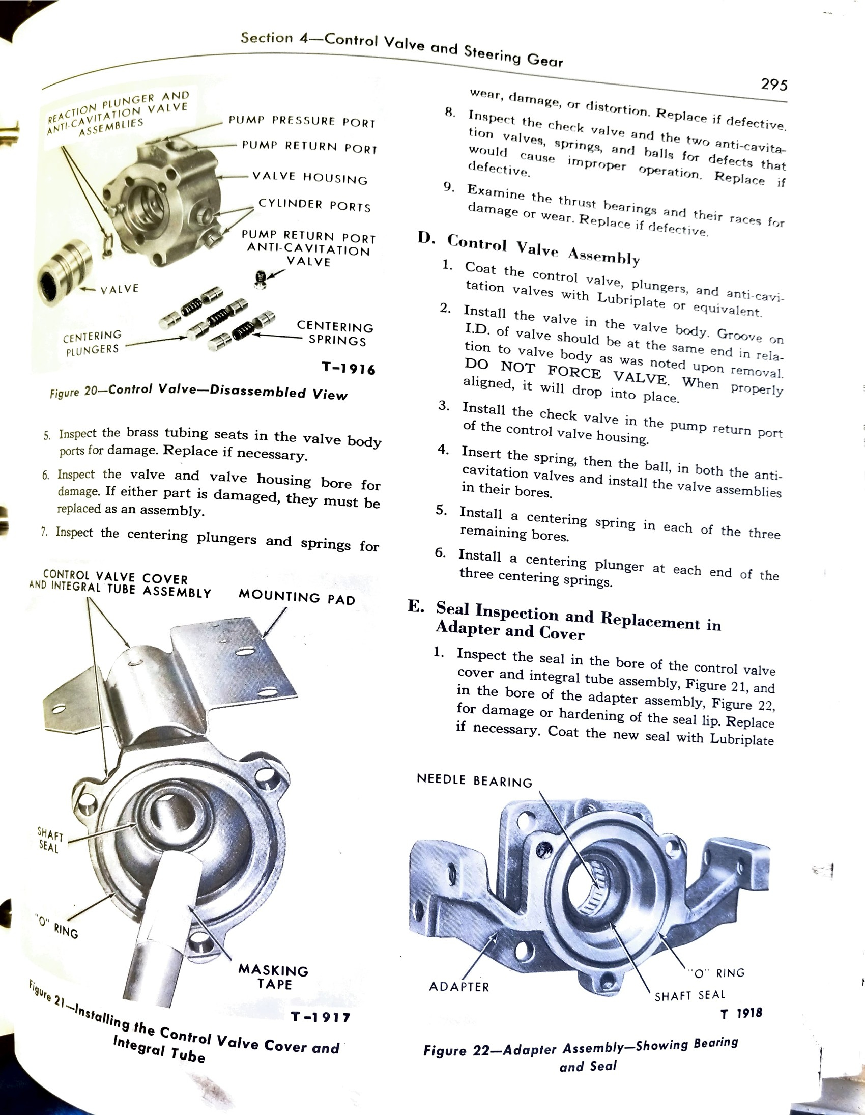

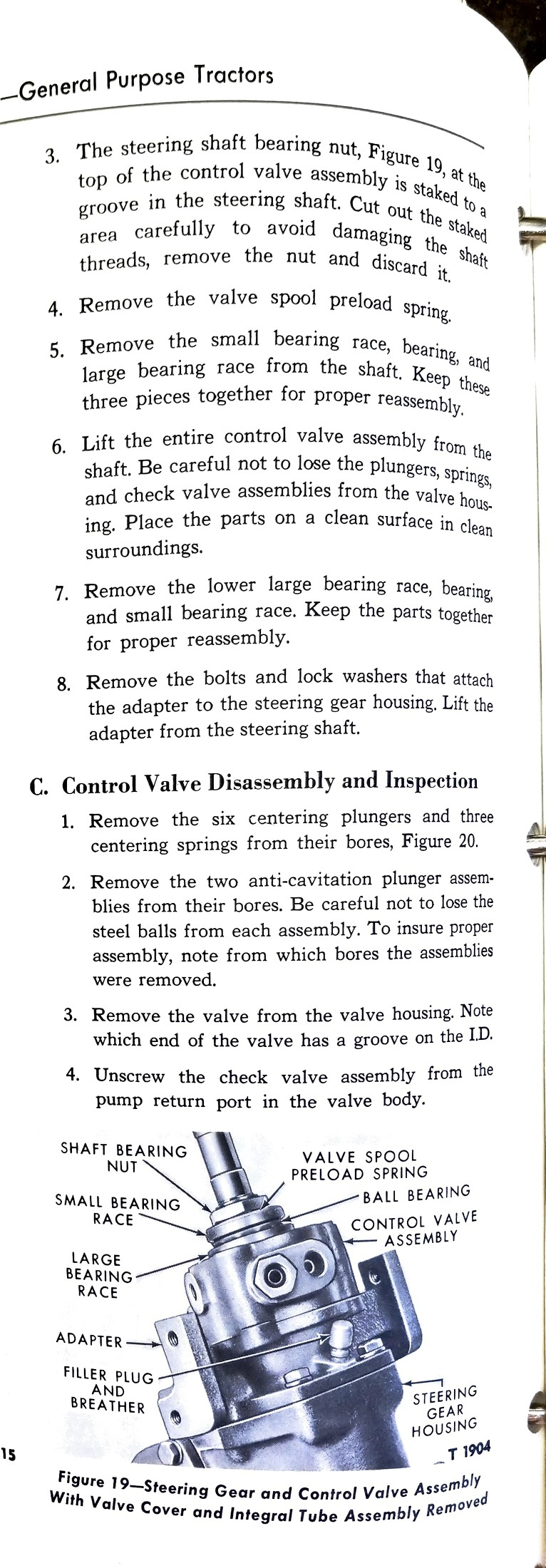

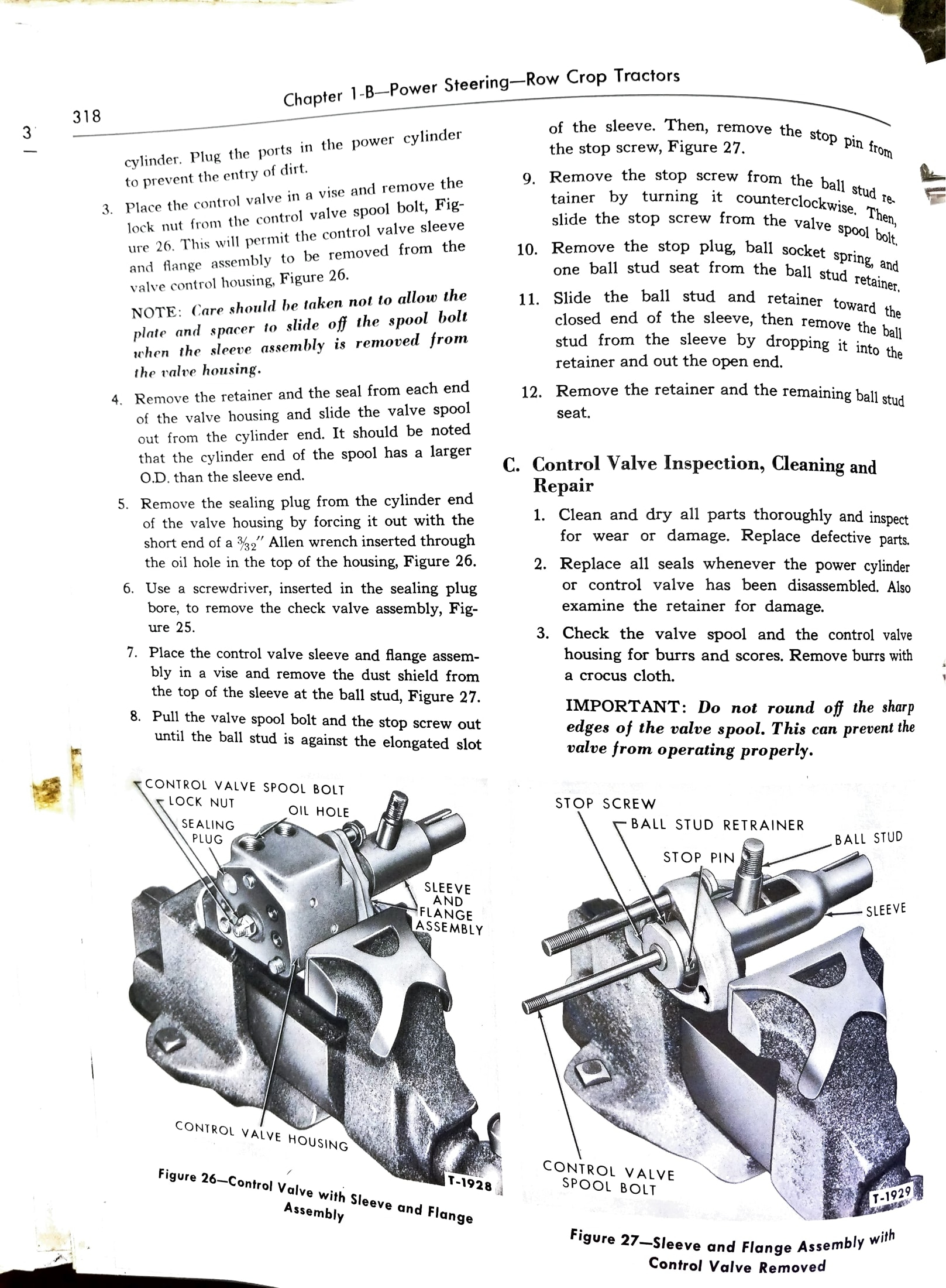

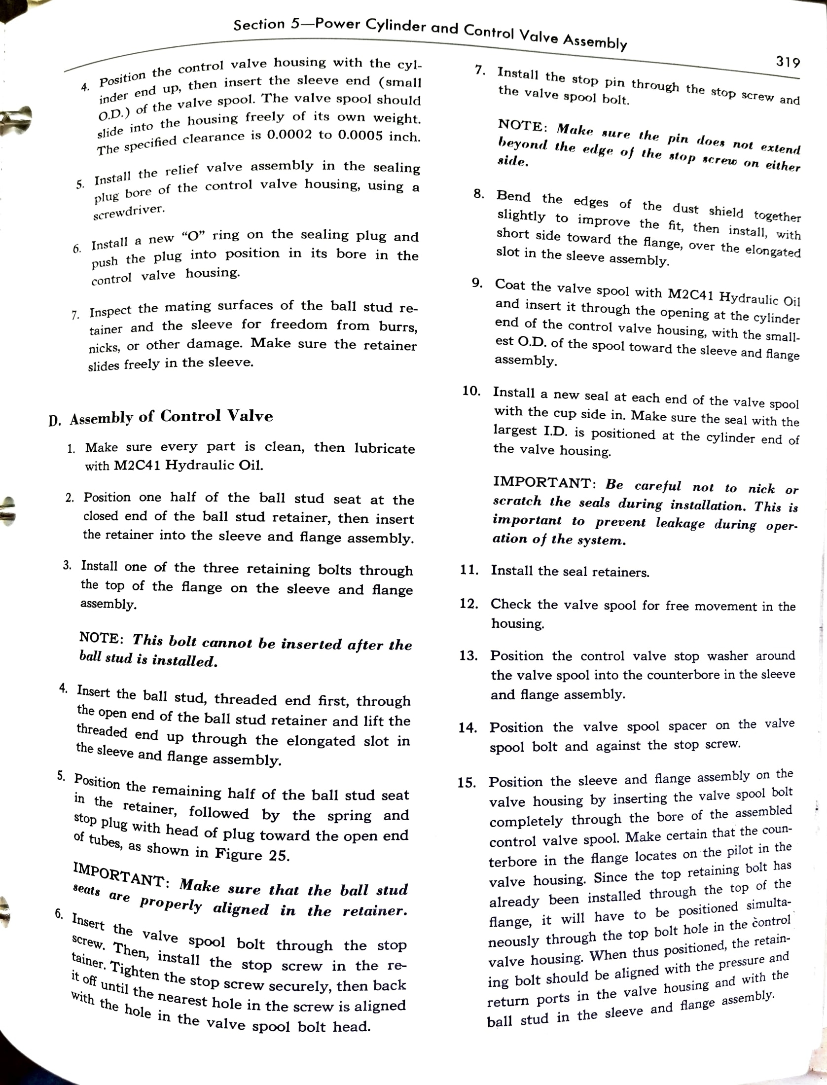

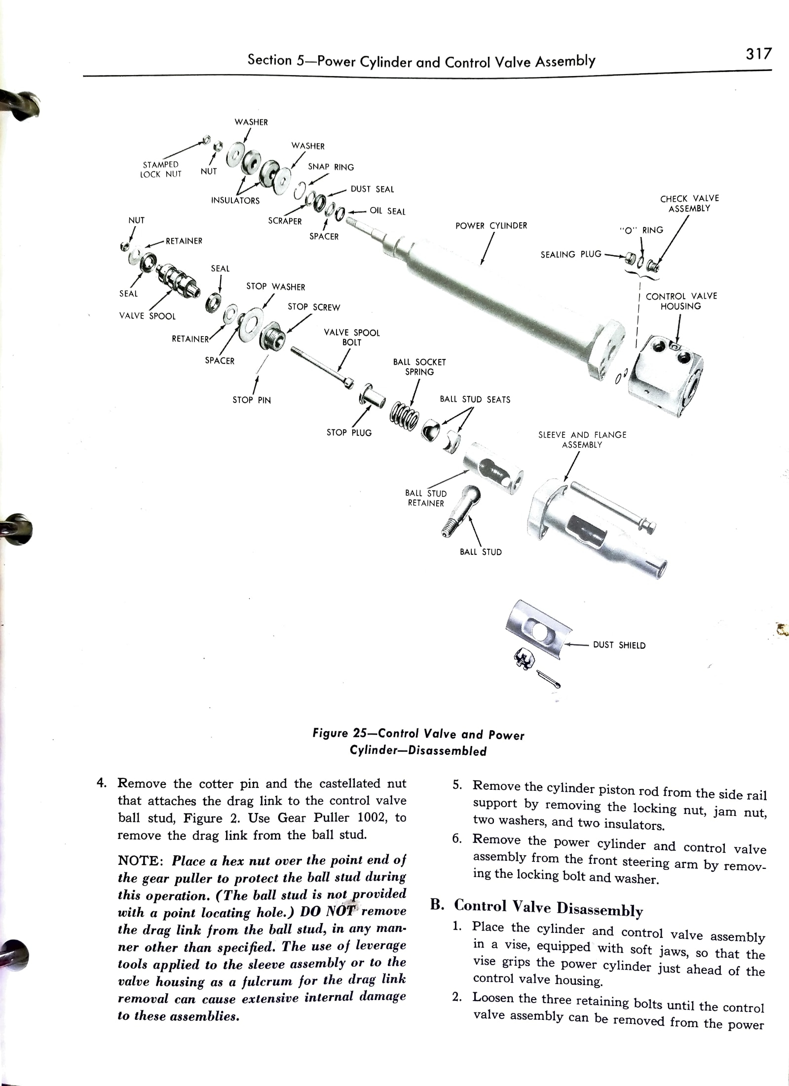

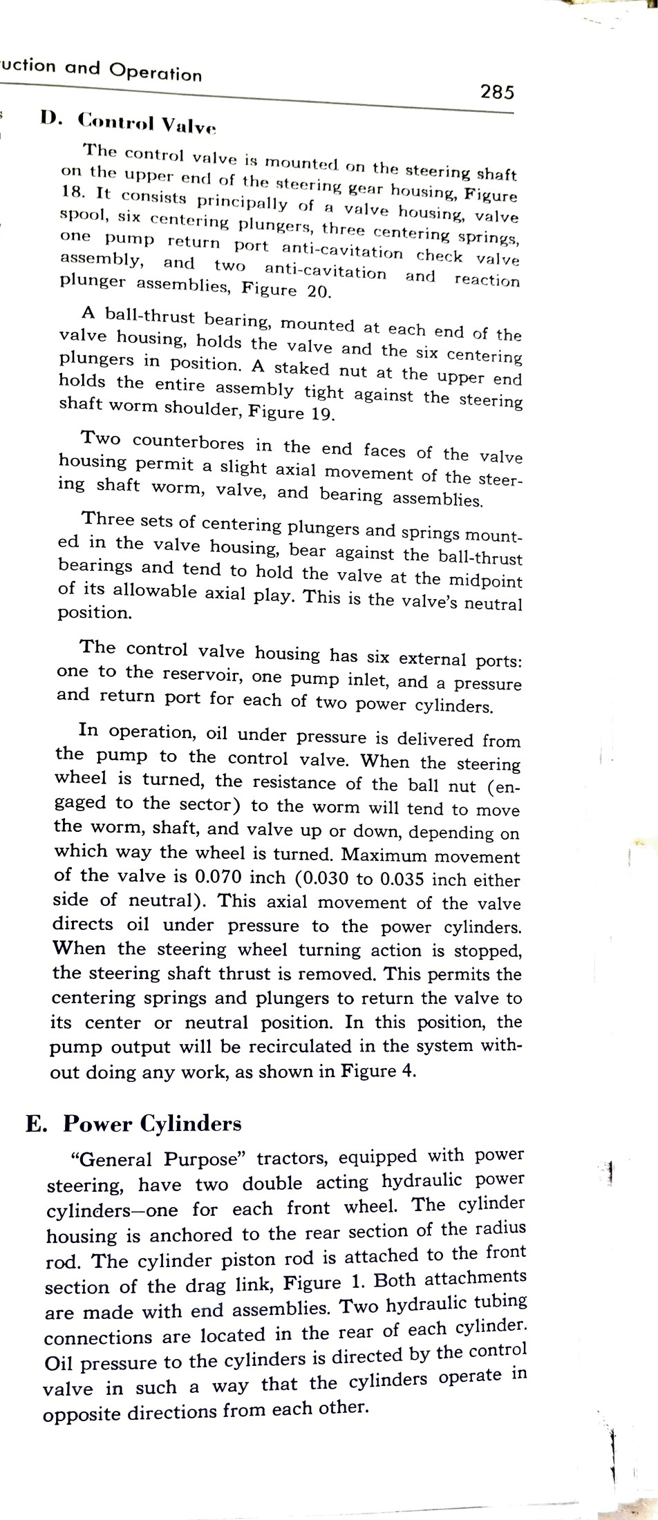

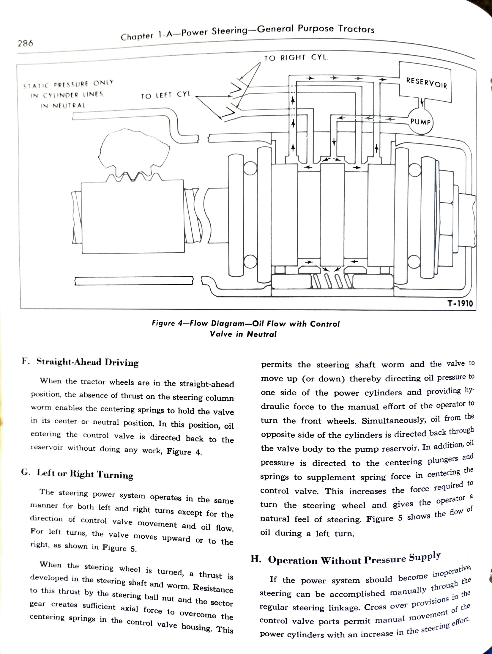

Got it. It is not an assist cylinder combo, but rather a gearbox assist. Here are the pertinent pieces out of the Ford SM

   / Ford 4140 Power steering control valve - which holes do plungers go?
I don't have a 4 bore control valve, mine is a 3 bore control valve as seen in the attached photos in my original post. The intent is to determine which plungers go into which bore hole and which way does the center valve install (groove down or up) because I have no idea if the PO or the PO of the PO messed with it. I know how it disassembled, I took photos. I want to eliminate the possibility of the control valve being a problem but I have tried moving the horned plungers around anyway with no effect. Also the FO20 manual paragraph 64 says that the pump return port anti-cavitation valve is not used on the heavy duty industrial tractor control valve and there was not one in my control valve return port. The manual does not show the 3 bore control valve and only states to reinstall the components in the order they were removed. This control valve has a pressure port, return port, and 2 ports going to the cylinder. I have verified all lines are connected properly. I'm an engineer for 40 years and can't stop until I solve a problem... it may be that the new pump is bad or it could be something else but I still want to know the correct installation of the plungers and center valve for the 3 bore control valve. I do appreciate your help... thank you
