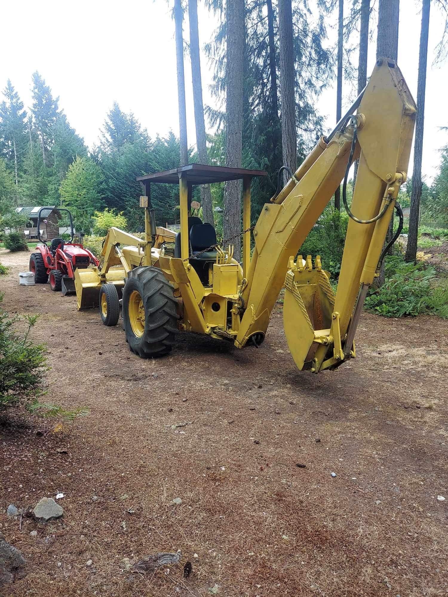

ford 4500 ind industrial is it vintage ? If so I’m prehistoric! Just want to know which forum for discussion?
/ Ford 4500 #2
/ Ford 4500
I would consider it vintage and yours looks like it's been restored or well cared for. Data on it here: TractorData.com Ford 4500 industrial tractor information

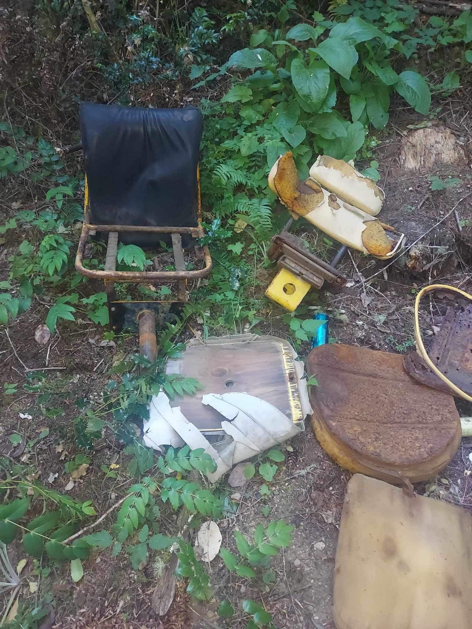

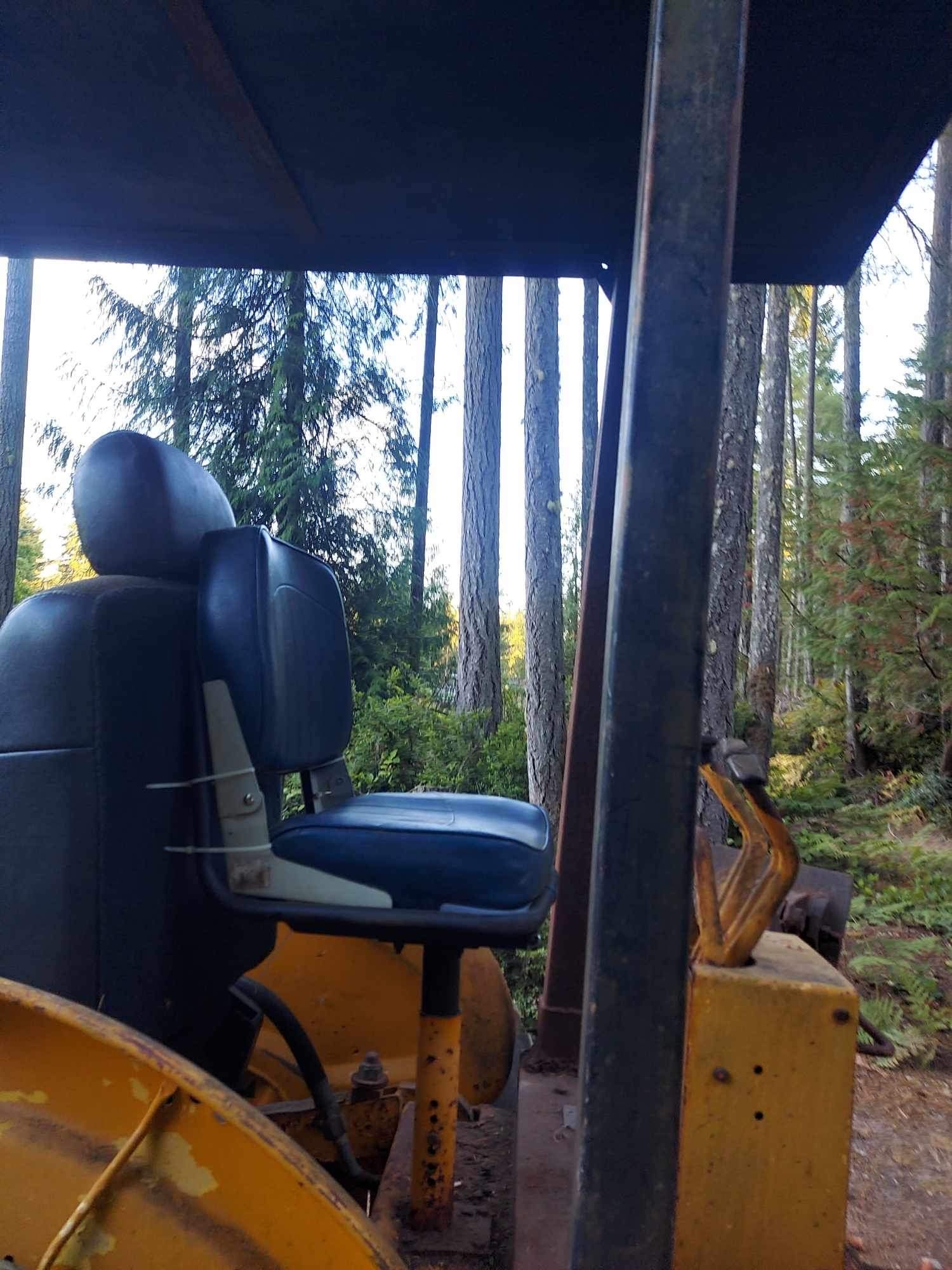

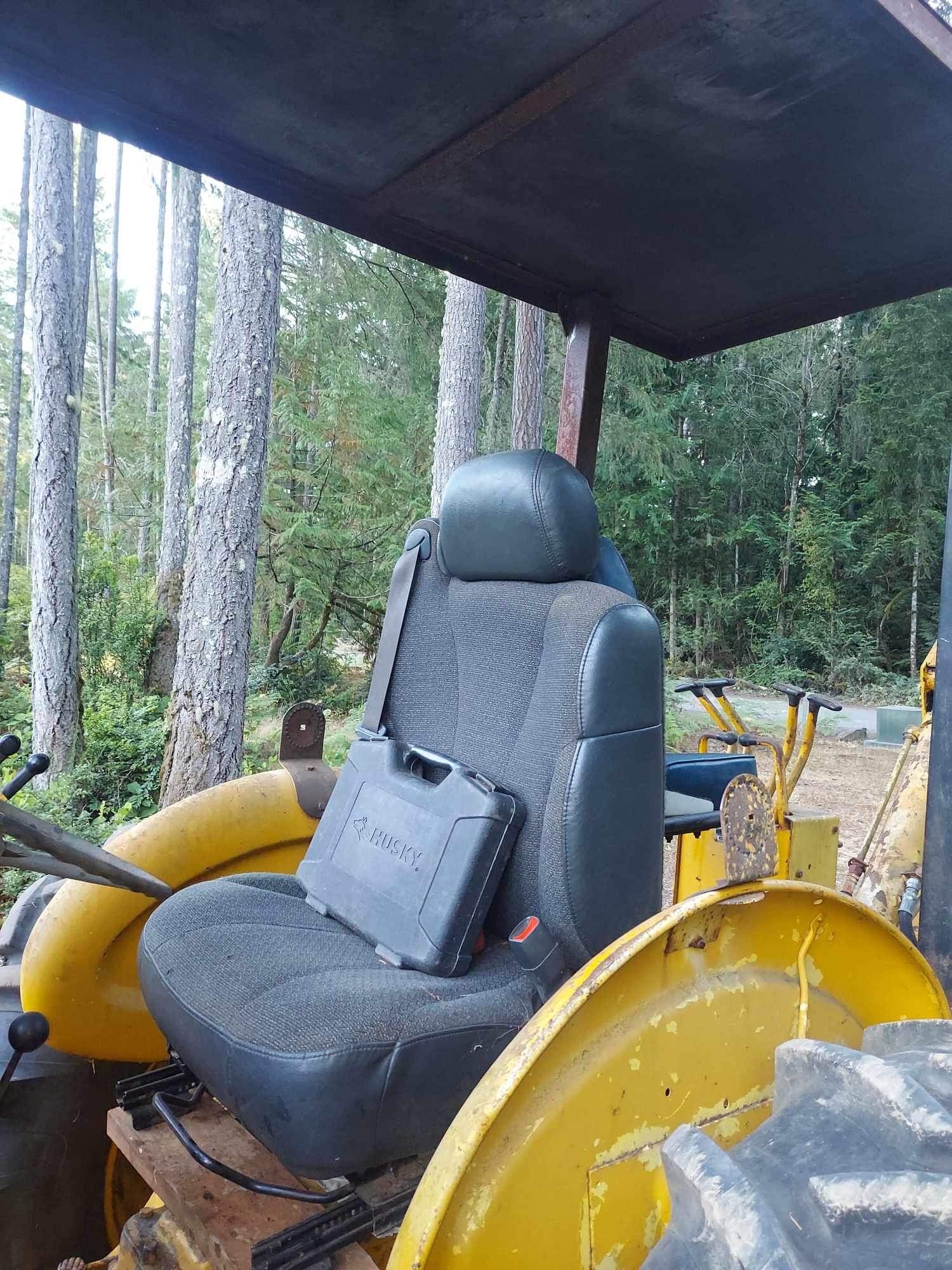

Not restored I did 100 foot spray paint job the seats were shot. I replaced them with a Chevy Silverado 50 bucks and one of my boat seats will be upgraded to black tie, wraps, added muffler, the gauge Consol wiring harness new starter , owner installed new injector pump. I put a Thermostart in. Don’t think it’s working right. Dug up my first stump with backhoe. Everything works good. Three cylinder diesel 740 loader 755 backhoe. I have about 3000 into it including getting it towed to my house I’m very happy very excited.

Is it just the angle of your first pic or is the backhoe boom that gigantic! LOL
Can't go wrong for that price.

15' digging depth backhoe and 3700 lb lift loader. This is industrial. It will pay for itself quickly.
