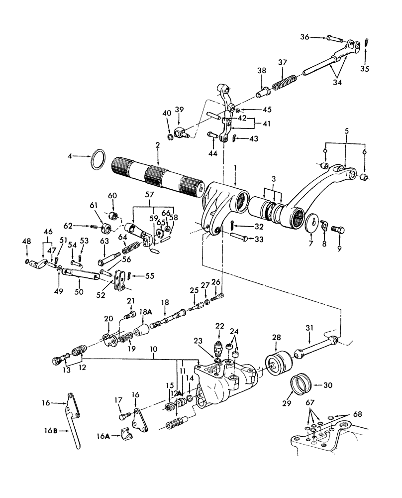

I noticed that under load when the lift lifts up everything is ok (floats smoothly, does not tug) but when it reaches the required height, it gradually descends and raises again. As a result, raising and lowering the tractor trembles so that it can not withstand it. What could be the reason? I will add that the tractor is equipped with a front loader that goes flawlessly .... (for those who do not know I'll add that this tractor has a lever under the seat to change the hydraulics (works or jack or turn)). I also know that the tractor has the regulation of the pace of the hydraulic pump, but if I did not set it all the time the front loader works without changes (it's ok) and the lift bounces ...
The oil condition when I check on the dipstick is ok (the tractor has the one behind the rear left axle).
I read was similar when the oil filter was changeable (but then they wrote nothing about the front loader) and in my case it was changed six months ago. Others wrote that in the manifold the valve was stuck (I think it's No. 27A or 24 in the picture No. 3). Still others that the manifold under the seat has been damaged (hydraulic switch for lift or turn).
I am surprised that the front loader works properly, and the lift tugs ... If the filter (No. 71 in picture 3) was to blame, would it be possible for the front loader to work properly and the lift tugged?

1. The interior of the tractor (from white plastic comes the lever to change tur / jack)
2. I have such a hydraulic distributor (except that I have a working pace in the cabin) (photo borrowed from the Internet)
3. Diagram of hydraulics and distributor (photo borrowed from the Internet)

My best guess is your internal cylinder/ram needs new piston seals. It's leaking bye then your position control tells it to go back up over and over. Just a guess though. Good luck with it. B

Can he be guilty of valve 27A?

I don't think you have to take cab off. By memory 30 yrs ago, you have to access it by taking the heavy cast top off the rear axle, first remove the seat. All linkages and hyd lines need to be removed that prevent removal. Cab probably makes more difficult. My old 3400 ford is the tractor I was into, no cab but similar. I'd make quite sure you think that's the problem before doing, quite a job to do especially with a cab. Might of been closer to 40 yrs ago. B

I have one more question. I thought about these cylinder o-rings, but it seems to me that if they were damaged (ie leaky and lost pressure) then after lifting the lift and turning off the tractor, the jack would drop down. In my tractor, the lifter with the connected machine when the tractor is raised and turned off, the lift does not fall down .... So it seems to me that it means that the o-rings are not broken ...
Well, unless it's wrong?

Yes I would have to agree if the 3pt arms stay up maybe settle slowly over time with a load this is normal and your seals are most likely ok. What have you got mounted and trying to lift? If it's a back blade or anything that is used above ground you should be using the position control lever which is the outer most one. The inner lever is your draft control and is used for soil engaging implements such as a plow or subsoiler tooth, it maintains a selected draft load on your soil engaged tool. Maybe you know this? For just lifting and no need for draft control leave the inner draft control lever all the way down and only use the outer position control lever. Just want to make sure this isn't the trouble. B

I think 99% is a valve, but which one? 27A? Or maybe the hydraulic switch has been damaged and is he responsible for that?

I guess ar this point I would pull your selector valve and flow control valve, one at a time and carefully take them apart and look for any worn seals, weak or broken springs, hairline cracks in body or build up of sludge/dirt. I've never had either one apart so I'm not real familiar with the tear down. Does the flow control (F-S) rotate freely? Also the selector valve, is it getting full movement when you switch from loader to 3pt hitch? One other thing, do the position and draft levers move freely and independent of each other? B

Where to start checking springs / o-rings? from the valve under the seat or from the distributor whose diagram I added in the picture (in the picture in the lower right corner)

Good question, was hoping for simple fix. I've owned a few ford tractors but none set up with that selector valve. All of that vintage did have the flow control (f-s), never had any problems with it so kinda blind to their workings. You might pull the 25 and 21 plugs on the flow control and have a look at the Springs , plungers, orings and also just to see if everything is clean. Same with selector valve. Maybe somebody with more knowledge or has had this same issue will chime in. One other question, what is the little blue lever in first pic under seat? Never had that on any of my fords either. The next time I'm at my new holland dealer I'll ask one of the mechanics their opinion of your issue. B

Tomorrow I will try to undress number 25 and 21 and see if this is something ...

Looking through the diagrams I also found one valve that can cause my problem is the valve n 22 of the photo which he adds in the attachment. What do you think ? The question whether to get to it just unscrew the selector, do you need to raise the entire elevator cover?schemat zawor w plecaku.png

Pic #2 is a flow control valve, my ford tractors all have this exact same flow control valve. I don't know what the small lever in your first pic is, do you know? What does it go to on the other side of shroud? To get to #22 I think you have to remove heavy top off rear axle. Yes I will ask my dealer mechanic the next time I'm there, I've been extremely busy, can't get out of the field. B
