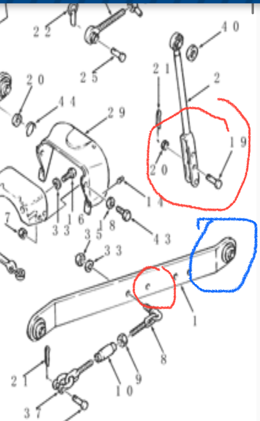

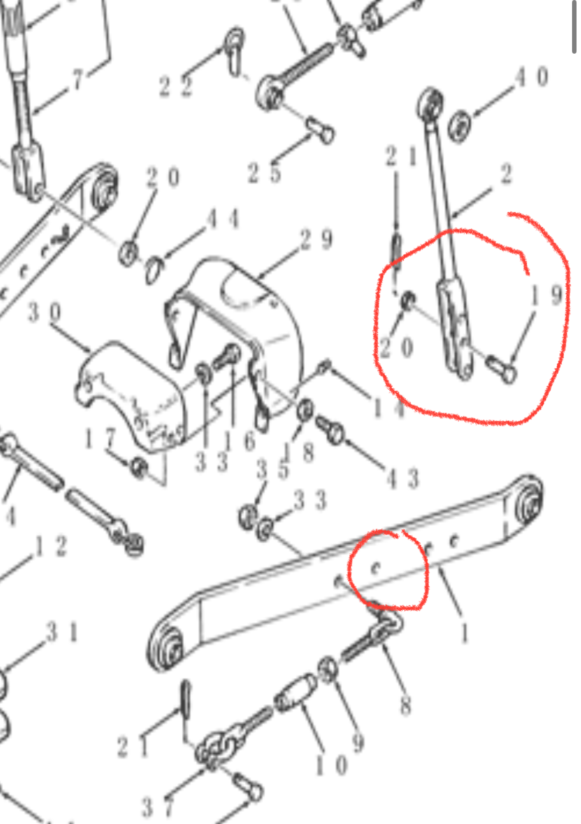

The lower lift arm is the last mechanism before the load.
It’s a solid bar with a fixed pivot point of rotation, at the end closest to the tractor, as I circled in blue.
Everything before that… between the hydraulic cylinder and the lower lift arms are irrelevant if nothing else is changed. Doesn’t matter if there’s four bar linkages to top links, or a nuclear powered gear train, the resultant lifting force is inversely proportional to the mass distance from the lower bar’s axis of rotation.
Top links are only motion control links, and can effect the angle of the lifted object, so yes have effect , once the object is in motion, but to have motion, the lower lift arms must first have enough force to lift the load
