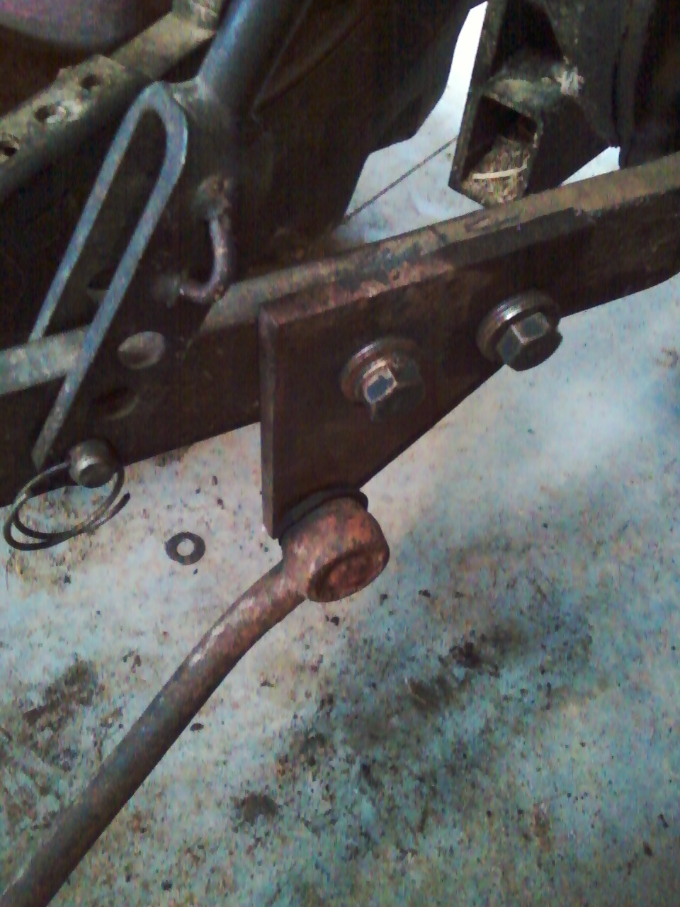

Looking to do my own hay next year and just picked up this Ford 501 7ft sickle bar for $75 - pretty good deal in my area. The seller said it he used it last year and it worked well. Looks like it needs a couple of teeth, but otherwise in decent shape.
Got it home and unloaded and can't seem to make sense of how it mounts on the tractor. I have a Kubota L3710 with a regular 3 pt hitch. From the looks of it, there are 6 points of attachment on the sickle bar. It looks like maybe something for a stabilizer and something else to raise and lower the bar. Can I just run it without the other attachment points? I've attached a picture of it.
Hope it's not a stupid question, but can anyone tell me how this works/offer suggestions? Thanks!

You can download the operators manual from ntractorclub website for free. It will have the instructions on how to mount the mower.
   / Ford 501 sickle bar help #3
I have one just like that. It is a really nice mower. It is hard to tell from the picture, but it looks like you are missing the arms that clamp onto your tractors lift arms.
To hook up the mower:
1. Connect lift arms and top link
2. Connect stabilizer arms (one on each lift arm) tighten clamps with a wrench
3. Raise mower and install pin connecting linkage from top link to the big spring.
   / Ford 501 sickle bar help #4
I have one also. It should hook up fine to your 3 pt, but it looks like your missing the top link on the mower. It should have a solid top link that attaches to the main spring.
It looks like you have the left arm clamp that supports the cutter bar, but it looks different than mine. It probably doesn't matter as long as it can attach to the 3pt arm. It's hard to tell from the picture, but the right side clamp is missing. This isn't a big deal as long as your tractor has sway control.
The bar is supposed to be raised and lowered manually, but maybe yours is modified. If you can't find a manual online, I've got one I can post. Take some time going through the user manual and make all of the adjustments. My mower cut like crap until everything was adjusted right.
Hopefully Sweettractors will be along soon. He is a dealer and seems to be an expert on sickle bar mowers. He was a lot of help to me and probably a good source for parts.

Thanks for the help everyone. I went to ntractorclub and found a manual - that will be a lot of help.
Looks like I'm going to have to find/make that top link, but other than that I think I'll be able to make it work. My tractor has the lower arms with drop pins for stabilizers l so I won't worry about the right stabilizer. I'll make some sort of clamp for the left stabilizer.
Sweet tractor is just down the road from me. I think I'll just run over there and take a look at the mowers he has and ask some questions. Maybe he'll have a top link.
Thanks again - I'll post again once I get it up and running.

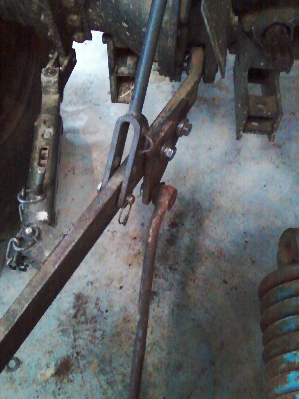

Got the sickle bar going the a couple days ago and thought I'd share the results. I managed to do it without getting any new parts. The end of the push rod on the left side had some contraption that the previous owner had used for his tractor. I took that, cut some things off of it, burnt another hole in it, and now it will bolt onto the lower arm of the 3 pt on my tractor. Works great! When I raise the mower, it multiplies the lift and raises end of the cutter higher. Here are a couple pics.
