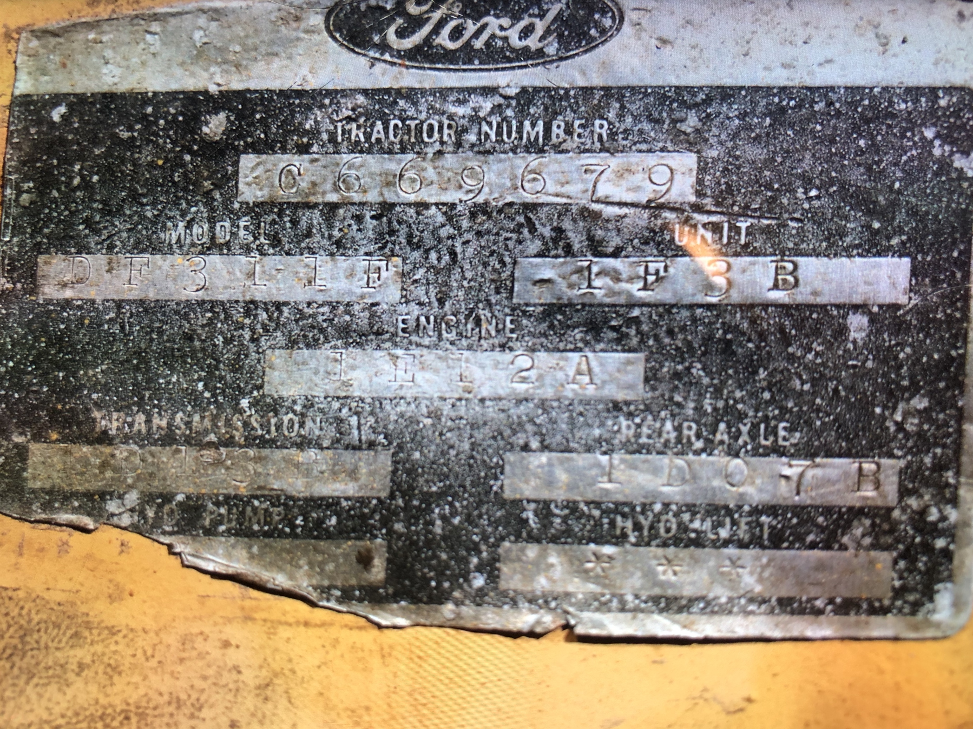

Jun 30, 2018 / Ford 555 identification #1 D damato333 New member Joined Apr 6, 2013 Messages 12 Location wrightstown pa Tractor ford 555d I have a Ford 555 and I have know idea what letter it is. I'll attach the picture of the tag and hopefully everything is legible. Thanks for any help Attachments Photo 30-06-2018, 2 17 20 PM.jpg 3.6 MB · Views: 353
Jun 30, 2018 / Ford 555 identification #2 EddieWalker Epic Contributor Joined May 26, 2003 Messages 27,864 Location Tyler, Texas Tractor Several, all used and abused. Post a picture of the entire backhoe and somebody might recognize it. I have an E
Jun 30, 2018 / Ford 555 identification #3 RickB Super Star Member Joined Sep 18, 2000 Messages 15,190 Location Up the road from Dollar General WNC Tractor Just a Scag Fom the unit code it’s either a straight 555 or a 555C depending on whether it is a 1981 or 1991. Post a picture of the machine and or operators station.
