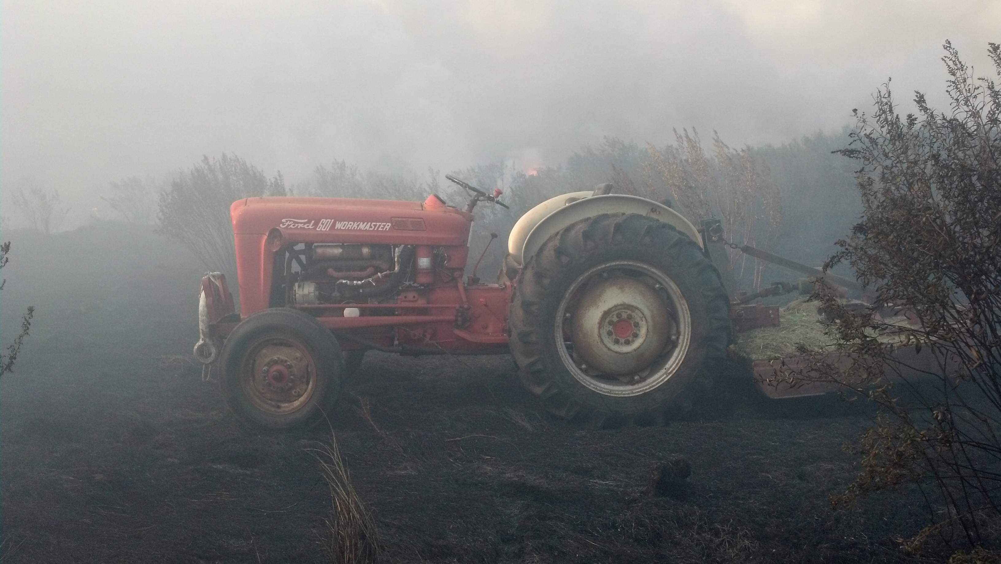

Just found the ring gear how-to on You Tube. Don't look like a problem at all. Thanks for the help. Will try and post some pictures of the old workhorse soon. She ain't purty , but she works like a sugar mill mule!

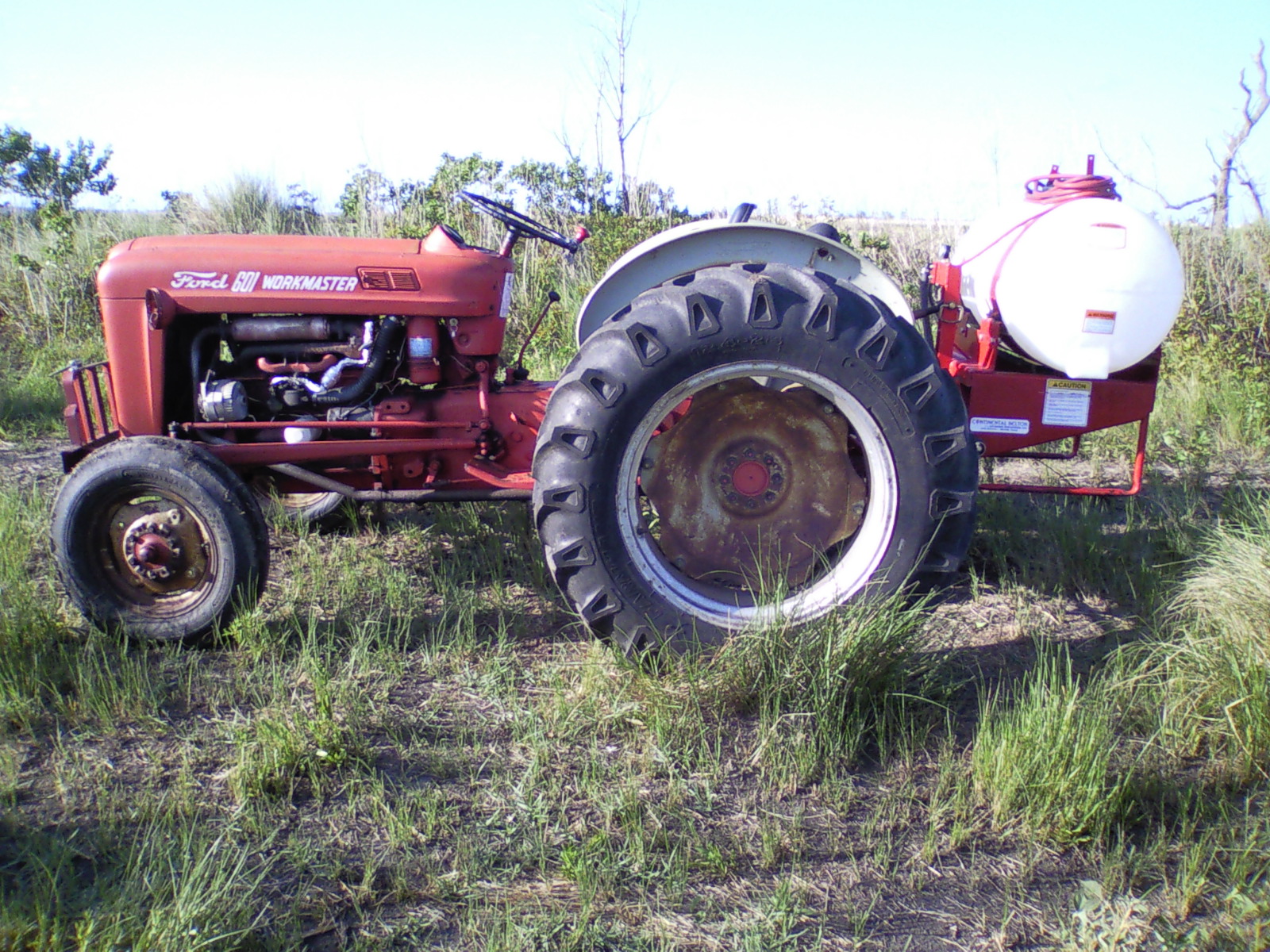

With a spray rig attached and then while I'm burning. I burn every year to promote the growth of the saltgrass which is the winter pasture for the cattle.

ahh.. 601.. lil different than a 600.. especially in clutch area...
