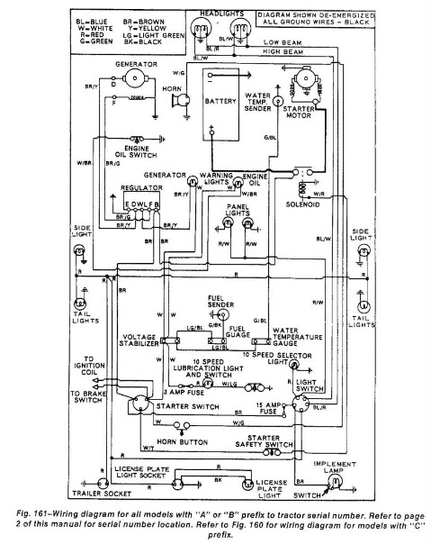

OK. I give up and need help. This all began when I decided to fix the non-working fuel /temp gauges and ammeter warning light. so I pulled off the covers and found the mess of wiring "repaired" by the last owner. Many wires were bare, some simply disconnected and it is a wonder the machine started and ran without catching fire. Please consider and comment:
The IT shop manual does not have a section on wiring or instruments

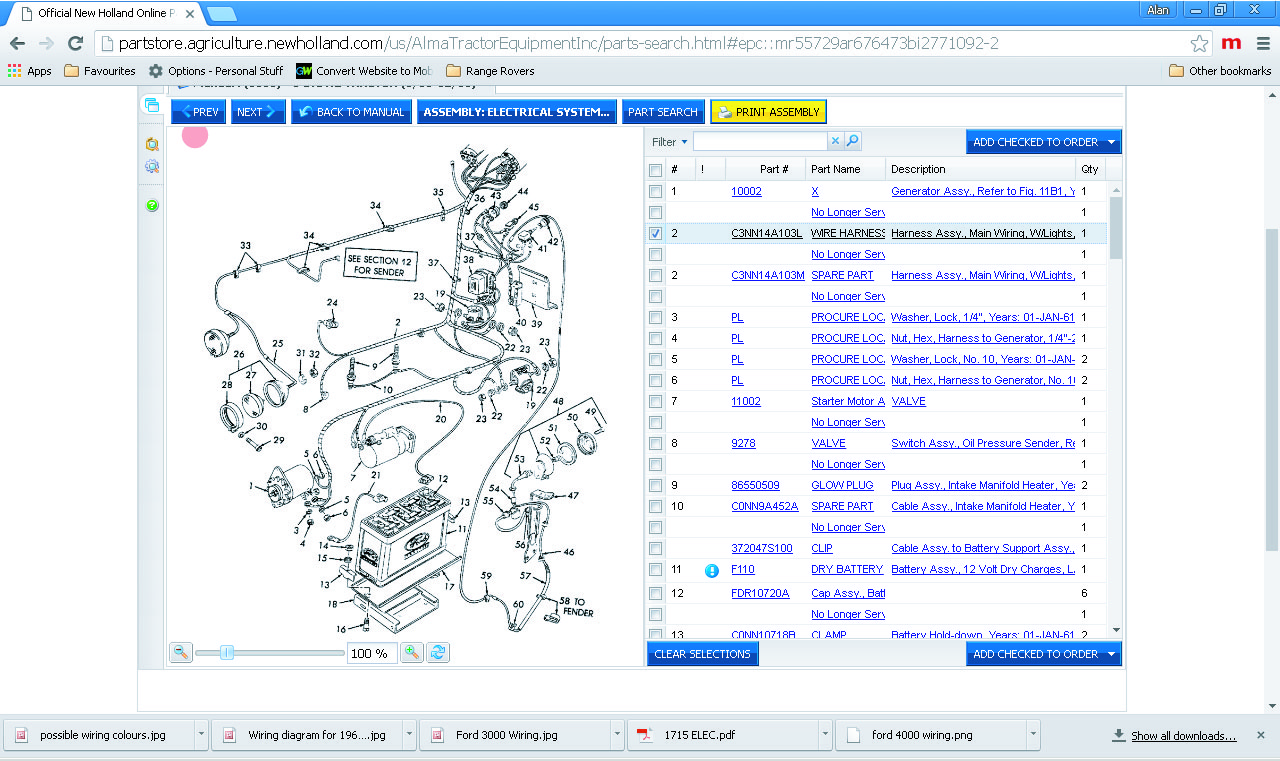

The Internet has any number of wiring diagrams and two thes are included in this post. But - neither of these has much resemblance to what it actually installed. My tractor is presumably a US model (not Euro) but the Australian distributors may have modified the wiring.
The schematic from ALMA (see picture) is as close as it gets but no wiring colors are shown so it is not very helpful in terms of rewiring
PLEASE - anyone with a correct wiring schematic for a 6000 model - please supply me with one
This is what we now have:
  • There was NO power to the instrument cluster so lots of damaged wiring has been replaced with soldered/heatshrink joins to replace the previous dodgy versions. (Yet to be reconnected to the battery until I resolve the issues listed here)
  • There are red and green wires coming from the instrument cluster but they are not connected to anything, An ohmmeter shows connectivity with the yellow/red wires at the instrument panel but the green wire has no connectivity. I should think these should go to the ignition switch but can't see any spare or missing terminal contacts. Also an orange wire is hanging out of the loom, but I cannot find anywhere this might go. Any suggestions?

A few things you should consider:
1. Get the correct wiring diagram for your tractor.
2. Stop connecting wires to the ignition switch until you complete #1. (According to the diagram, the red wire is for tail lights.)
3. Disconnect the battery.
4. Use a VOM meter or continuity light to trace each of the wires for each dash function.
Such as: Find the temp sensor and note wire color. Does the dash wire of the same color have continuity to the sensor?

Thanks but maybe you missed something - it is the "correct wiring diagram" I am trying to find. The IT shop manual does not have one and the versions on the Internet bear little or no resemblance to what is there. As stated in my first message, only the ALMA tractor schematic is correct but it does not show the actual connections or colors.
Yes, I am attempting to trace each circuit

   / Ford 6000 diesel instrument wiring - driving me mad!
Thanks guys. Actually made more progress yesterday talking to a local guy who has been in the tractor business for many decades. The Ford 6000 wiring turns out to be virtually identical to the 8000 and the IT manual DOES have wiring diagrams for that model. I also removed the "inverter" shown in the ALMA schematic that turned out not to be connected to anything. In fact, because most of the important wires had been removed or had broken there was nothing delivering power to the instrument cluster.
I have plenty of experience rewiring Land Rovers and now I have a diagram, I can rewire the senders to the gauges, key switch and voltage regulator without blowing the system. The wire colors will not be original but who cares if it works! A working fuel gauge might prevent having to bleed a 6 cylinder diesel parked in the bush with snow or rain pouring down my neck.

Just for advice to others who may have a 6000, here is the diagram that matches reality, The only difference is that the 6000 has a generator, not an alternator, but the wiring is identical
