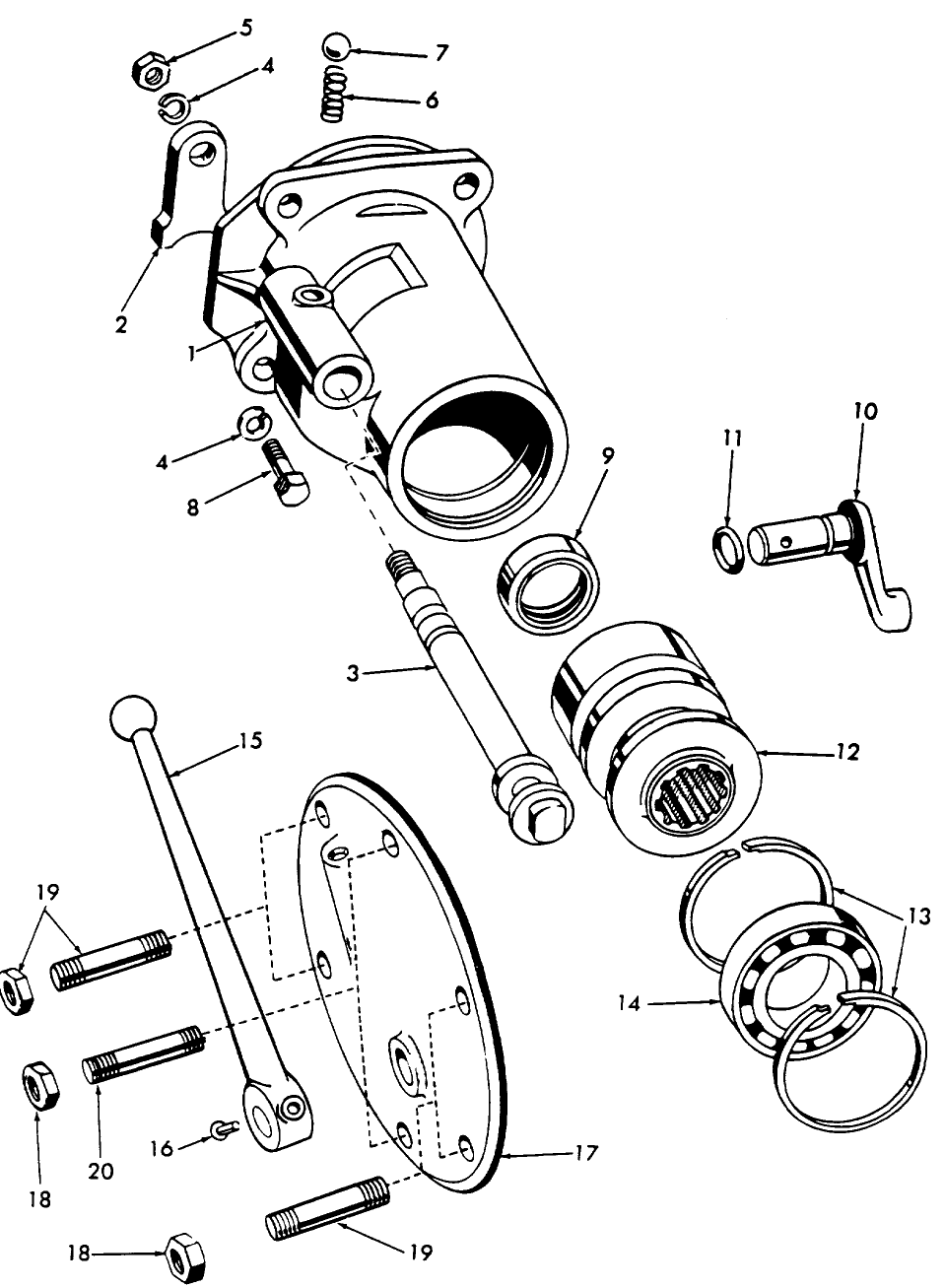

if the pto shaft looks true, next look at the sliding dog clutch.. part #12 in the diagram I'm attaching.
here's the parts listing to go with the diagram.
ps.. you can remove that or peer in to inspect it pretty easilly.
good luck.. hope it helps

1 1 NAA770A Support, PTO, NAA, NAB, No Longer Serviced, Years: 01/01/1953-12/31/1954
1 1 NCA770A SUPPORT Support, PTO W/4-Speed Transmission, No Longer Serviced, Start Year: 01/01/1955
1 1 NDA770B Support, PTO W/5-Speed Transmission, All Purpose & 900 Row Crop, No Longer Serviced, Years: 01/01/1955-12/31/1959
2 AR NAA722A STOP Stop, PTO Shifter
3 1 9N719 Rail, PTO Shifter, No Longer Serviced, Years: 01/01/1953-12/31/1954
3 1 NCA719A SIDE RAIL Rail, PTO Shifter, Except NAA, Start Year: 01/01/1955
4 AR PL PROCURE LOCALLY Washer, Lock, 3/8"
5 1 PL PROCURE LOCALLY NUT,3/8-24, Hex, Start Year: 01/01/1953
6 1 797234 SPRING SPRING, PTO Shifter, Rail Mesh, NAA, Years: 01/01/1953-12/31/1954
6 1 83407013 SPRING SPRING, PTO Shifter, Rail Mesh, Except NAA, Start Year: 01/01/1955
7 1 145222 BALL BALL, 3/8", Steel, Start Year: 01/01/1953
8 1 PL PROCURE LOCALLY BOLT, 3/8-16 x 1 1/4", Start Year: 01/01/1953
9 1 233274 SEAL Seal Assy., Transmission Countershaft, Start Year: 01/01/1953
10 1 NLS No Longer Serviced Fork, PTO Shifter {NAA720A}, Years: 01/01/1953-12/31/1954
10 1 NCA720A FORK Fork, PTO Shifter, No Longer Serviced, Start Year: 01/01/1955
11 1 128999 O-RING O-Ring, -111, 70 Duro, .424" ID x .103" Thk, Shifter Fork, W/NAA720A, Years: 01/01/1953-12/31/1954
11 1 14457281 O-RING O-Ring, -114, Cl 7, .612" ID x .103" Thk, Shifter Fork, W/NCA720A, Start Year: 01/01/1955
12 1 NAA717A SLEEVE Sleeve, PTO Clutch, 2.16" Overall Length, No Longer Serviced, Years: 01/01/1953-12/31/1954
12 1 NCA717A SLEEVE Sleeve, PTO Clutch, Except NAA, 2.16" Overall Length, Start Year: 01/01/1955
13 2 9N754 RING Ring, PTO Bearing Snap, Years: 01/01/1953-12/31/1954
14 1 210064 BALL BEARING BEARING, BALL, Assy, PTO Shifter & Shaft, Optional W/B & C, NAA, NAB, Replaces 9N715B, Years: 01/01/1953-12/31/1954
15 1 9N723 LEVER Lever, PTO Shifter, Except Offset, No Longer Serviced, Start Year: 01/01/1953
15 1 312844 LEVER Lever, PTO Shifter, Offset Only, No Longer Serviced, Start Year: 01/01/1959
16 1 60518S RIVET Rivet, Button Hd, 1/4" x 1-1/4", Start Year: 01/01/1953
17 1 NAA721D Plate, PTO Shifter, NAA, Replaces P/N NAA721C, No Longer Serviced, Years: 01/01/1953-12/31/1954
17 1 NCA721B Plate, PTO Shifter, Except NAA, No Longer Serviced, Start Year: 01/01/1955
18 AR PL PROCURE LOCALLY Nut, Hex, 7/16"-20
19 2 PL PROCURE LOCALLY Stud, 7/16"-14-20 x 1.68, NAA, Start Year: 01/01/1953
2 PL PROCURE LOCALLY Stud, 7/16"-14-20 x 1.68, Except NAA, Start Year: 01/01/1955
20 2 PL PROCURE LOCALLY Stud, 7/16"-14-20 x 1.3/8", NAA, Years: 01/01/1953-12/31/1954
4 PL PROCURE LOCALLY Stud, 7/16"-14-20 x 1.25, Except NAA, Start Year: 01/01/1955
1 PL PROCURE LOCALLY Pin, 5/8" x 1/2", L/PTO All Purpose Heavy Duty Industrial, Start Year: 01/01/1955
1 353081S BALL BALL, 5/16", Steel Offset Only, Start Year: 01/01/1959
1 NDA784A RETAINER Retainer, PTO Countershaft W/5-Speed Transmission, All Purpose & 900 Row Crop, No Longer Serviced, Years: 01/01/1955-12/31/1959
1 C0NN4022A Vent Assy., Air, PTO Shifter Plate, L/PTO, All Purpose & Heavy Duty, No Longer Serviced, Start Year: 01/01/1955
1 9N4131 GASKET Gasket, Shifter Plate Cover to Housing, Start Year: 01/01/1953
1 86613266 CUP Cup, Transmission Countershaft Rear, Bearing W/5-Speed Transmission, Years: 01/01/1955-12/31/1959

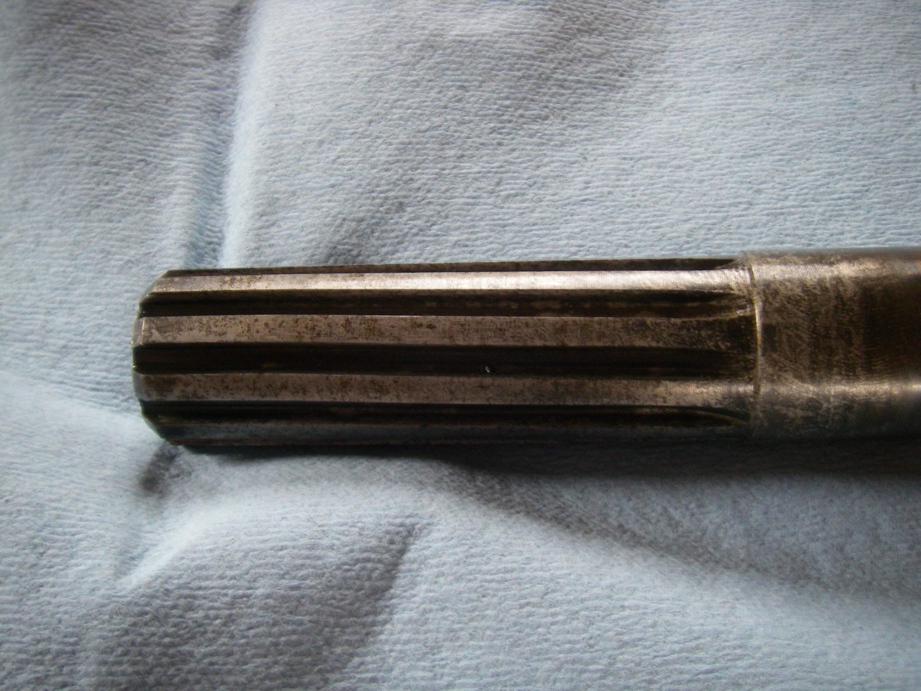

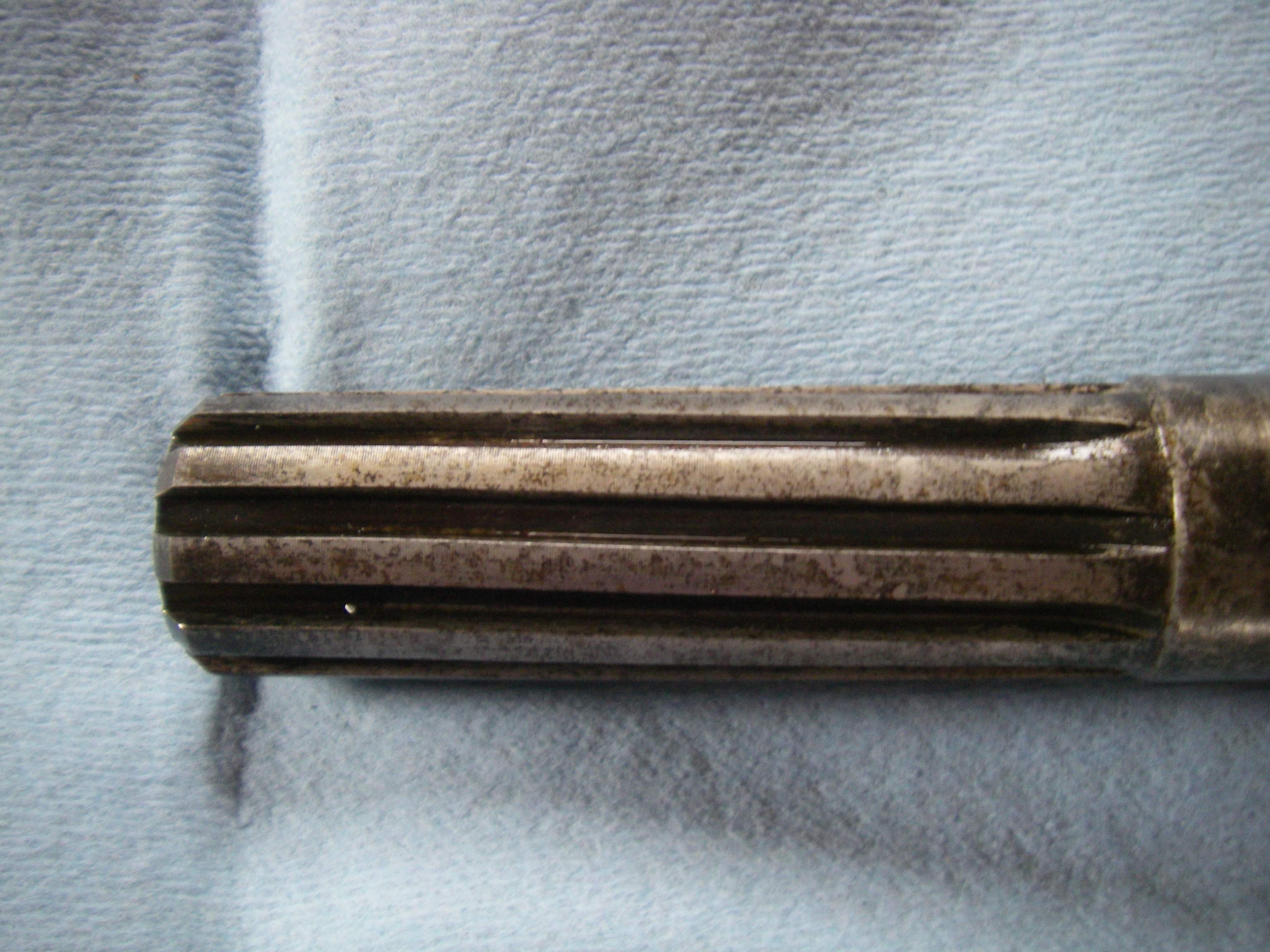

It does seem that the PTO shaft does have a slight twist in it now that I have had a chance to examine it in better light attached, are the pictures. Is it possible that even this little of a twist can cause the problems I am having? You have to look at it from just the right angle to see the twist.

yep.. it's slight. here's the issue.. from the beginning of the twist to the end of the twist. if there is more distance that the splines have moved in reference to a parallel line that they should be on.. if that difference is more than the tolerance fit between the sliding coupler .. then it will cause a problem
you could dye and slide together and see where it removes the dye.. or try to hand fit and tap it in and ovserve.
I might try to file the pto shaft a hair to true it up. it's a 100$ gamble at most.. and your twist is VERY slight.
file a lil then check.
and yes.. 2 rings and a support bearing back there..
feel in there first to see if the leading edge of the internal splines are damaged.. might use a strong lamp from the rear.. or snake light / mirror..

UPDATE: I had a little time to work on the PTO problem today and here are my observations. Filed a little on the shaft hoping it would help, but didn't. I put the shaft back in and the lever moves back and forth about 2-3 inches but will not completely disengage. Which is the opposite of my original problem, I couldn't get it to go in gear before.The PTO is spinning all the time and can't be disengaged. I took it back apart and with the 4 bolts removed that hold the PTO shaft in place I moved the PTO lever back and forth and when the lever is almost to the fully disengaged position it pushed the shaft out the back of the tractor about 3/4". I then removed the shaft completely and put some grease in the splines so I could tell how far onto it the gear was going, about 1". My unprofessional opinion is that due to the slight twist in the PTO shaft it is preventing the gear from moving back and forth freely on the PTO shaft to completely engage and disengage the PTO. I will have a new PTO shaft one day next week to try. Does this make sense to anyone?

yep. theat twist, even though it is slight, is eating up all the clearance that the sliding coupler has from side to side of the splines.. it's exactly what I expected.
more filing would likely yeild a working piee, albiet one without a good full fit.. an ok temp farm fix.. but you are doing it right if replacing the shaft.
