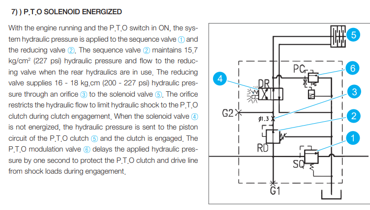

My tractor has an HST trans so no clutch. I did look in the service manual and found this.
Wonder if there is an issue with the orifice (3) that is supposed to "limit hydraulic shock"?
/ PTO engagement with bush hog rough #6
Item 6 is the valve that is supposed to provide the delayed soft start of the PTO. In looking at the schematic it is not drawn as an adjustable valve. Not sure if the orifice can be tweaked in valve 6 since that would affect engagement speed. Spring rate on valve 6 may also affect engagement speed.
The sequence valve is in the system to supply a continuous pressure to the reducing valve and should not be adjusted below the recommended setting pressure.
The 1.3 mm orifice can affect engagement speed in conjunction with valve 6.

My tractor has an HST trans so no clutch. I did look in the service manual and found this.View attachment 3618490
Yes, it does have a PTO wet clutch. Number 5 in that schematic you shared.
