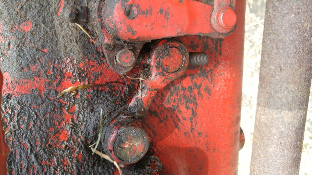

When the clutch gets resistance, before but close to runningboard, there is no turning of the clutch shaft. The short rod from clutch shaft to clutch adjustment bolt just flexes a little bit.
This happened, as far as i know, after tractor sat awhile.
If the clutch is stuck to flywheel, i would think the clutch shaft would still turn some as it tries to disengage the clutch.

Not exactly clear to me how the clutch works, is it the clutch shaft turning pushes the clutch bearing against the fingers, which pulls the clutch plate away from the flywheel?

pin isn't broke is it?

20170325_121014_OH_farm_.jpg I assume pin from this arm to the clutch shaft, the way i see the arm to the clutch shaft flex when the clutch hits resistance at the bottom, i think the shaft is trying to turn, but cant.

Explain flex, that small arm should have no flex.

Right end moves a little, don't see any movement on left end tapatalk_1511828185339.jpeg
