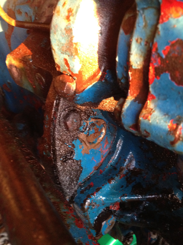

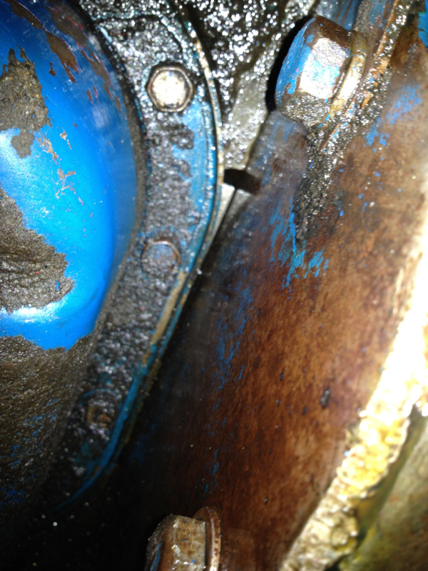

I can't seem to find it. I also think I have a bit of motor oil coming out of the back of the starter.... Below are the 2 places where I see motor oil leaking. Is the rear main seal quite a job?
   / Ford 640 oil & hydraulic leaks #13
you must be under the tractor looking up, looking rear of the oil pan, to the 'dry area' of the trans bellhousing, so look BETWEEN the trans drain plug and the aft of the engine oil pan. there you should find the bellhousing drain.
if you are getting oil out the teardrop cover and the starter mounting point, the bellhousing is very full!!!! and you need to correct that post haste befor ethe clutch is ruined.. though it may already be!!!!
rear main? it's well.. work.
can drop the pan and whatnot after cussing the front bolts... sneaky pete might get it done for ya.. etc...
but you gotta get that bellhousing drain open before you do ANYTHING else... and make sure that you have not overfilled the trans. will only make the input shaft seal leak MORE.. there is a level plug on the right side aft of the trans....
